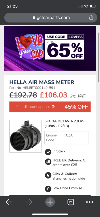

Anyone got a spare known good MAF before I spunk £100 on one?
Anyone tried this hella MAF?

 I replaced the MAF yesterday with the hella part from GSF.
Car has started perfectly since, and is noticeably more responsive.
