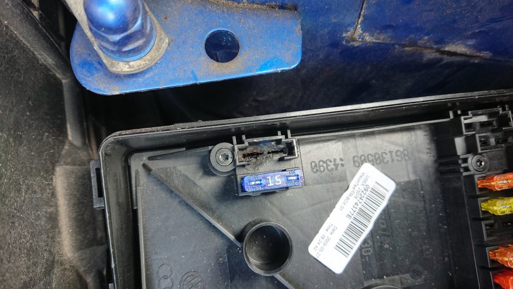

Anyone else had this fuse melt but not blow? Might need an engine bay fuse box for an FL 2.0 VRS.
Cheers, its an 09 2.0 VRS FL. I think that as the fuse was oxidised thats where the issue was? Maybe I was just unlucky and will never have a problem again.
I've had a further read and couldn't find anything concrete on here. Just that a guy replaced his fuse every year or so for the same issue. I've put a new fuse in and then pulled it, it has 4 nice scratches, 2 on each leg of the blade, showing there is good contact. The existing fuse was oxidised also. Will just replace the fuse, and keep the spare 30a in the glove box, that's the most sensible and cost effective thing to do right now.
No, I bought it a few months ago just before winter hit, couldn't face another winter on a motorbike in a pandemic. Your thinking is logical, but this fuse only seems to affect the front right light cluster (that's the cluster that has intermittently been cutting out). Putting a large fuse in there would have been idiotic, I don't know the history of the car, but it was owned by some reasonably smart people from what I understood. No evidence of water ingress on the fuse or fuse box. However can't rule it out either given the state of that fuse. I did a little reading. If a fuse has a poor connection (pins not tight enough, oxidisation etc) it creates a lot of resistance. The resistance creates heat. This is all happening while the amps are not high enough to blow the fuse. These are the conditions under which fuses melt but don't blow. I've bought a new fuse, I'll try and tighten the socket it locates into, but don't hold much hope given the sight of it. If I get any more issues I'll be looking for a fuse box from a breaker and expect that to be the end of it.
Had intermittent issues with front l Right light cluster, and then found this!! Anyone else experienced this? I found previous threads with issues with this fuse, but mine melted and didn't blow. Anyone got a spare fuse box? Cheers Conrad
