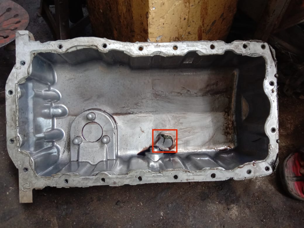

  2. Finally the issue resolved. The sump was replaced with a new one and the reason why dipstick was dry is because it was pushed upside as the puncture was right below the dipstick area. Broken parts of the sump prevented dipstick to go down to its full depth. For reference I am attaching a pic of punctured sump. Once the sump was replaced and oil was filled, dipstick showed the reading as it was supposed to.

  4. I encountered a problem with my Octy(Skoda Octavia Mk1 2004 1.9TDI) when my sump was damaged due to bad road conditions. I stopped for a while and then continued for a mile to reach my residence. On the way oil pressure lamp lit (Red Oil Sign). After arriving at my destination I patched the whole in the sump temporarily with a Car patch and then filled engine oil after letting it cool down for a while. My query is even though I poured around 4 litres of oil, the dipstick is still dry as it can be. The engine is still running with a little bit noise than it usually does. When trying to analyse the issue, the oil pressure sign again lit. I checked for the leakage but couldn't find any. Checked Coolant reservoir tank for oil and couldn't find any presence of oil. Please elaborate whats going on if you know what are the probable causes. What kind of a damage I am looking at when driving the car for a mile after the engine oil pressure lamp lit?

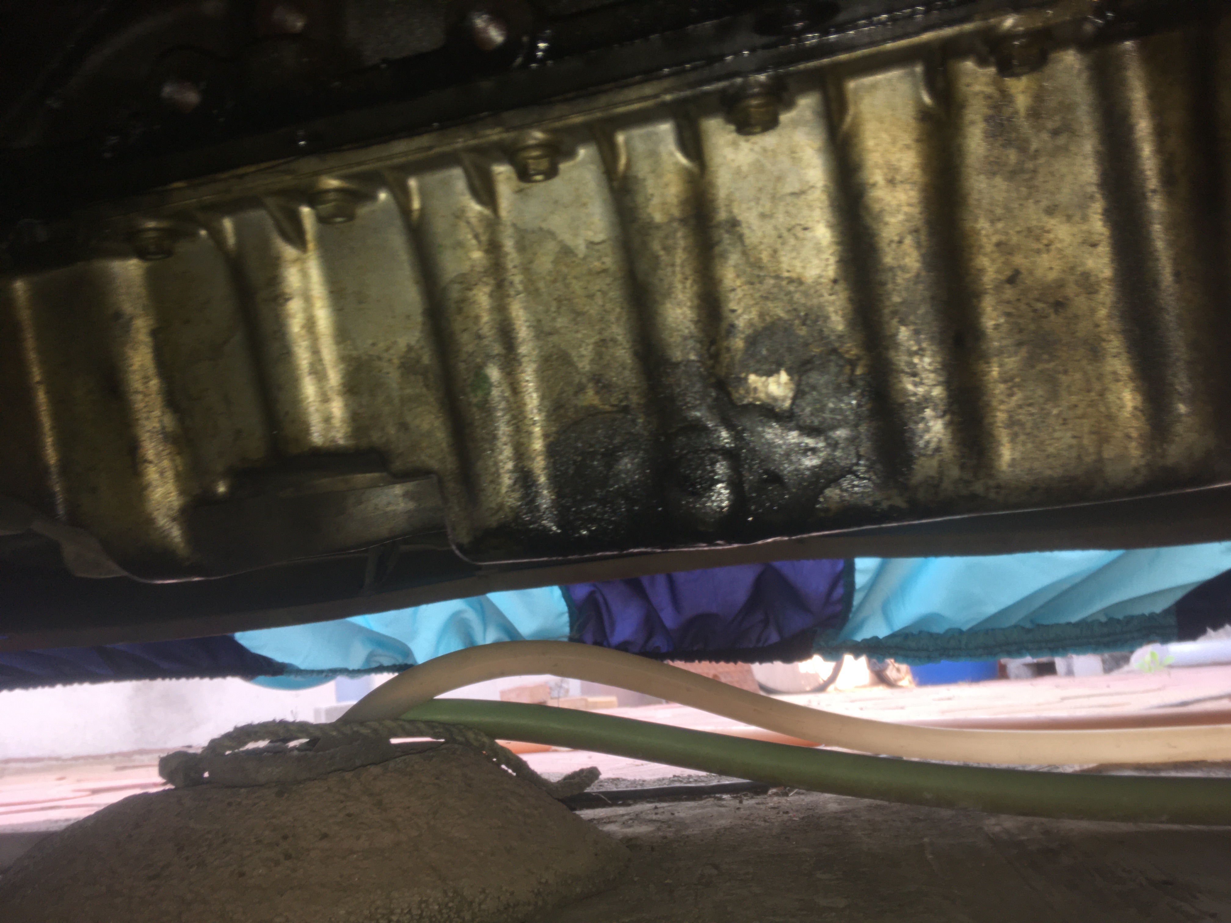

  8. I noticed sealant covered all over the drain nut. What are the possible causes and remedies for this situation? It looks like the thread for drain nut has been damaged due to over-tightning (by the previous owner) but still an insight from you guys will be helpful.

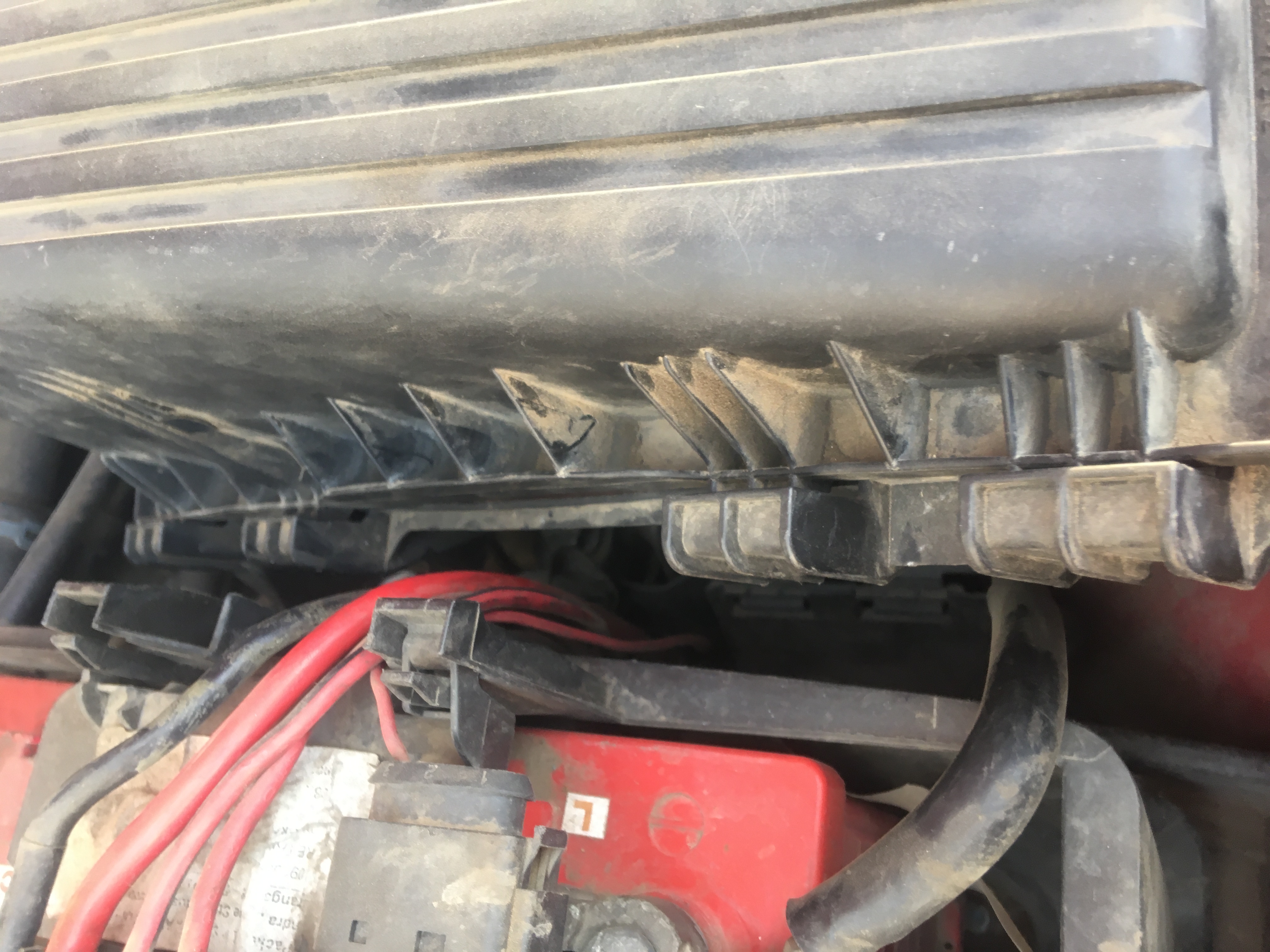

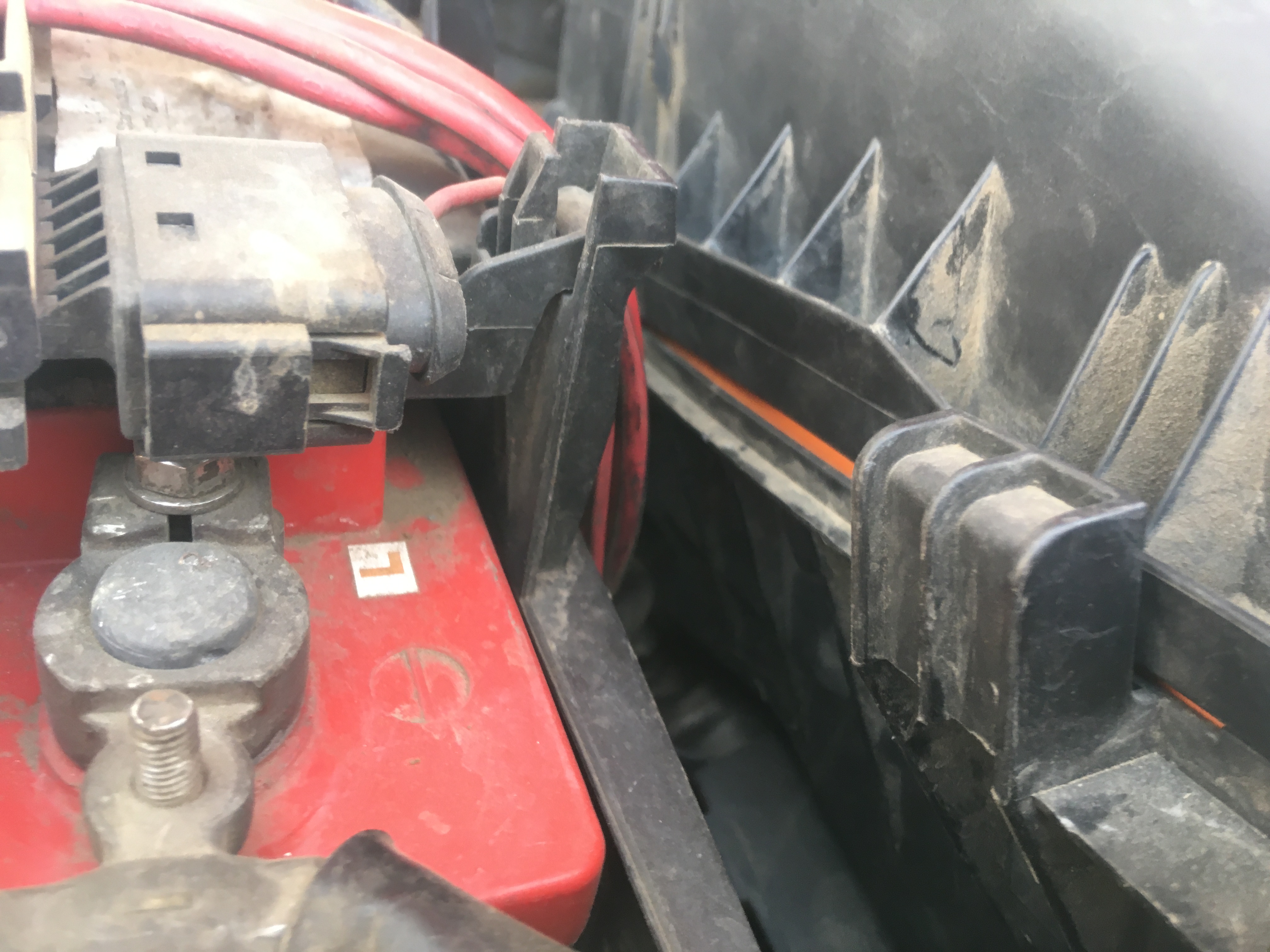

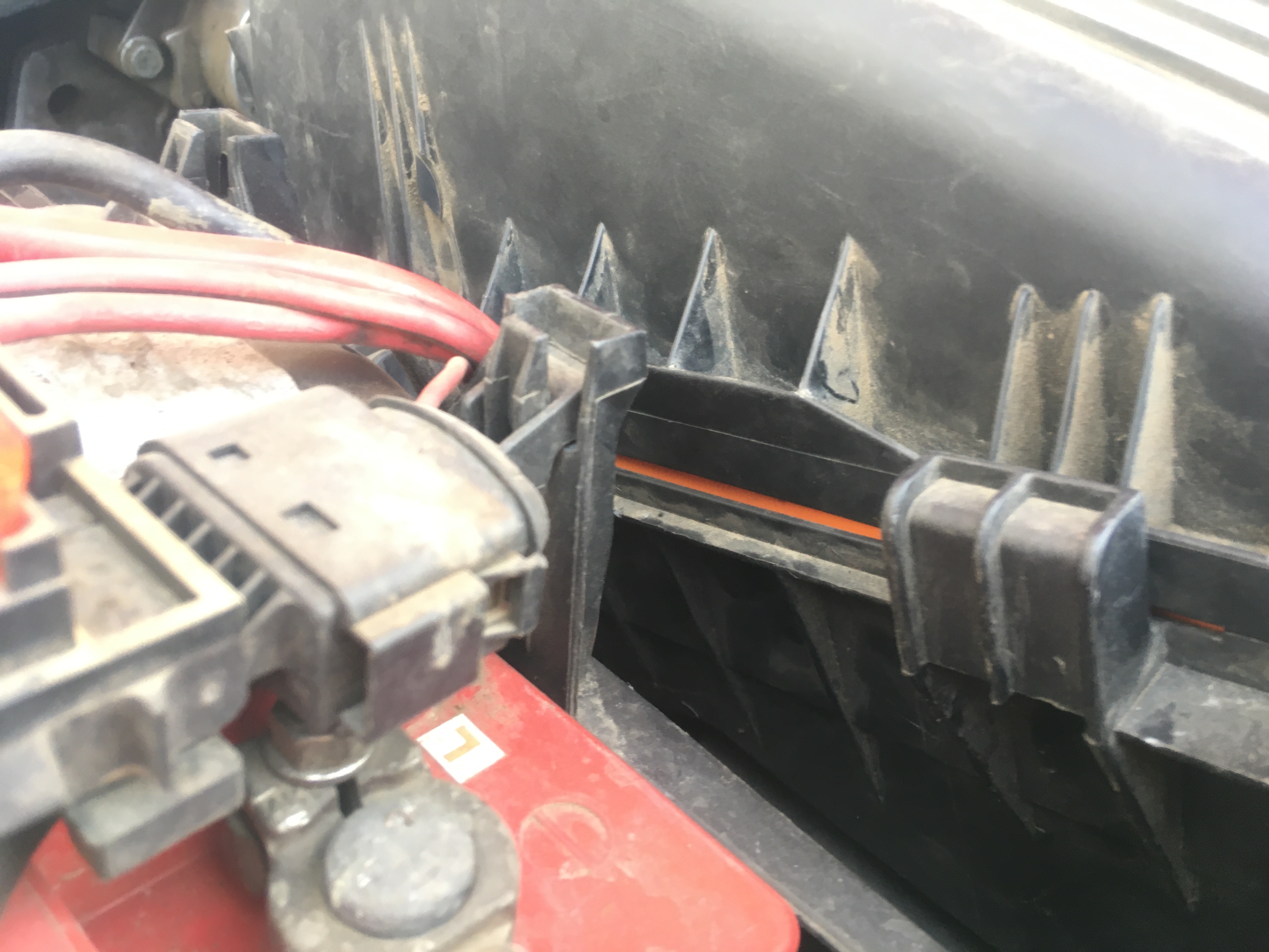

  9. Here are the pics. I don't know the reason why I can see the orange rubber even if the box is completely tightened.
  10. I recently changed my air filter and found that the box does not completely close and I can see a thin line of Orange Seal of air filter even after the housing is completely tightened. Is this an issue or is the housing suppose to completely close?
