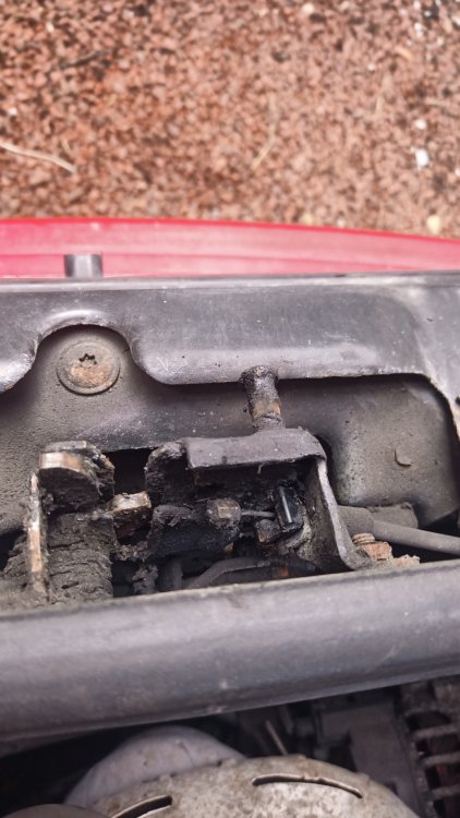

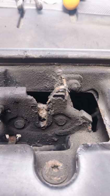

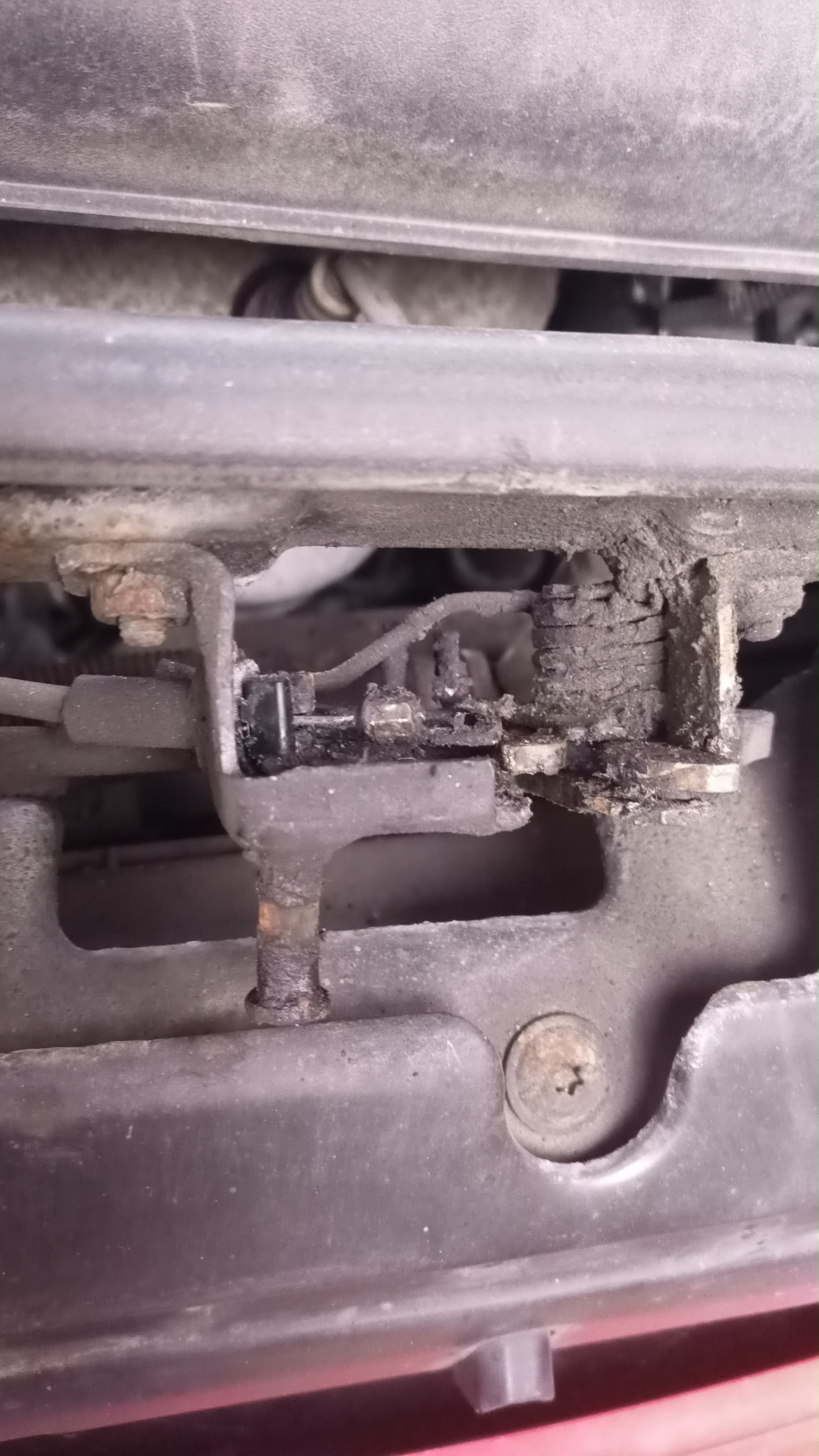

Bonnet will not lock shut, but the secondary catch (pull out lever from the grill) does work.
I'm thinking somthing has actually fallen off, perhaps a spring?, Or the lug on the wire should be engaging somewhere it isn't at the moment and I haven't spotted, or at a push the cable has stretched?
Handle in footwell moves forward and backwards but with no tension.
Seeing the lug on the cable in the bonnets lock mechanism I've pushed it back and forward, it moves fairly freely and pulling it will return the lever in the footwell, so I think the cable isn't broken and is ingaged in its housing in the footwell.
Hopfully somthing will be obvious to a trained eye from the attached photos.
It had been a bit temperamental about locking over a few months, but only gave up over the weekend.
Any help, advice, or even picture of what it should look like if it shouldn't look like that would be great!

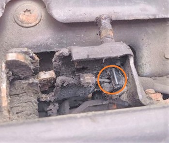

I can see that your catch mechanism is stuck and needs freeing off, and/or the return spring may be broken (unlikely but you never know).
On yours, the black bit in the orange circle is stuck back from the cable end...

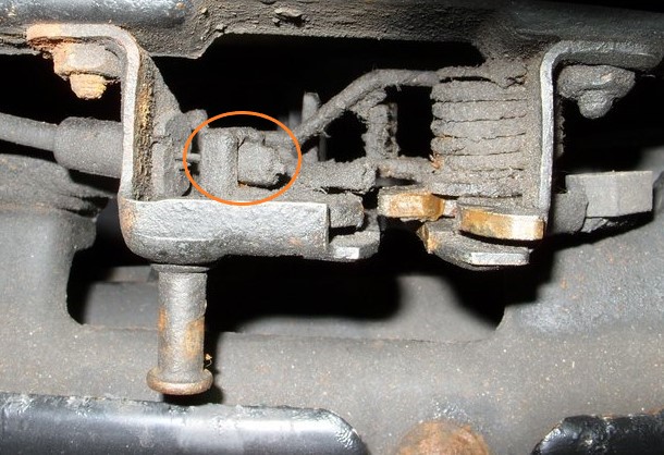

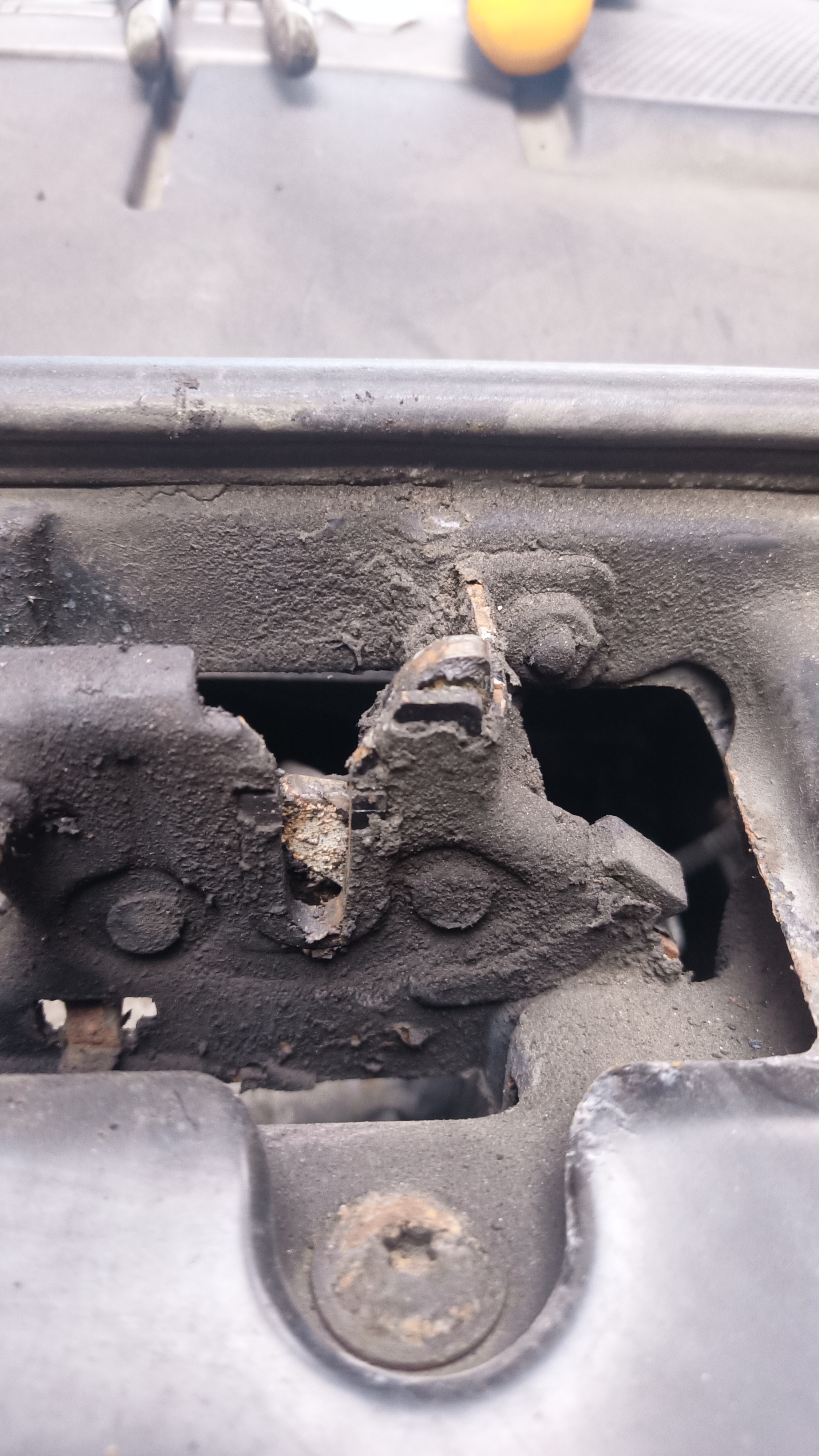

A pic of mine showing cable end in contact...

TMB thank you very, very much!
Easy when you know what should be doing what.
I'd presumed I should be seeing a coil spring around the cable between the "lug"(?) And what appeared like a fixed back plate, or perhaps that there might be a spring elsewhere. Completely hadn't spotted that one lower down.

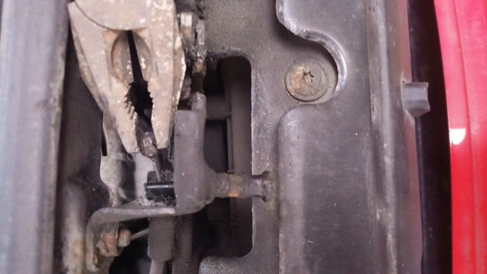

Now seeing that the black bit is ment to move, it's been worked too and fro with a screwdriver, and the spring eventually started to do some of its job, loads of crud scraped off, and from between the two plates, a good dose of WD40 and we are back in action! So gonna guess it was option 2 "pivot sized"... Or at least gunked up to hell. Will give it a better clean and re-grease tomorrow (cheers Paul!).
