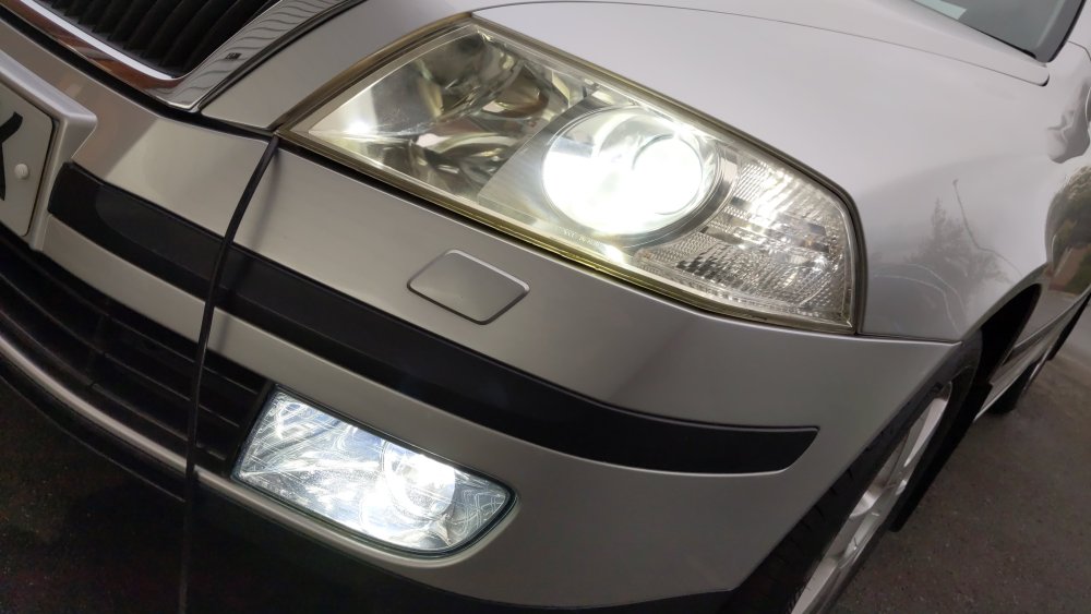

  3. After testing a lot of LED Bulbs I've finally done the full LED upgrade with no Canbus Errors! The fog lights I've used are the Auxito M3 H8 LED Lights. They are pretty bright and I don't have that drive battery voltage code which is great so no loud cooling fan anymore lol Paid £36 for them but I think they are well worth it and I highly recommend them if you're looking at getting fog lights for Mk2 Octavia. My cars battery is on trickle charge if you're wondering... Ebay Link that I bought from - https://www.ebay.co.uk/itm/185585719053

  14. Hi everyone A couple of months ago I decided to do a full LED Upgrade to my 2006 Skoda Octavia mk2 Elegance. I replaced the main beam with Auxito Y13 High Beams were replaced with Auxito M3 Fog Lights replaced with Auxito Q16 Front & rear Indicators were replaced with ARGO LED P21w Reverse Lights replaced with Chinese LED Bulbs And brake lights were replaced with another off brand Chinese Bulb All lights work perfectly with no issues however for some odd reason, when I have my main and fog lights on and I turn on my indicator, after 4 flashes I get an error and it seems to get triggered when I have my steering wheel turned to the direction I am indicating to. But this is the weird part because the issue only seems to happen while the car is moving and not stationary. I then get an error code on my turn signal bulbs I used (which are Argo LEDs) and with that another error code 01598 Drive Battery Voltage comes up. My cooling fan then goes on full blast for no reason either though my cars engine is cold and not up to temperature, and it's diesel too... I have used Carista to turn off the cold bulb checking sequence which means I get no bulb errors up until I physically turn on the bulbs. The LED indicator bulbs work perfectly without the fog light on so when I indicate, I have to turn off fog lights, then indicate as a workaround. I would love to turn off the warm diagnostics on the bulb checking as I think that is partly the issue for my problem. Can somebody tell me if that is possible using VCP? (Vag Can Pro) So I am only thinking this could be due to the load put on the electrics when the car is moving? Please share some light on this lol
