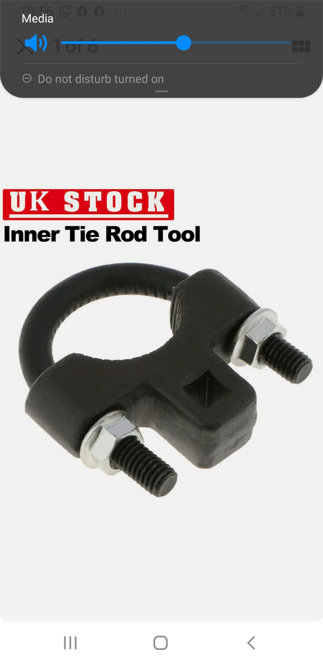

  9. Thanks for the help Sepulchrave that has put my mind at ease i applied blue thread lock and tightened the inner rod as tight as a could with a extension and socket wrench and a removal tool that looks like a beefed up exhaust D clamp i got off ebay ...not overly tight didnt want to put too much twisting motion on the rack its self
