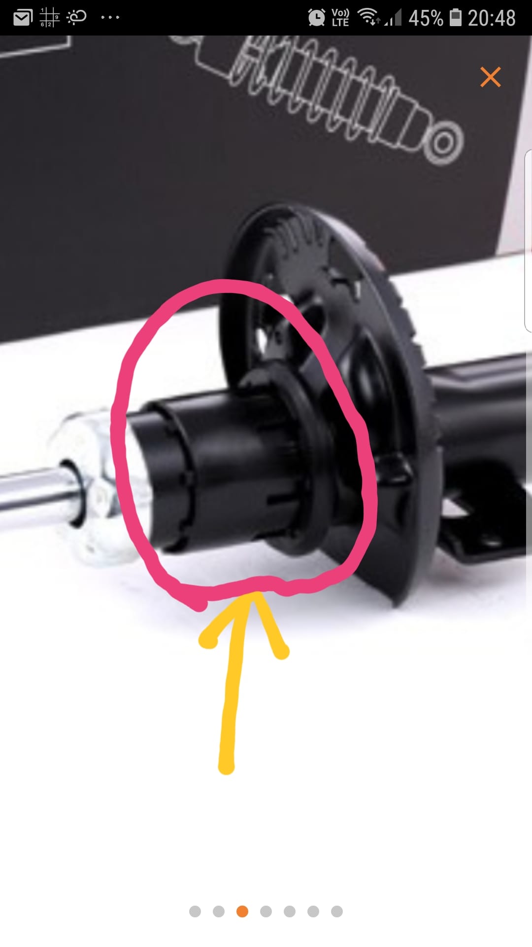

  1. They do slide up with a little careful persuasion to be refitted.
  2. I know the metal cap has to be chapped up to remove it mate but that's part of changing strut and fitting things back to stock. I'm amazed that it's not a stock item as car would have came supplied with them fitted. I will endeavour to find a supplier and get back to the forum. Cheers anyway.
  3. I'm miffed then as my other fabs have them and so does the fab I'm currently working on. I have one on one side and who ever has replaced shock in the past has failed to transfer the retainer over.
  4. Thanks bud but the part isn't listed in their diagrams.
  5. Hi does anyone happen to have access to part numbers? I'm looking to replace plastic retainer at bottom of front shock that prevents the dust boot riding up. The collar has to be removed to fit it. Any help would be appreciated thanks.
