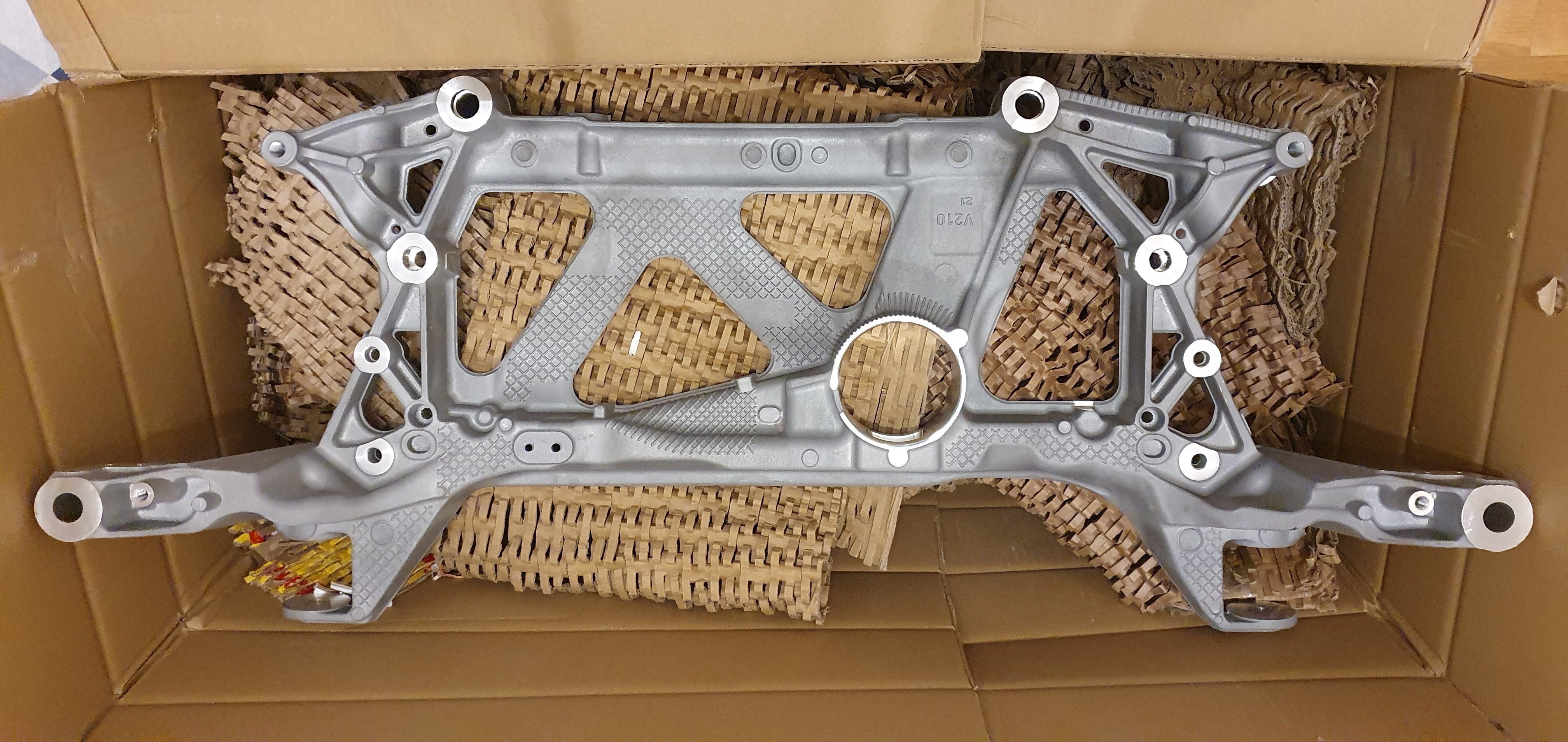

  3. Well, I hadn't heard anything about the subframe noises. It's very unusual since it's a single piece. The only thing I can think of is that the torque values weren't met, even with new bolts (the subframe bolts are all single-use bolts), or that those who bought the subframe secondhand didn't have it in good condition (a dent, a crack, etc.).

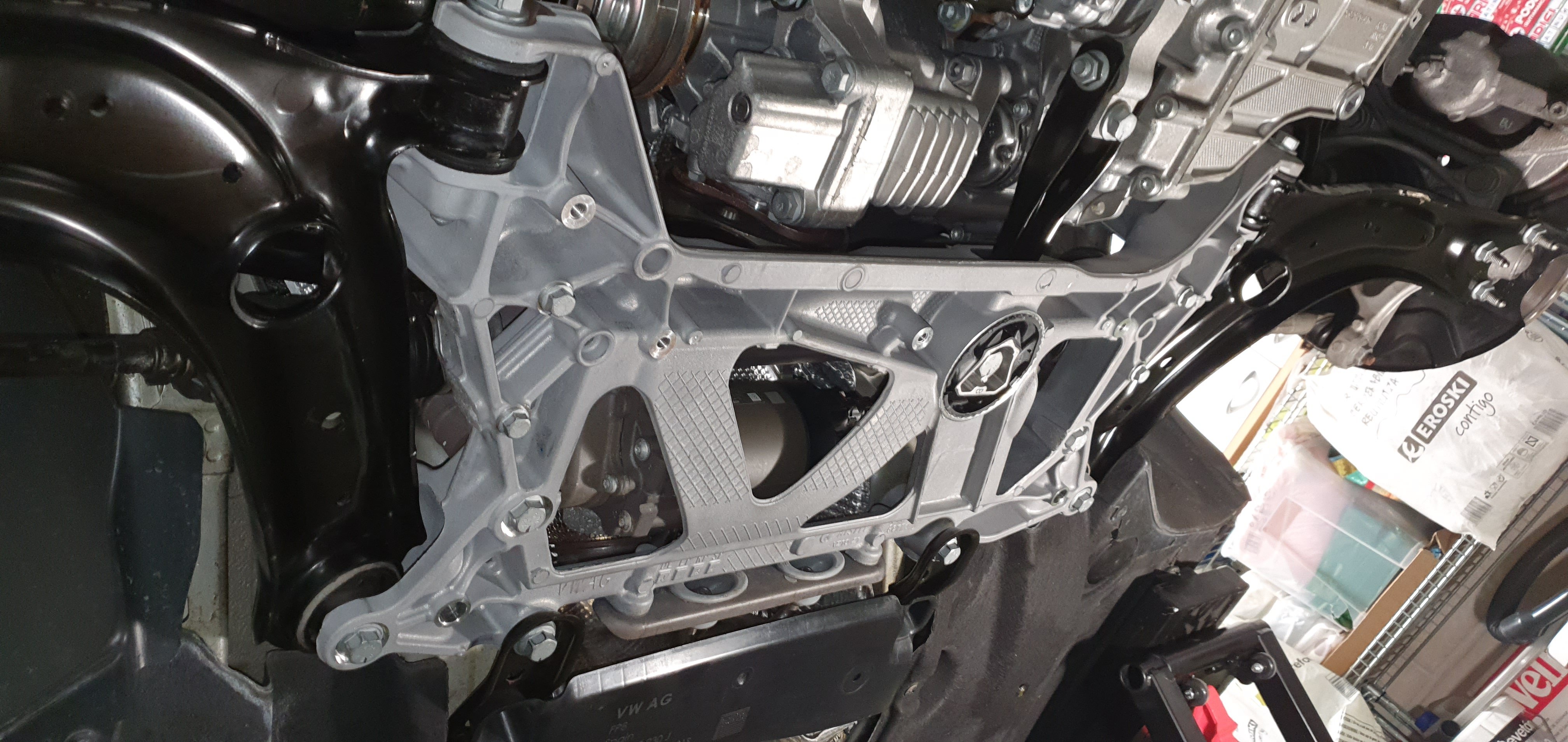

  7. Depending on whether the subframe is second-hand or new, you will need the dogbone silentblock.
  8. I can't tell you if it affects the handling in any way (I assume it won't be noticeable), because I did it at the same time as installing Bilstein B16s, and of course, I'd say 99.9% of the change is due to the B16s. The reason for the change was (aside from the irrational part, because I loved the way this aluminum part was made) better access to the DSG filter and, above all, to be able to properly clean all the oil that spills when changing it, because with the metal subframe, it wasn't easy to access. After changing the oil and DSG filter, I noticed some stains that I wasn't sure if they were due to poor placement or debris that had been left on the top of the subframe. In the end, they were debris. Regards
  9. Yes, it's possible. I did it on mine (MK3 280 hp 2021 DNFE). I bought a new subframe, I don't remember if it was from a Passat or Arteon (Ref. 3Q0199369E), and it fits perfectly. I don't know if the one from the Golf is suitable. It's a time-consuming operation, but it's relatively simple. You just have to be careful to replace all single-use bolts and respect the tightening torques. If you're going to do it, I recommend installing subframe centering devices, such as those from Racingline or 034, to ensure proper alignment of the subframe. These photos are of mine as recently installed. Regards
