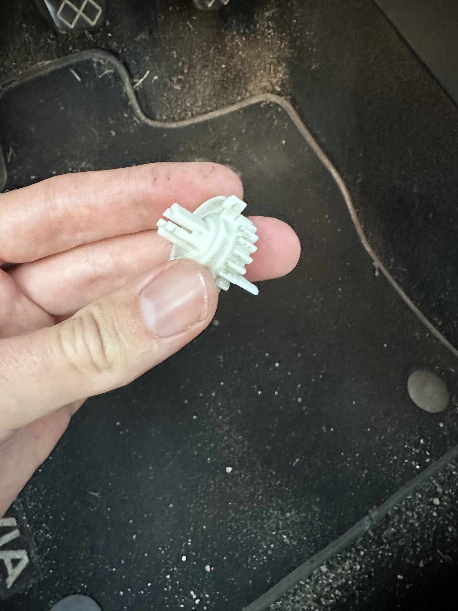

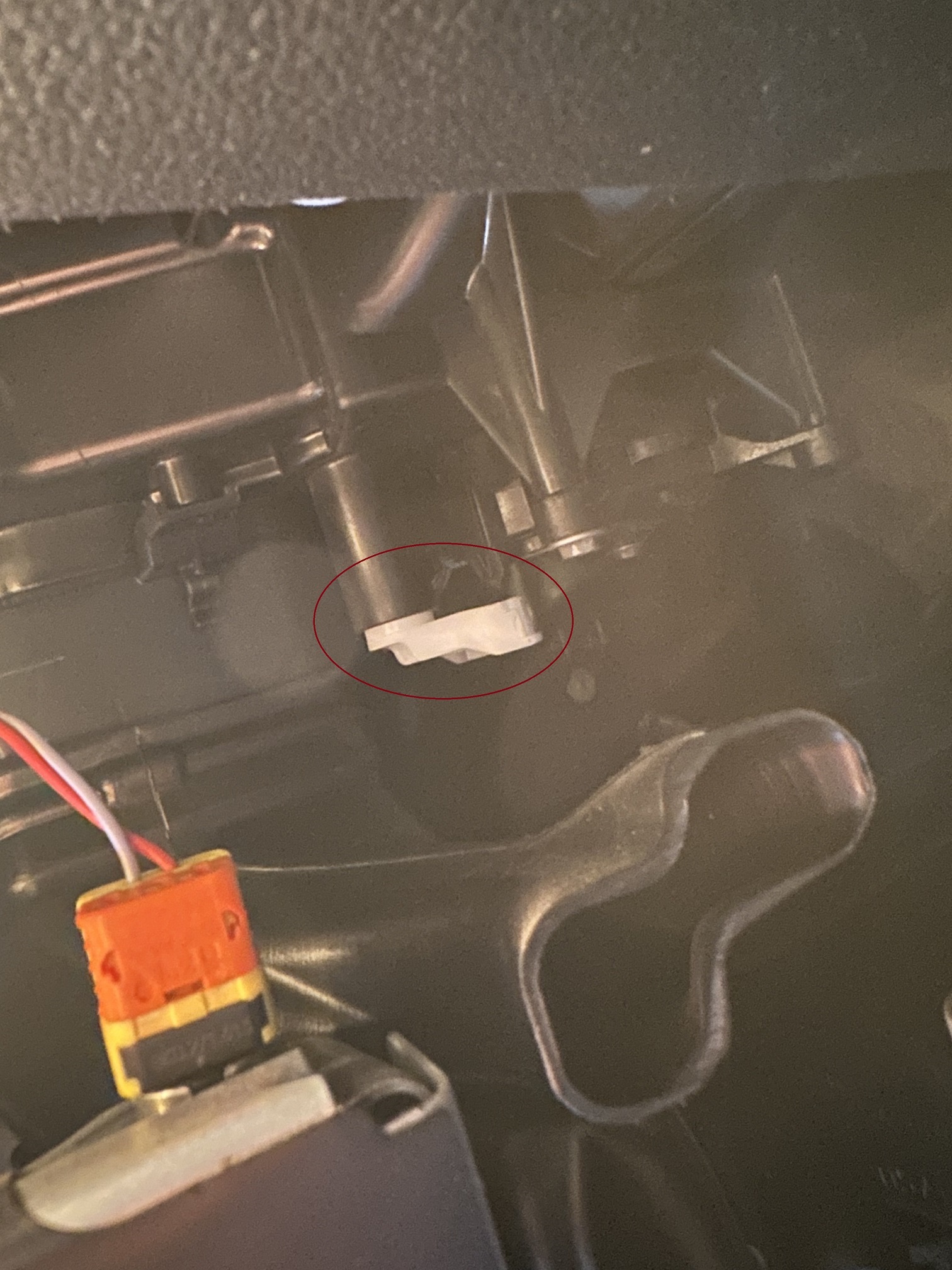

My car just dropped a piece I dont know what it does
I got it popped back in and everything seems to be working :)
Seems correct, today I had AC on hot air came out of the 2 leftmost ventilators, the one on the left of the steering wheel and the one on the left in the middle section
How would I confirm that?
I could hear a "tick pause tick pause tick" and then this little white piece fell out near my pedals, I then tried to crawl in and look up and I think it should be where I put the red circle. But I dont know what that gear turned. Anyone have a clue? Also I dont think I am agile enough to put it back in, it was pretty hard just to get down there and look up
