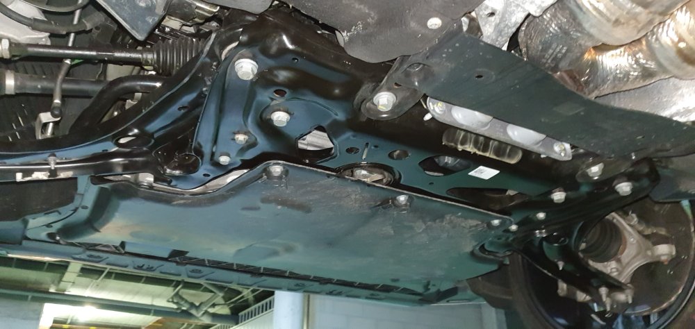

  8. Yes, it's possible. I did it on mine (MK3 280 hp 2021 DNFE). I bought a new subframe, I don't remember if it was from a Passat or Arteon (Ref. 3Q0199369E), and it fits perfectly. I don't know if the one from the Golf is suitable. It's a time-consuming operation, but it's relatively simple. You just have to be careful to replace all single-use bolts and respect the tightening torques. If you're going to do it, I recommend installing subframe centering devices, such as those from Racingline or 034, to ensure proper alignment of the subframe. These photos are of mine as recently installed. Regards

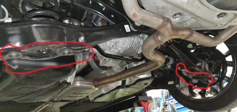

  10. Hi, The undertray and rear control arms protections were optional only if the vehicle was equipped with DCC. Mine (2021) has them:
