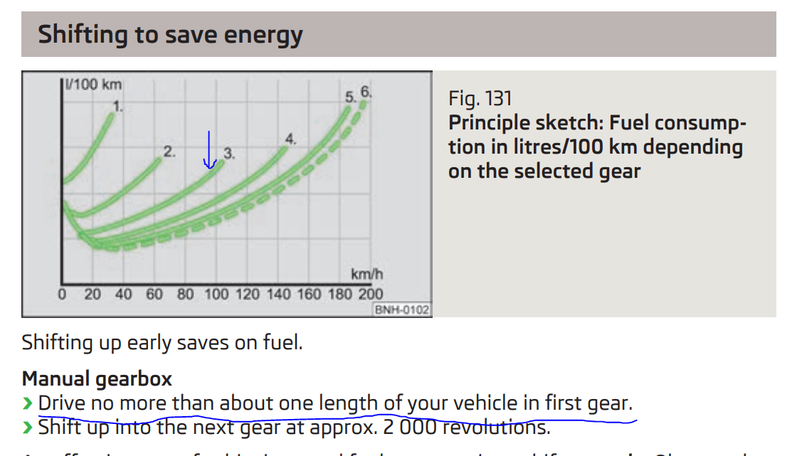

  4. Grab from Yeti Manual. My civic is picking from 18kmph in 3rd gear without knocking, and without slipping the clutch. Yeti is picking from 20 Kmph without knocking. I will be checking the diesel filter in the upcoming service whether it needs to be changed or not. Thanks all for the reply.

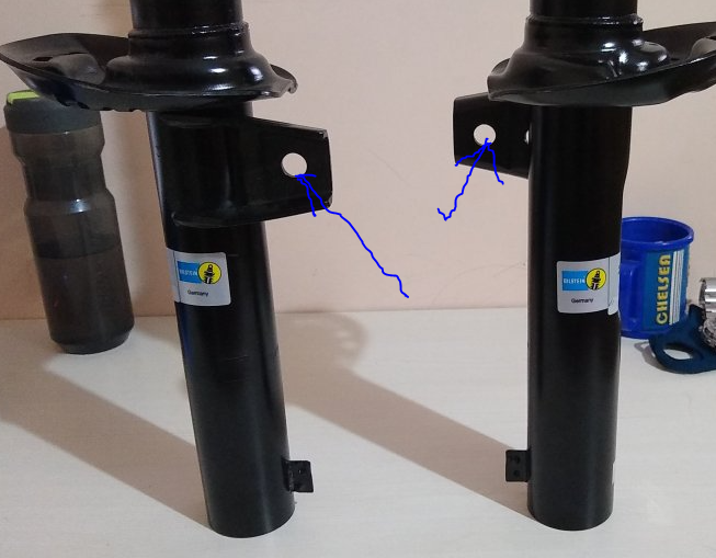

  9. This is the B4,s i bought . The marked holes are to connect the stabilizer link. If its not mirrored it will twist the antiroll bar in a parallel road itself. right ?

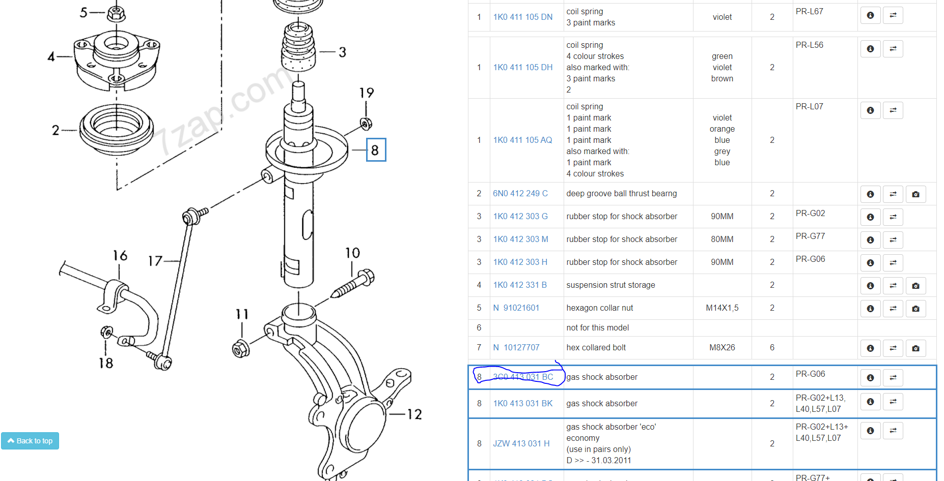

  10. Hi Urrell, Thanks for the reply. I bought equivalent item for 3C0 413 031 BC. its mentioned as 2 numbers. the attached

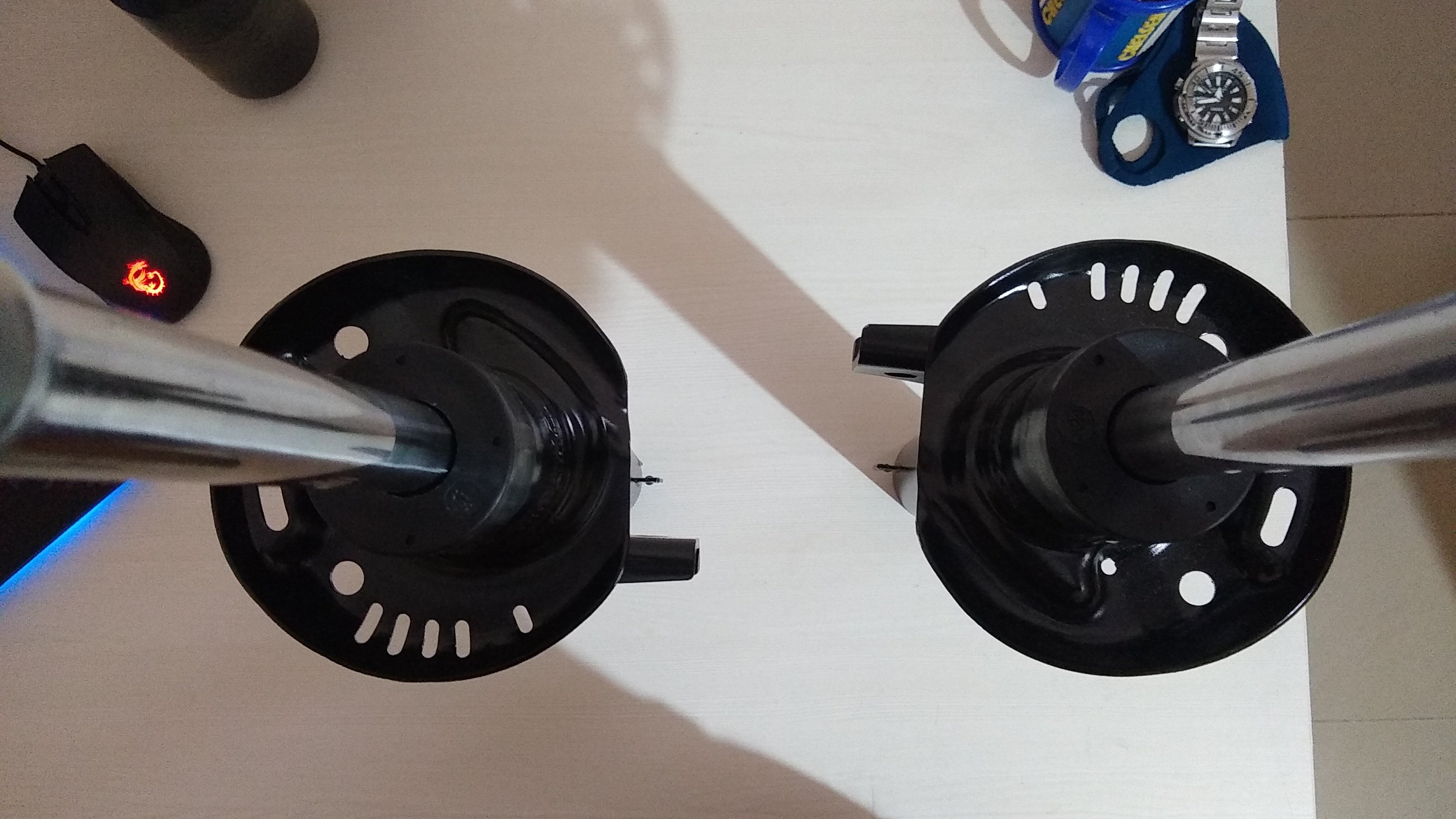

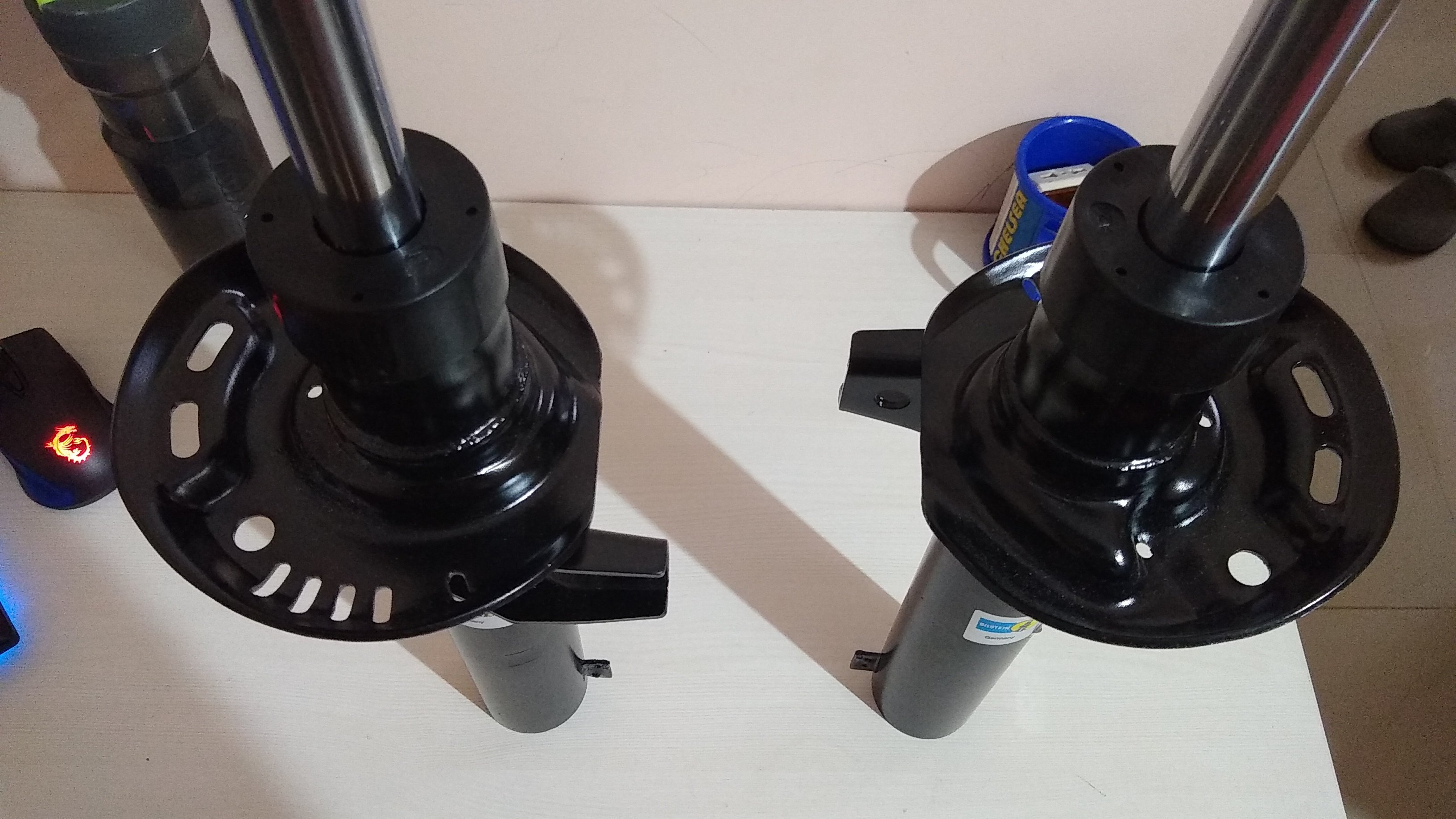

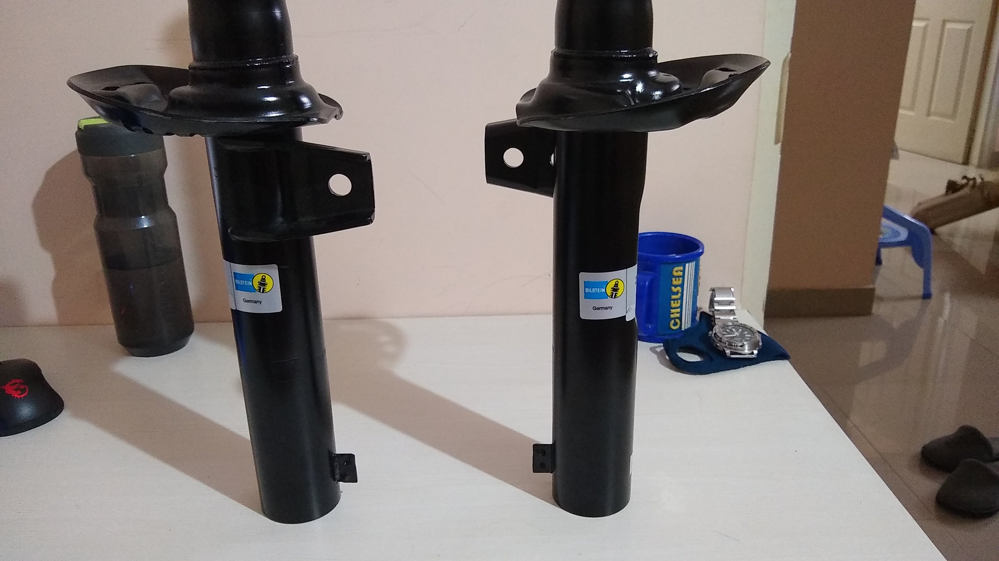

  11. Hi, I am in between replacing my front suspension struts. Got a doubt that "Front struts are mirror to one another( part with different numbers) ? or same part number for both sides" ?. Anyone changed front struts, please help.
  12. Hi Andrew, thanks for th info.
