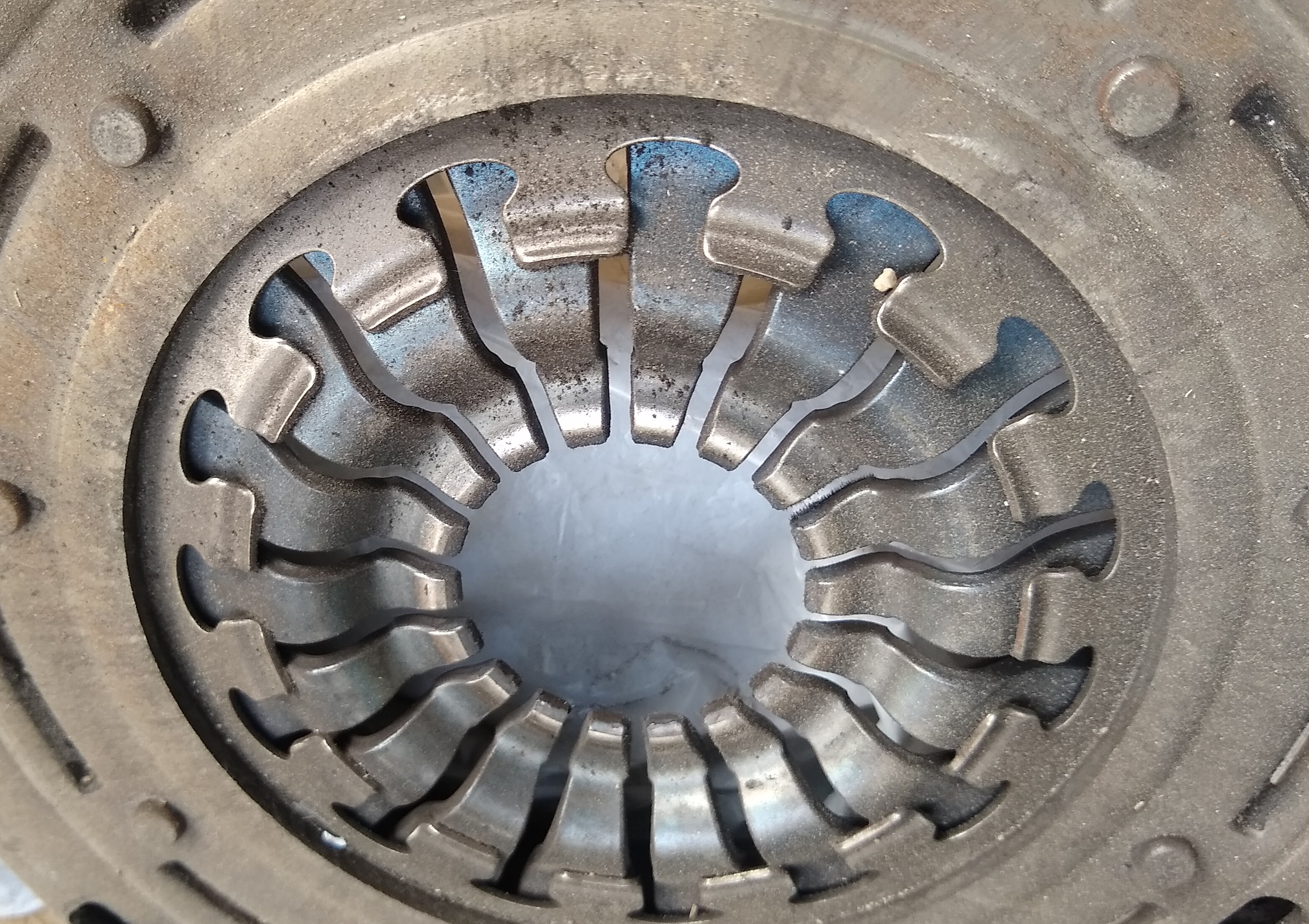

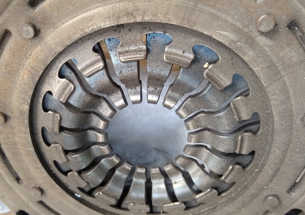

@Warrior193 couldn't see much of material removal on the part. Image attached. I think Urrell make sense. Still I didn't check the assembly thickness of 3 plates. Another thought- Release bearing stroke may be enough to handle both diaphragms. Strut bearing+ tie rod+ stabilizer link+ front brake pad replacement + front brake disc facing has to be completed. Will be completing the work today. Planning to test drive tomorrow morning.

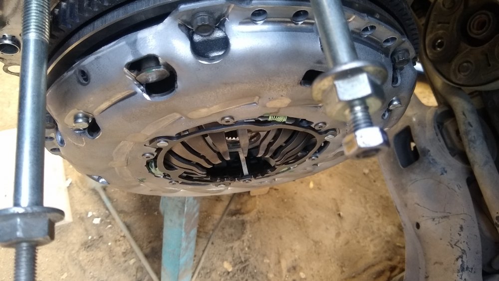

Hi, I am in between integrating the new clutch kit ( 3P+ release bearing). In new pressure plate, th fingers are little bit projected out compared to the old one. Fingers: the sheet metal fingers where release bearing contacts the clutch. Old one is made by Sachs and new one is Luk. Any one experienced this ?. Pictures attached.
