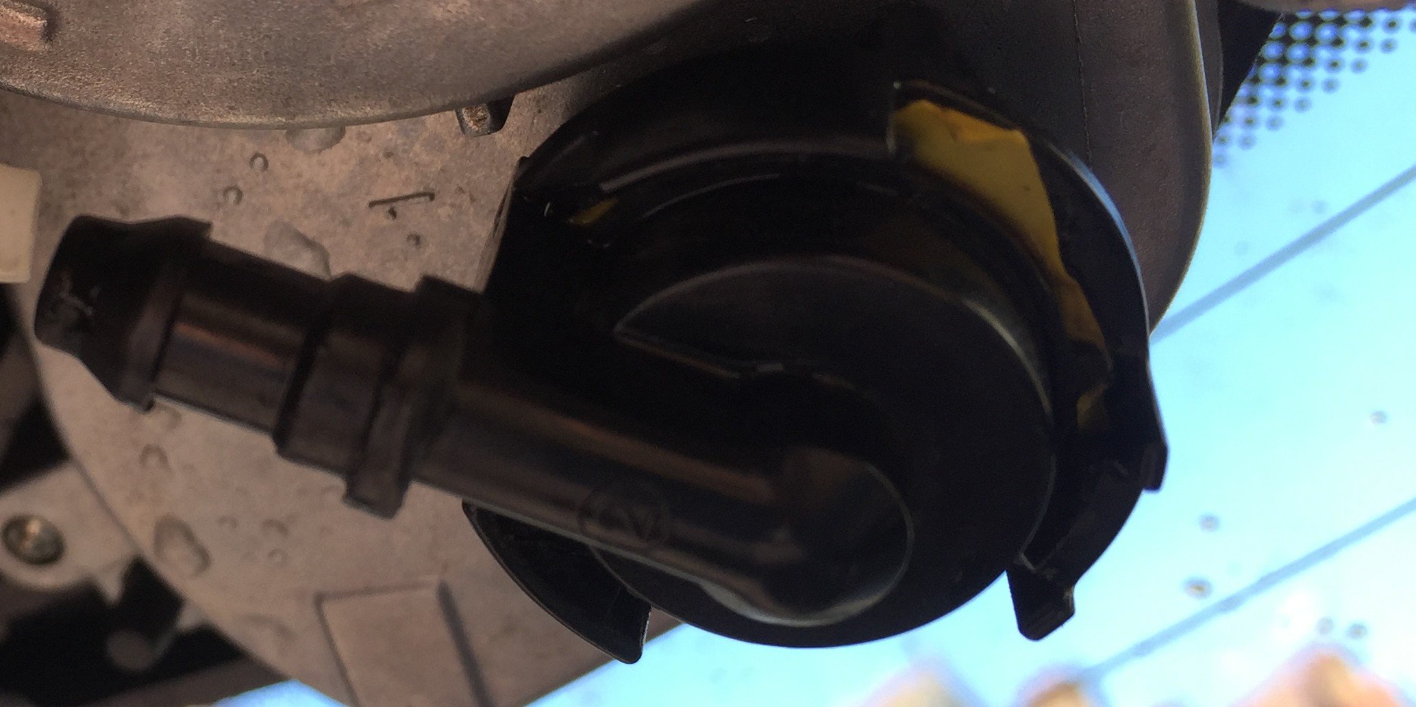

  9. Hi all, I've managed to clear a blockage on my newly purchased MK3 Octavia. However the clip for the pipe that goes onto the back of the pump is in poor shape and flies off when the pump is activated Does anyone have a part number? Struggling to find it Thanks
  10. Hi all, I've managed to clear a blockage on my newly purchased MK3 Octavia. However the clip for the pipe that goes onto the back of the pump is in poor shape and flies off when the pump is activated Does anyone have a part number? Struggling to find it Thanks
