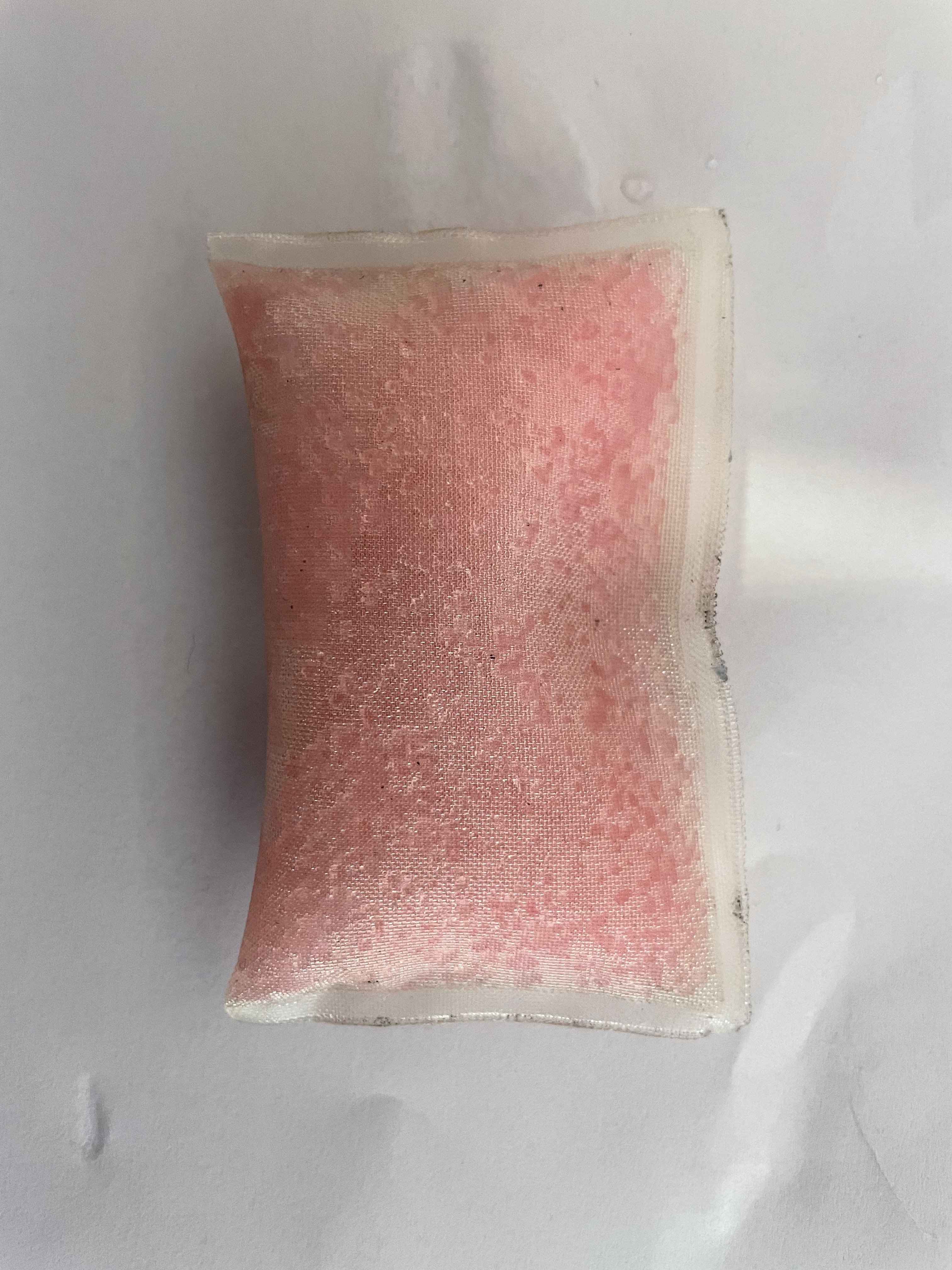

The Silica bag not being present will contribute to the problem. G13 is Si-OAT (Silicated HOAT) – i.e. Silicates and organic acids. The bag of additive never splits in my experience, it is there to prevent Silicate falling out of suspension and blocking the matrix. Flushing the matrix doesn't work, once it is out, change it. Only use G12 Evo and if mixing, only use distilled water.

Sorry to jump in on this old thread. I sent my 2014 Octavia mk3 in for a coolant/antifreeze change as I've opted to go another year or two before I change the timing belt and the coolant was looking very brown. Garage reported when flushed it was heavily contaminated and the silica bag had burst and has now been removed. Shame I didnt know this had all been done and put back together before I collected it as Id have said about replacing the matrix as Id read about it last winter as I noticed the heating was naff.

I reckon it will be your heater matrix. I had the same. Silicon bag in the expansion tank had burst and contaminated the coolant. Flushed the coolant system, changed the expansion tank and replaced the heater matrix and it's all good now
