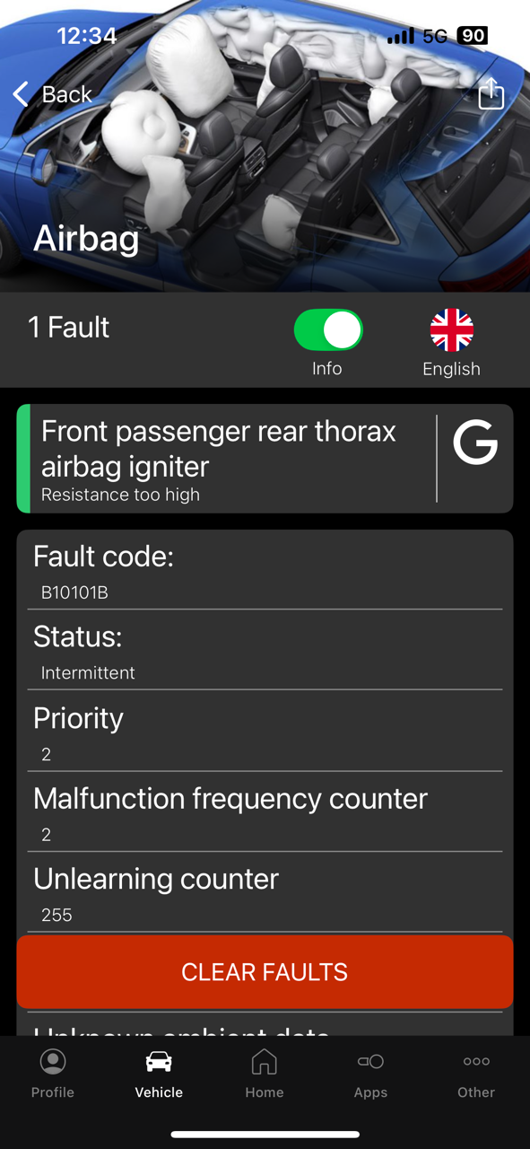

And airbag light back on within 10 mins. Oh well - seat fully out I guess and need to find the connector in the seat and not under the seat as I suspect that it is the one!
Airbag front passenger rear thorax igniter fault - air bag error B10101B - Octavia VRS 2016

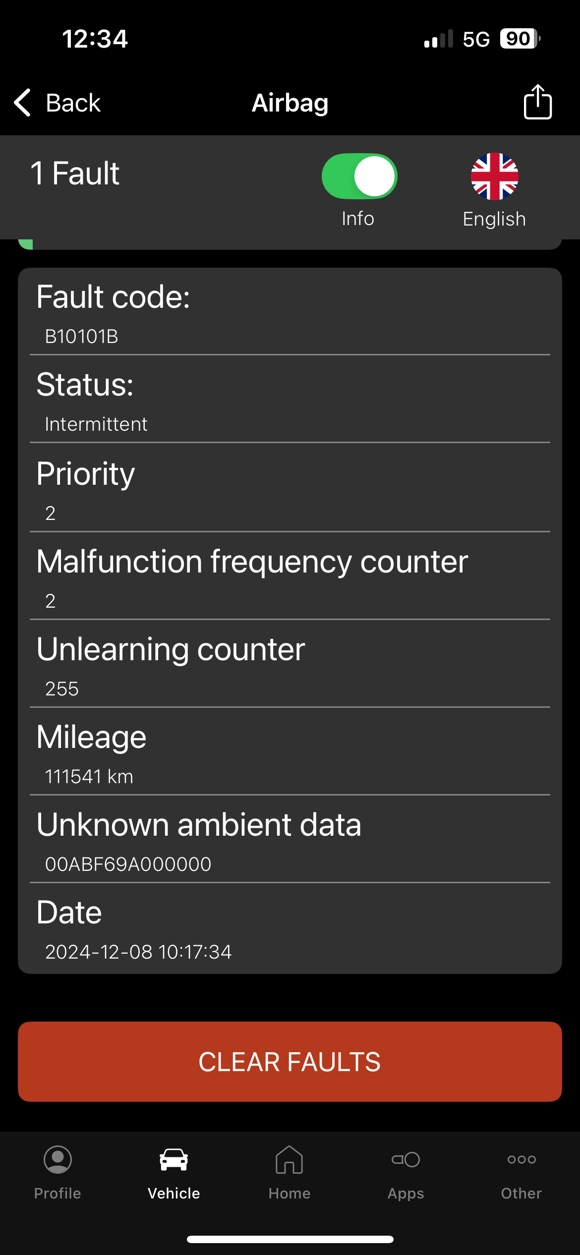

Ok - I could see in the chassis there were three connectors. Two black and one yellow from memory. The two black ones then joined up into the same cable which would be electric seat controls and then heated seats. The single cable (with three wires) was the yellow plug and that went off on it's own and seemed to go off into the edge of the seat base and then up into where the curtain airbag lives. I imagine that is where the other connector must be and that I need to get out and clean. The light came back on after after 15 mins of driving yesterday. I cleared it again and will see. This is using OBD11. Wonder if VCDS is actually required though!
So took the seat out (partly) today and found the yellow connector under the carpet by the seat rails. Gave it a good clean and put it back. Light was cleared and came back within about 30 secs. So next thing is to take the full seat out and try and find where the cable ends inside the seat itself.
Thank you. And no, very rare to have people in the back and certainly not for a while. I think this is just one of those quirks that once started will not stop. Could be a dodgy igniter of course but will go for the contact cleaning first and see what happens. It is more annoying than anything!
Hi all This is a new one and just curious to see if others have experienced it, or similar, and potential solutions. 2016 VRS, here in Aus. Car was fine then once day showed airbag error on dash. Read codes, and cleared. 144 km later it reappeared. Have now reset it a few times, and it varies as to when it reappears - quickest was about 5km later, others can be 50-150km later. Not always when starting the car either. Reading seems to be that the wires can get frail or stretched a little and thus cause dodgy connections. So, my assumptions and thoughts (for your guidance) are: Error is 'Front passenger rear thorax airbag igniter' - resistance too high. Fault code B10101B I assume this means the seat airbag, passenger side, and the igniter would be under the seat? Seats are electric. Next steps would be to disconnect battery, lift seat up high and see what is underneath. From experience clean the terminals or should I look at getting a replacement igniter? Thanks

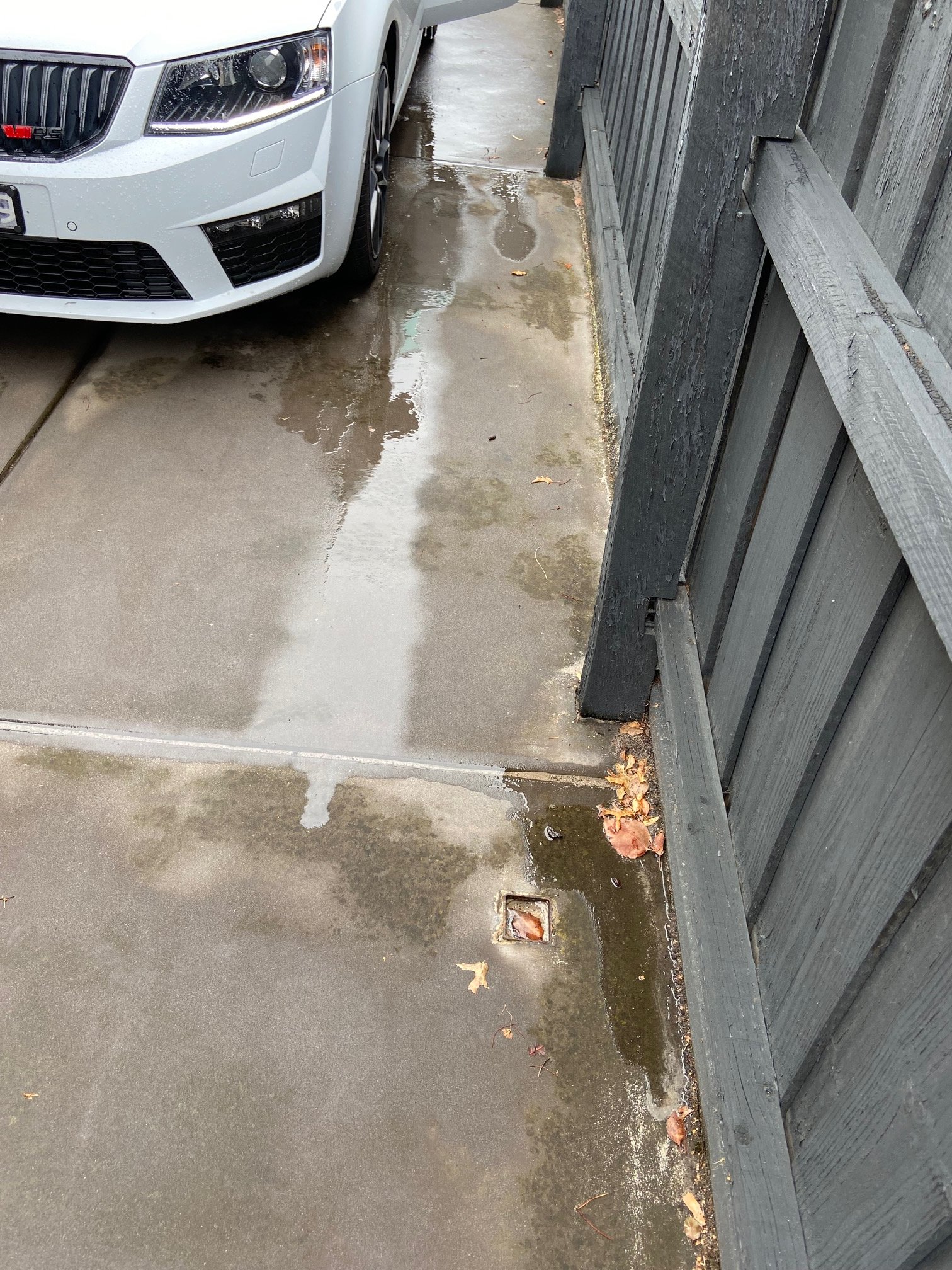

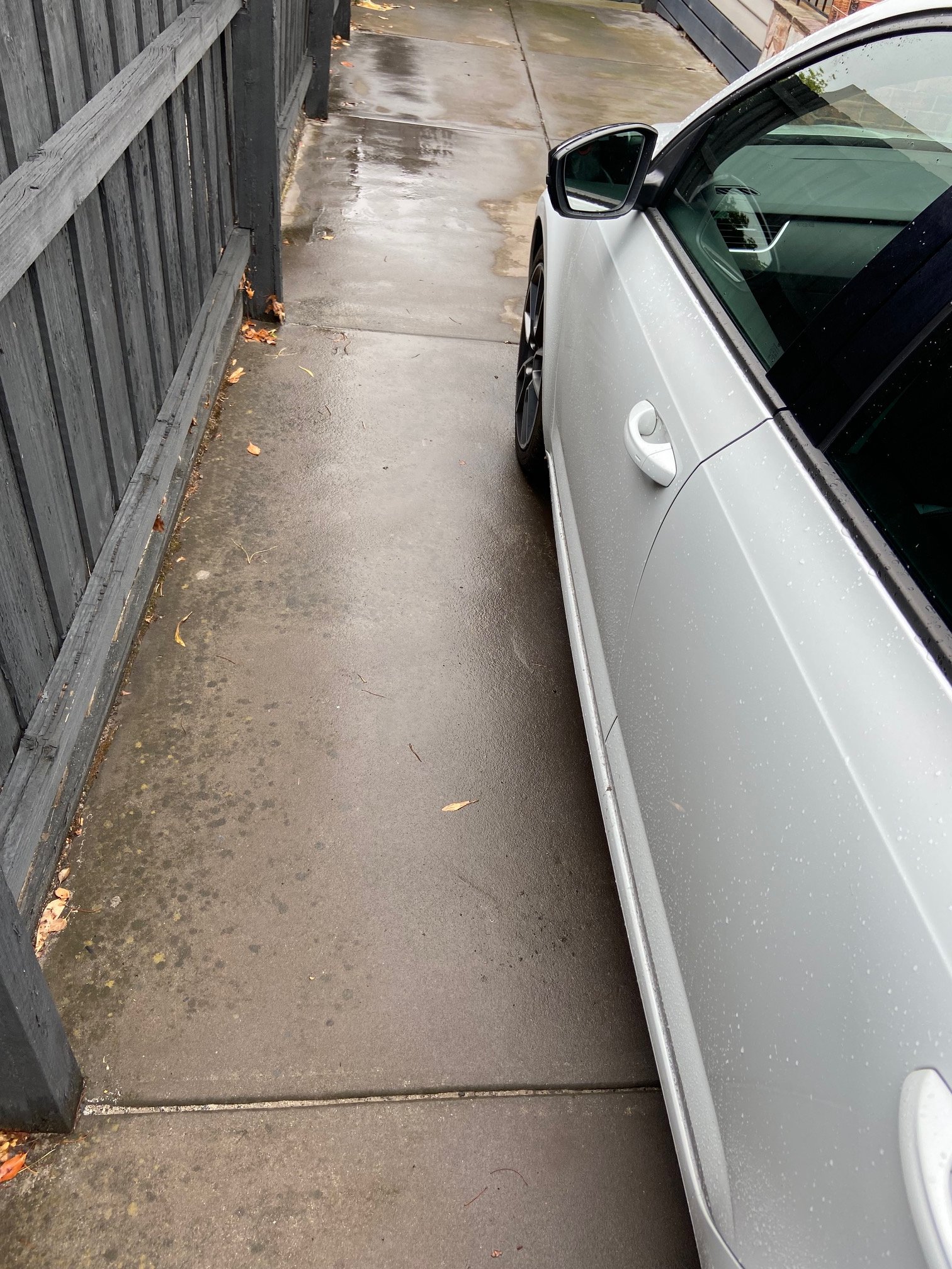

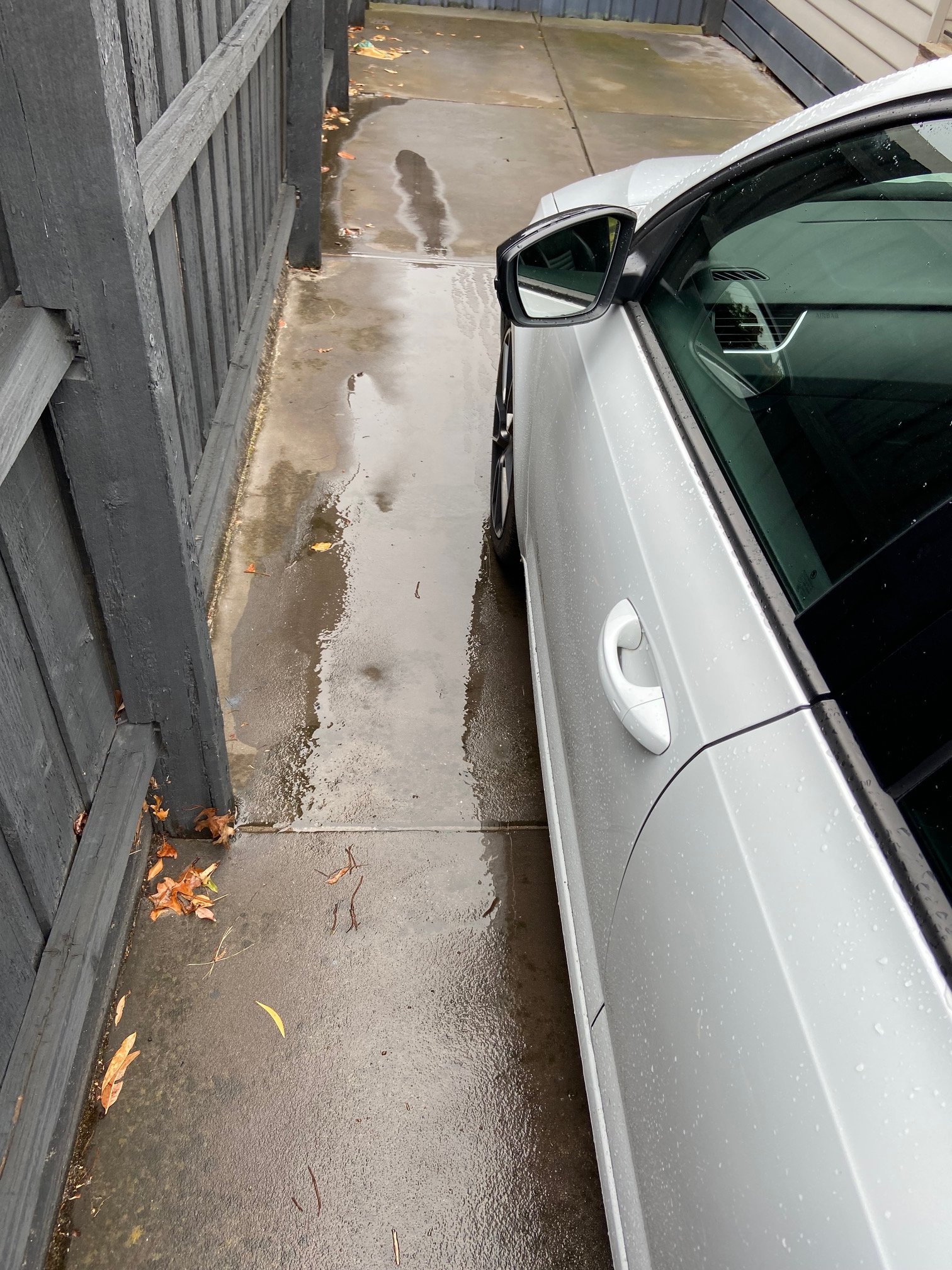

Hello team I know the sunroof drain holes blockage has been covered, but this was my finding today that may help others. Here in Melbourne, we're in summer. Yesterday we had a storm come through, not long but torrential rain for a short while. My car, MY16 VRS with panoramic sunroof, when moved, had water sloshing noise from what sounded like passenger side sunroof area. It was the same this morning and very obvious. So I got home, grabbed my trusty curtain wire, and had a look at the sunroof holes (only the front ones) and all seemed fairly dry. I gave both a good cleaning anyway, then started the car and the water sloshing was still there. Damn... Then I decided to do more investigation on the doors, and blimey, this was my finding. I had seen how the front doors, in the rubber seal, have two obvious drain holes. The rear doors do not - they have one (near the rear of the car), but on the passenger side rear door, when I pulled the rubber away, it obviously released what was sitting in the bottom of the door, which must have been fr4om the rain yesterday (as we have had some good high 30 degree days recently and no rain for a while so anything there would have evaporated. The images show just how much water came out once I gently pulled the bottom door seal (close to the hinges) out - it was very dirty as you'd expect but this was totally blocked. I took pics and a video - the pics show just how much water came out of the door and the video, if it works, where it was coming from. A massive surprise and maybe helpful to others. Here's a link to the video that may help more - Andy

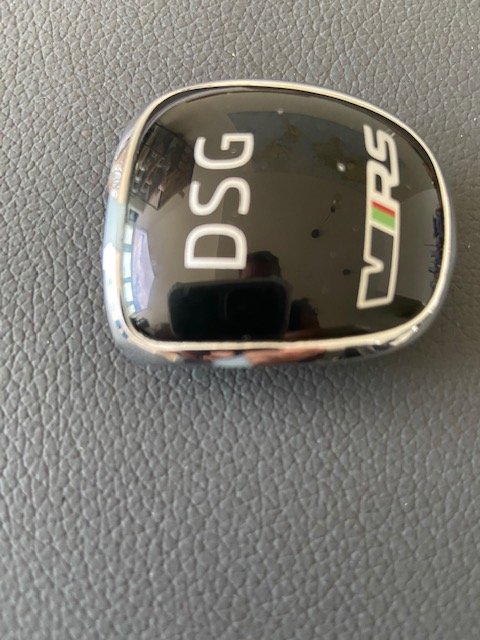

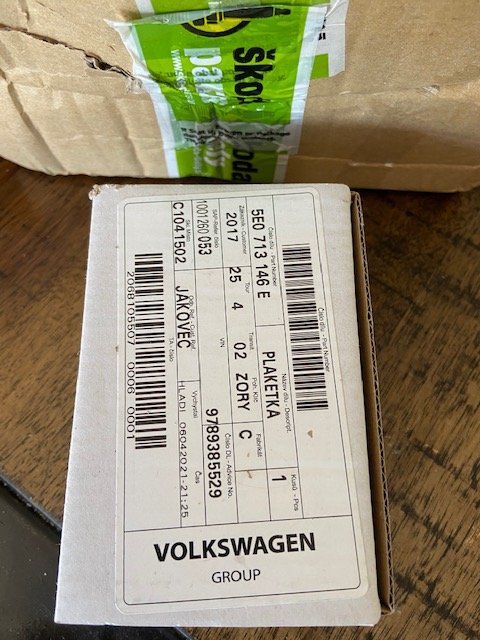

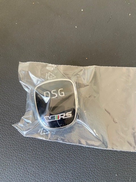

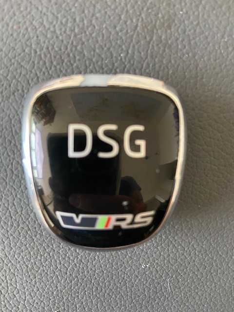

As this was happening on my 2016 here in Australia, I was looking at replacing the entire gear knob but decided to look at just the DSG VRS top part of the gear knob. I ordered it from Skoda Parts, based in the Czech Republic who were great to deal with. The cost of the part as 14.52 Euro and shipping was 22.3 Euro, via Fed Ex. It took 6 days from them sending it to arriving with me so very quick. The part number for anyone who wants it is 5E0 713 146 E. I was a little concerned at how difficult it would be to remove it but I have to say, I was wrong. It took about 30 seconds to replace it. Very easy - I just used a small trim removal tool, pulled in the gear knob button to expose the top (front most) surface of the gear knob 'cap' (this is the part I am replacing), this then just flicked up and off with a little more pressure,. The replacement just hinged from the rear ward side and clipped in place. My old one had two sections where the chrome had come off and sharp (ironically this is exactly what happened on my previous R36 gear knob). So, for the total of 36 Euro, I now have a gear knob that does not scratch and cut my finger and looks far better. For anyone with this issue, and out of warranty, it's very very easy to do... Brand new one is in the bag, the other two show the chipped parts, and the box the part came in.
