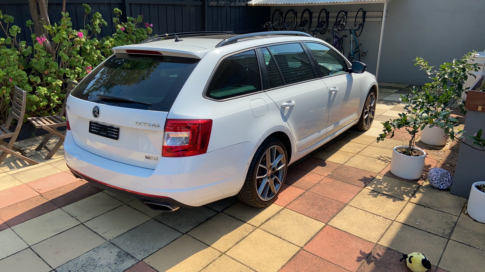

  19. Could be a number of reasons but what model system do you have? And you may need to do a reset in order to clear any issues, then give it 15-15 mins to find the satellites again...
  20. Sorry - was a typo - the seats did not help his back problem, probably exacerbated it, so he sold it for a Passat. How tall is tall?
  21. You are correct my man... they had it traded in because the previous owner developed back problems and the seats no longer for him. Good enough reason to sell - for me!
  22. Hi peeps - new owner here. New job so no longer a company car that I had for last four years, so thought this would tide me over. Hard to find but I ended up buying it from Adelaide (a dealer) sight unseen, which was not a good experience as I was so bloody nervous. Anyhow, MY16, fully loaded with everything and really nice condition. Already been in touch wit the first owner and sorted a few things out. He had never taken it to a Skoda dealer so it was still running original firmware (0318) and original maps (2016). Soon changed that! Now running 1433 firmware and 2021 maps. I've also updated the side mirrors to the new indicators and also the lights under them to LED, and just waiting for the LED bulbs (external) and interior LED packs to arrive and I'll do that next. I also ran OBD11 (which I have for my missus MY21 Polo GTI) and it has 55 recorded faults. But because these went back to 2016, it had never been checked. Virtually all were down to a low battery! Now gone and just waiting RWC and then inspection and registration. So it cannot be driven at the moment...
