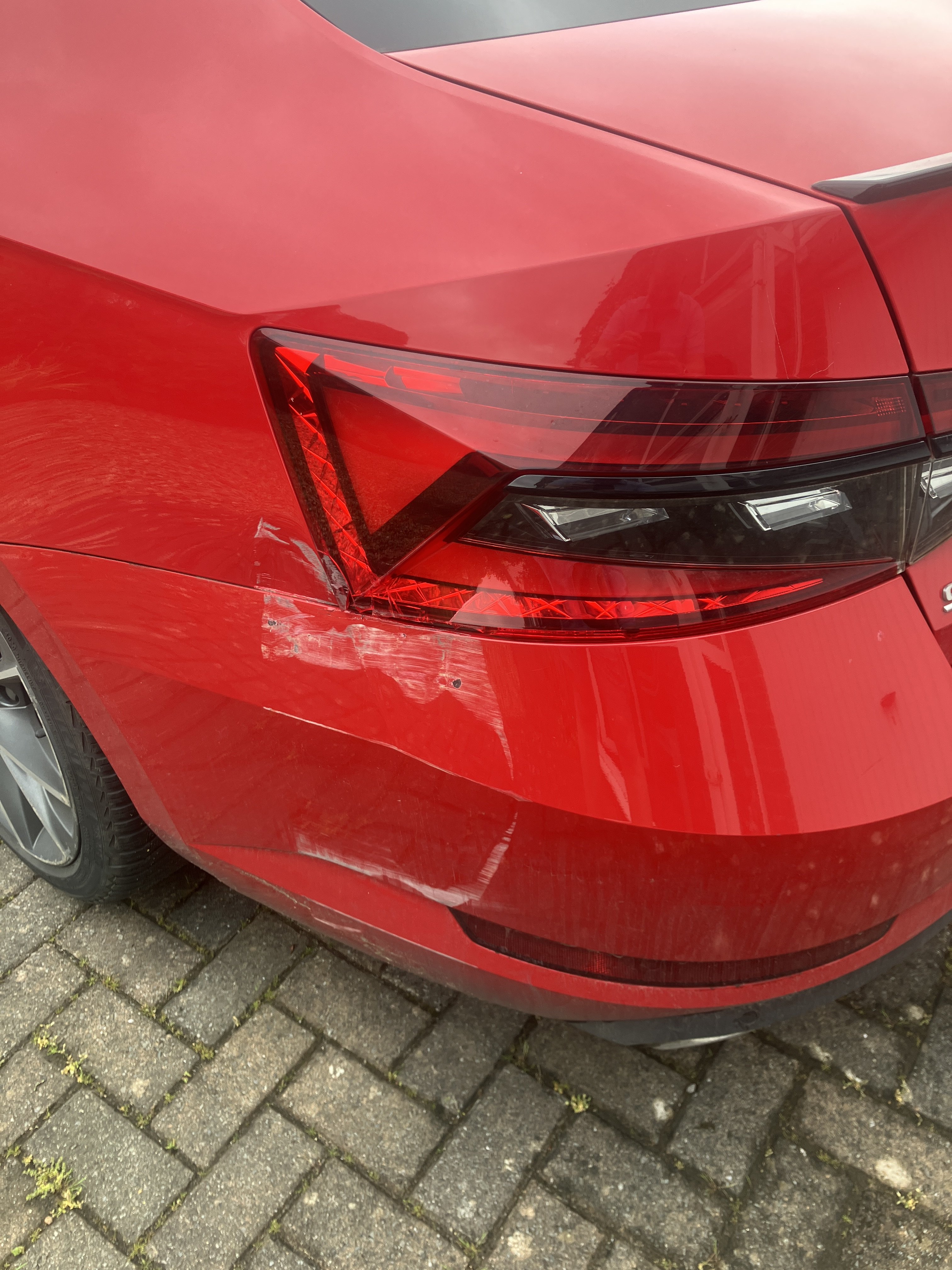

2020 2.0 tsi sport 190 Tail light outer needed
I need a replacement but don't know the part number. It's got the dynamic indicators so i need to be sure on eBay etc. Any suggestions or offers accepted. How much is this new? Does it need coding in? My bad reversing🙏
