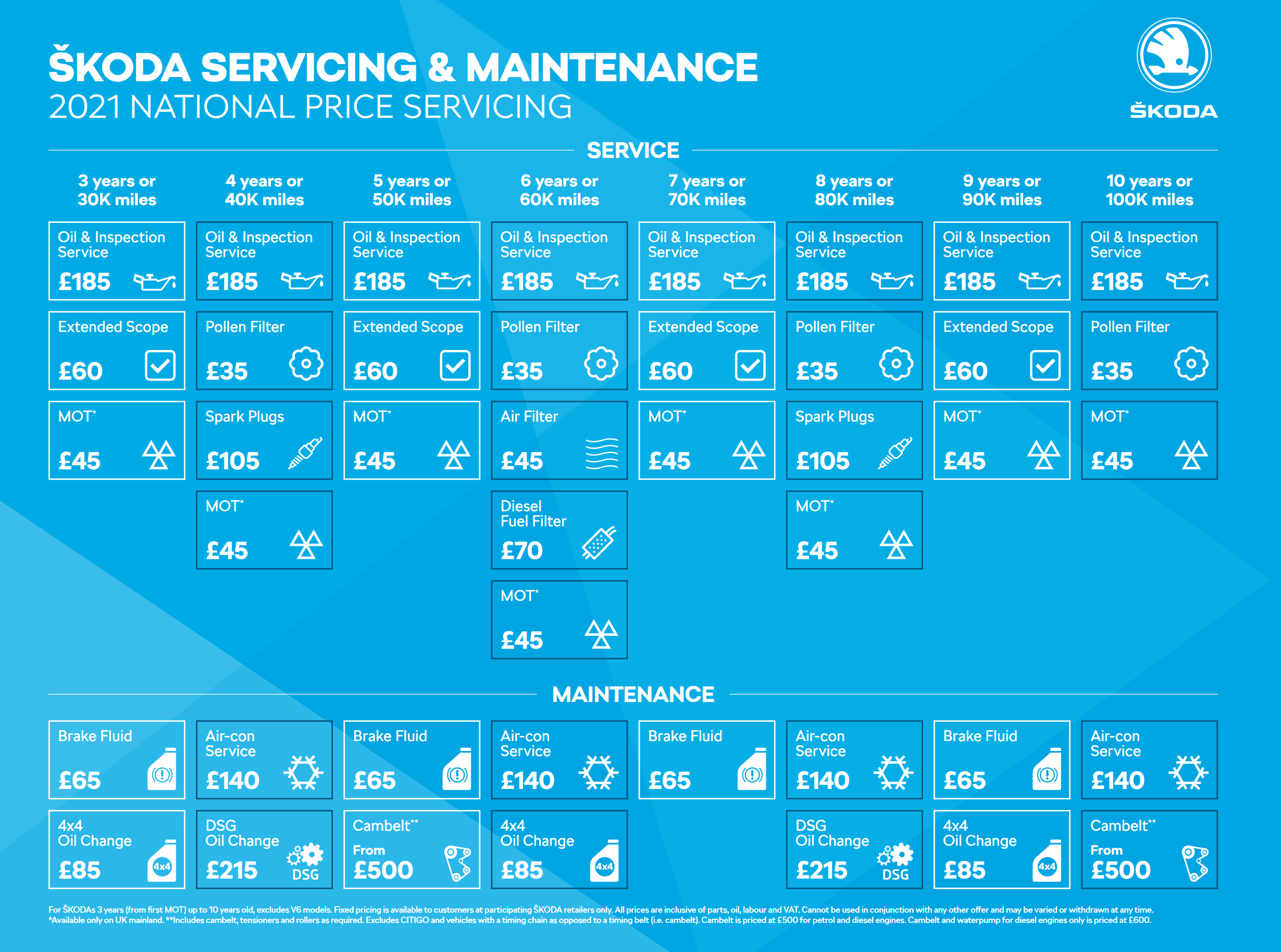

Hi I have a year 4&5 service plan and extended warranty. This Skoda service schedule someone on here have me attached says oil maintenance of DSG at year 4 / 40000 miles (chargeable) £215. I've done 33000. I phoned main dealer who say that it's now 80000 miles no year requirement. Is this right? I've asked them to check with workshop. Is this really a change or a mistake? This would be an expensive failure so i could do it after the warranty has expired i guess. Anyone any actual experience of DSG failures, oil changes etc

These cause confusion.
922218293_Screenshot2022-09-2115_58_57.jpg.3711dc86397a804fc83f268add4ae736.jpg.21c56214570b3b8eaaead2f264478d06.jpg
Are they right or wrong In the second and third coloured documents though please? I'm assuming i have a DQ381. Is it worth a change before or after warranty?

The Service Guidelines, Recommendations, Advice, Specifications, Schedule for a DQ381 Oil Change according to VW / Skoda is @ 80,000 miles.
