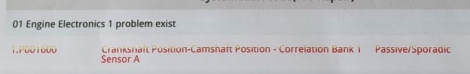

  1. Hi All, cutting a long story short, after a code read i have the following pop up. this does explain the symptoms i am going through at the moment with my Mark 2 facelift. 2.0l Diesel. Question: has anyone does this themselves? if so, have you documented this? or can you tell me a) the part(s) is needed and b) rough location of it, or maybe a link to a video or something? not a lot that i could find out on the tinternet. thanks a lot, in advance
