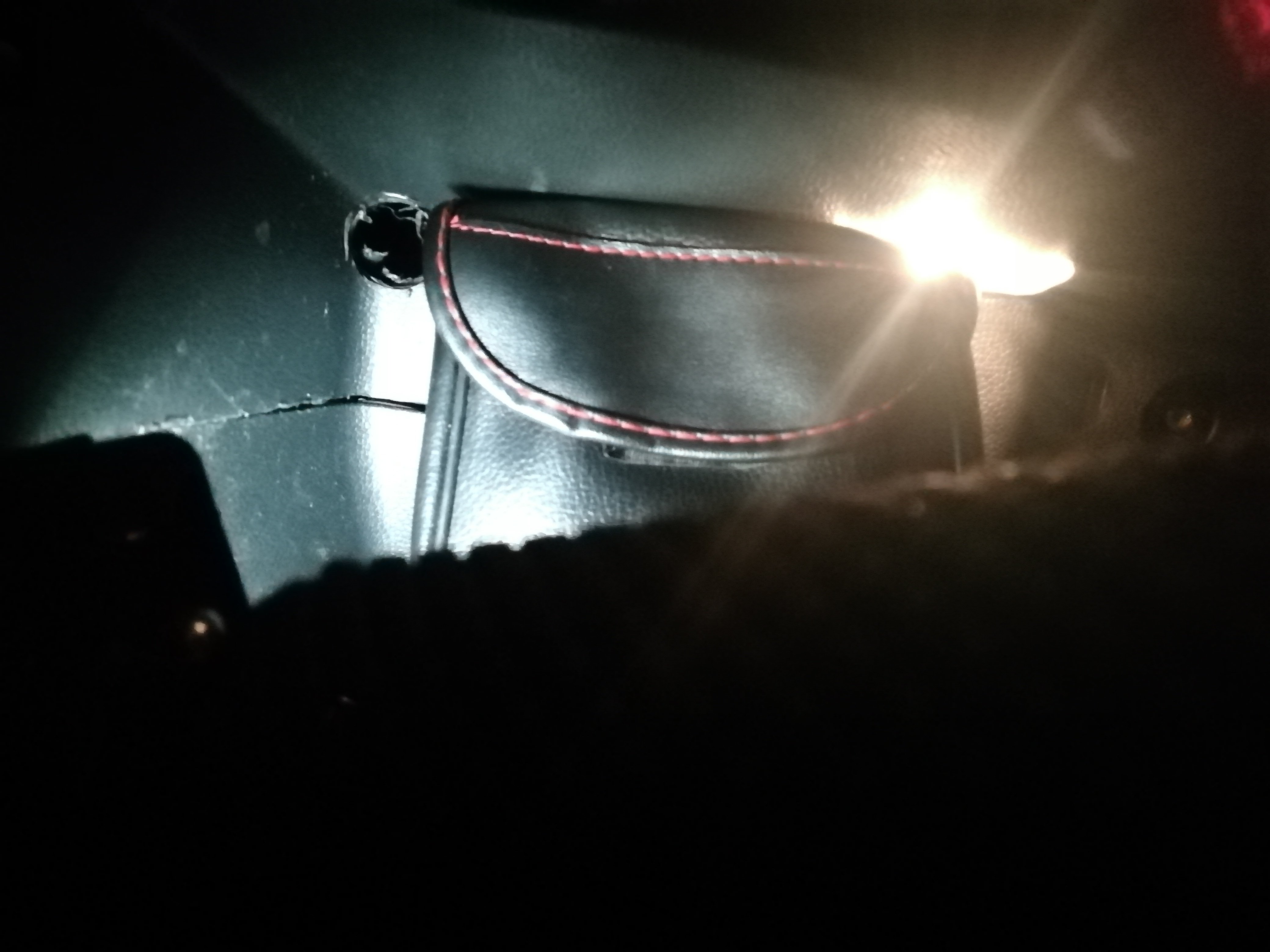

Hi My old Fabia has Climate control, So I didn't mind drilling holes in the back of the glove box as it wasn't removable. Your 2010 Fabia might just have a removable lower glove box which would make the job simple. You might be lucky but it really isn't that bad a job just awkward . No need to mess with the air bag either.

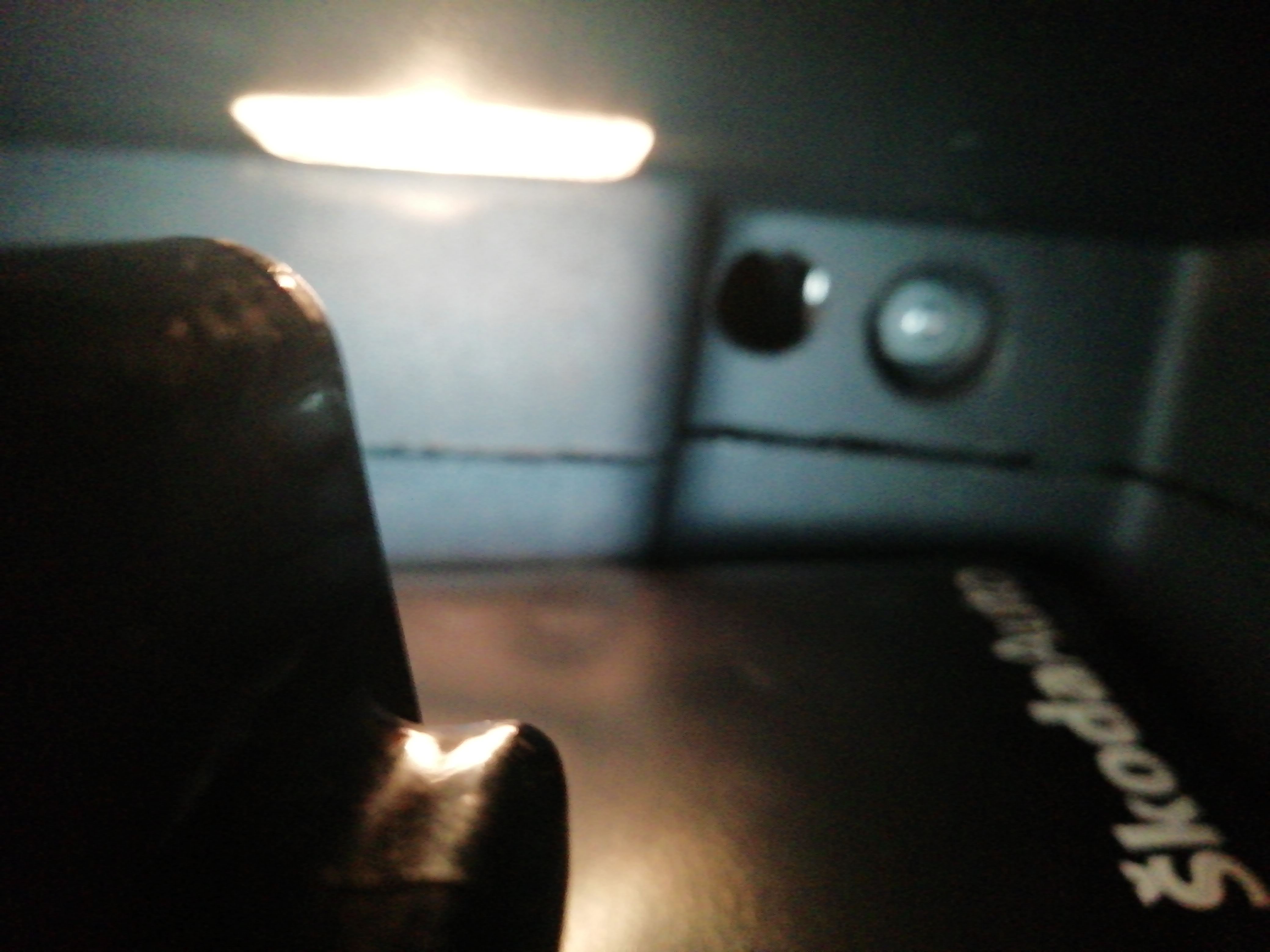

I looked underneath to see roughly where the screws are located then drilled a tiny pilot hole and shined a torch through it it see how far i was out then drilled out a bigger hole.

Hi Took a couple of pics top left and next to the right fixing point as close as you can get it and up about 2cm. I could get at the star screws to remove and replace them. Shine a torch and you will see them. You can glue the plastic back in afterwards I just used some rubber grommets used to seal electrical boxes as were a good fit.
