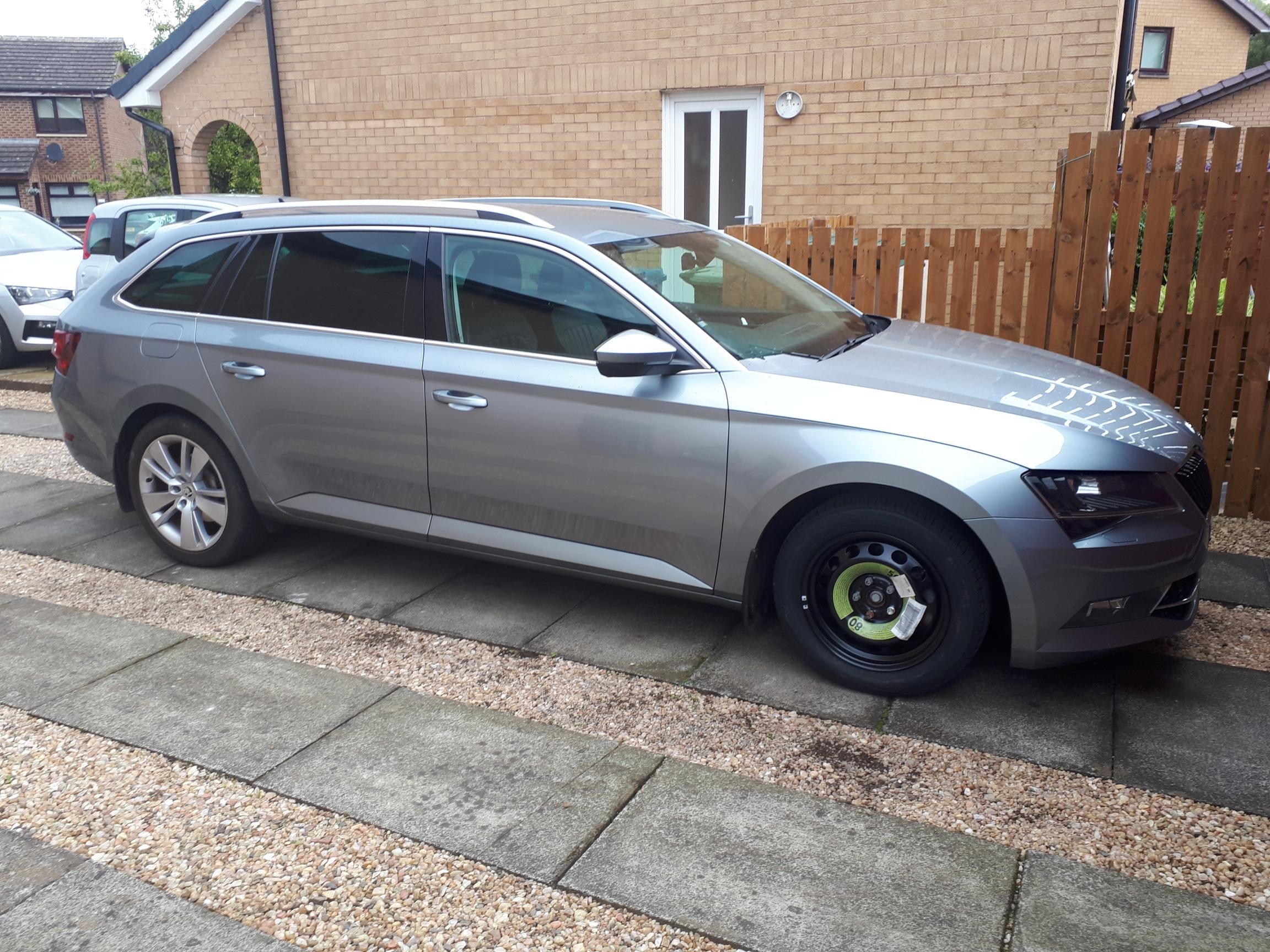

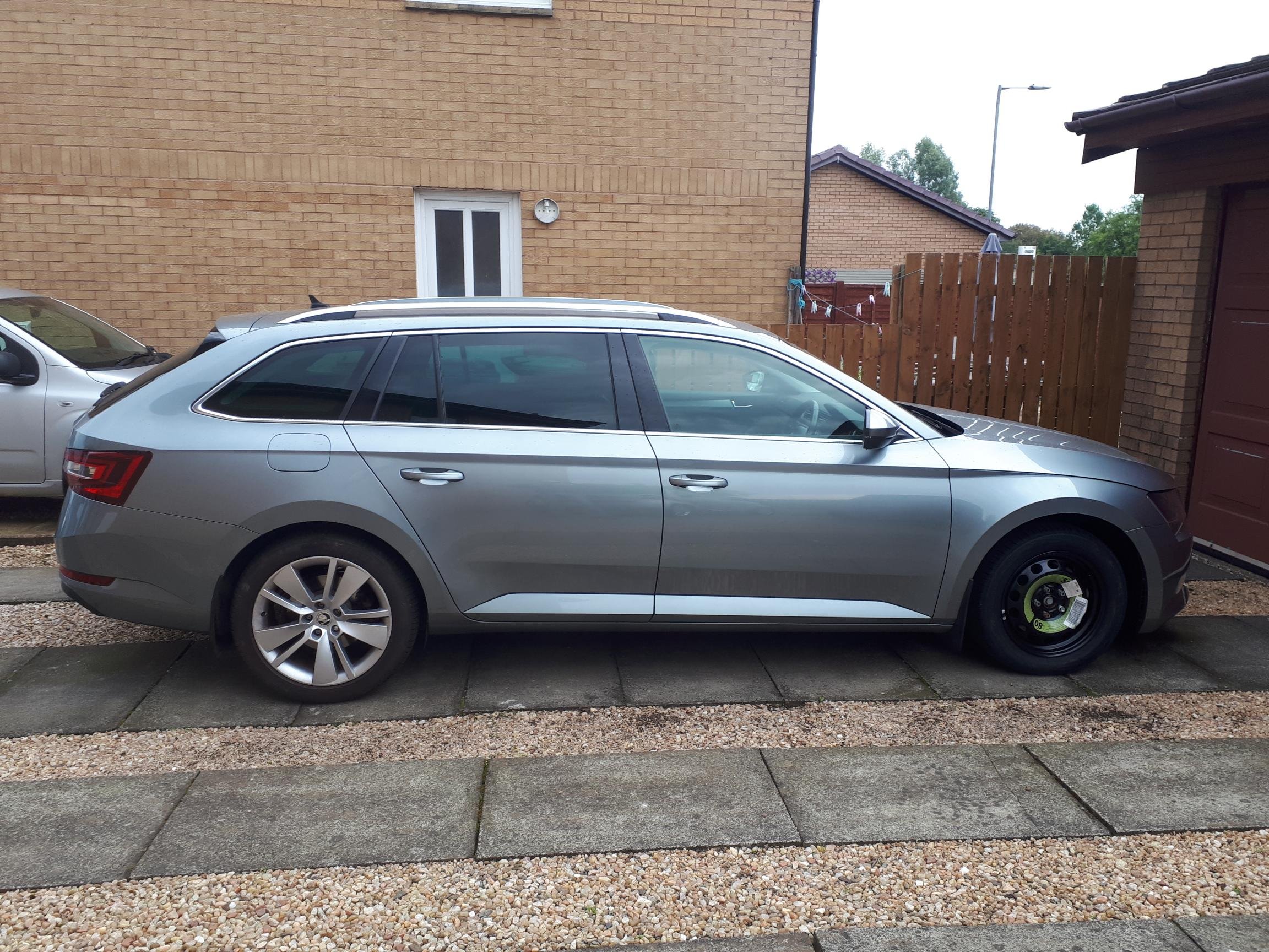

  6. Good morning, everyone, I got a puncture on Thursday evening near home and managed to get home on the deflating tyre which was the front drivers side. The tyre is a 235/45R18. Once home I swapped on my 'full size' 205/55R16 spare, and as the tyres were already all at 3mm decided to order four new Cross Climates. The car is a 2018 2.0TDI 4x4 estate. I noticed when the spare was on that it was much less in diameter than the normal wheels and tyres. Originally I was to get the new tyres on Monday, but Blackcircles have pushed this back to Wednesday now due to delivery issues. This morning I had a short errand to do and took the Superb. Well, it is almost undriveable, It feels as though the brakes are gently grabbing at what I presume is the spare wheel as the car seems feels to be 'missing' and juddering like an old fashioned misfire. At the short stretch (a mile) of dual carriageway the car would not go above 40mph and traction control light came on and off. Once I got to my mum's house (the journey is approx. two miles) on leaving the car there was a terrible smell of rubber or clutch from the front wheel well where the spare is. Most odd. I know there can be an issue with fitting a lower diameter spares on the rear of 4x4's but this is on the front. I am technically minded and happy to work on older cars, but this really has me perplexed. The loss of tyre pressure indicator stayed on continually despite trying to set it to compensate. I am assuming that maybe I shouldn't have done that as that was causing the monitoring system confusion but why the car should drive so badly as to be effectively undriveable is worrying me. What makes it doubly annoying is the car came with the bottle of skoosh and I went out and bought Skoda's 16inch full size spare just to cover me for this very eventuality. Have I missed something? The handbook makes no mention of it. Any advice appreciated? All the best Sandy
