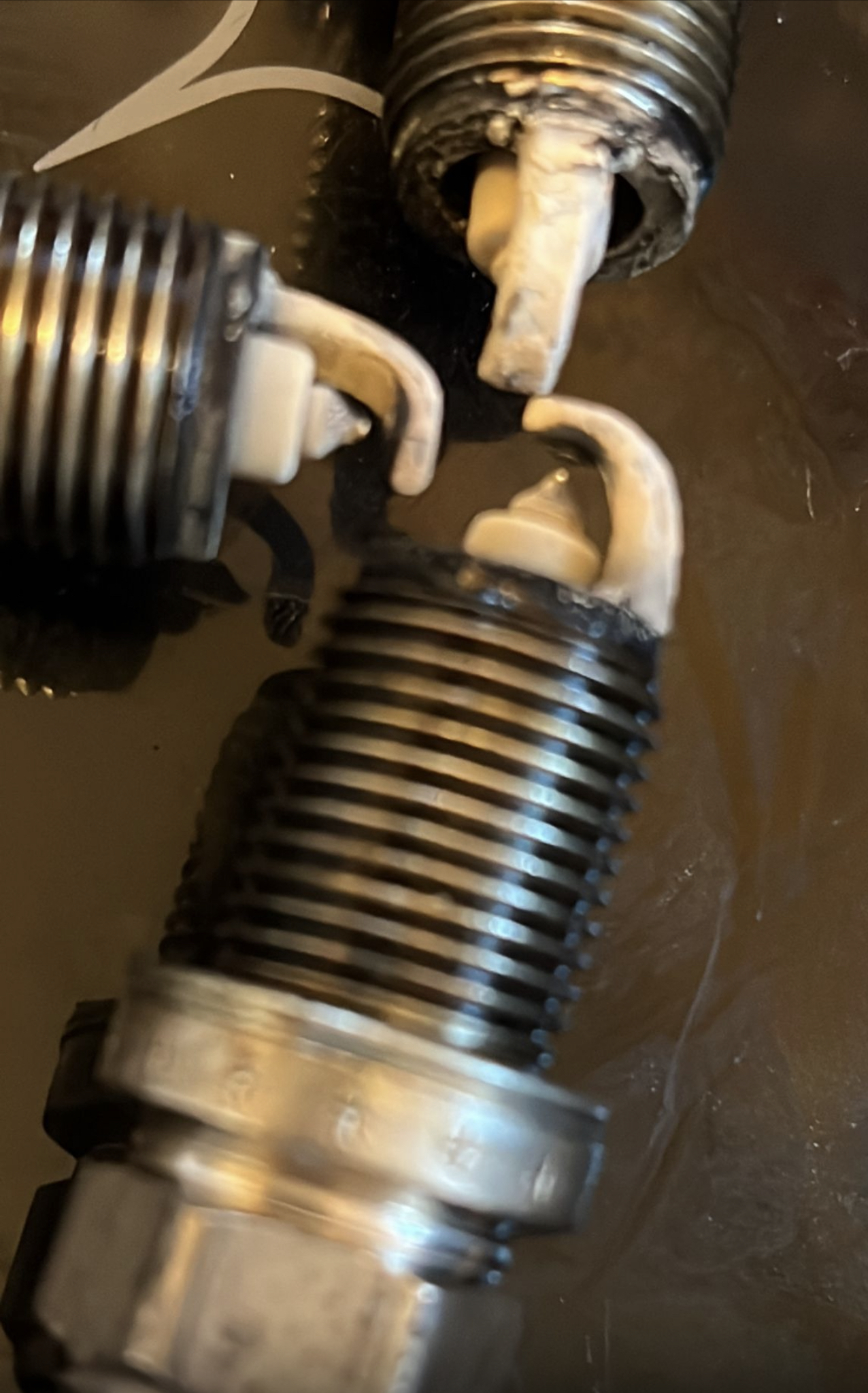

  10. Also after changing the Denso spark plugs that have been in for just over 12 months and roughly 6k miles they look like this! Is this from fuel air mix or temp? Thanks

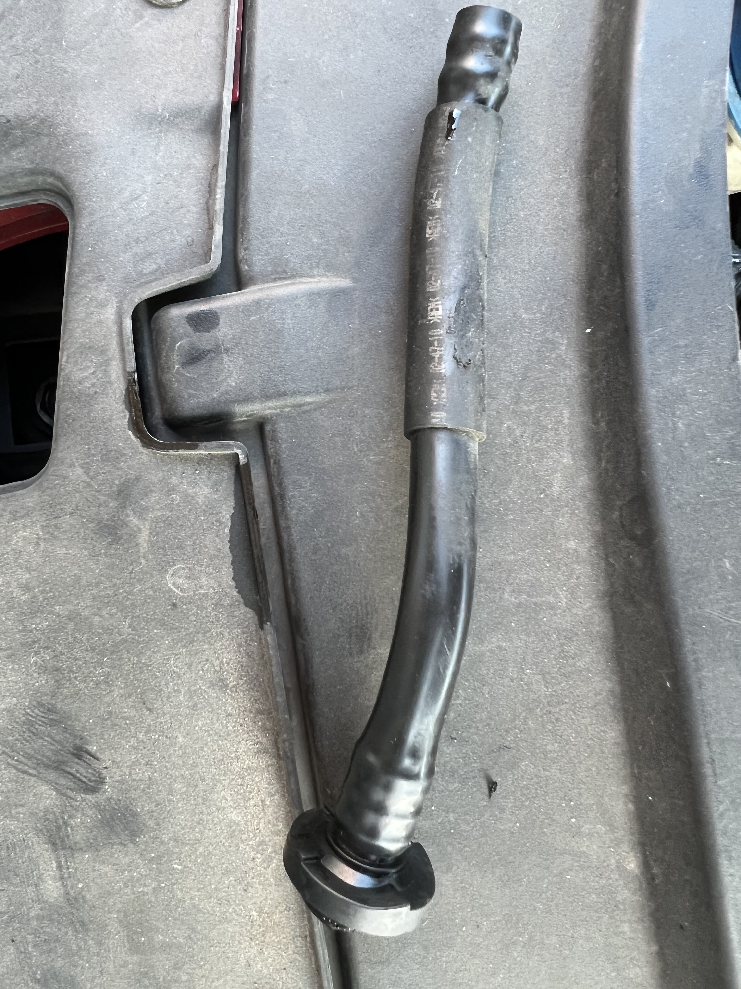

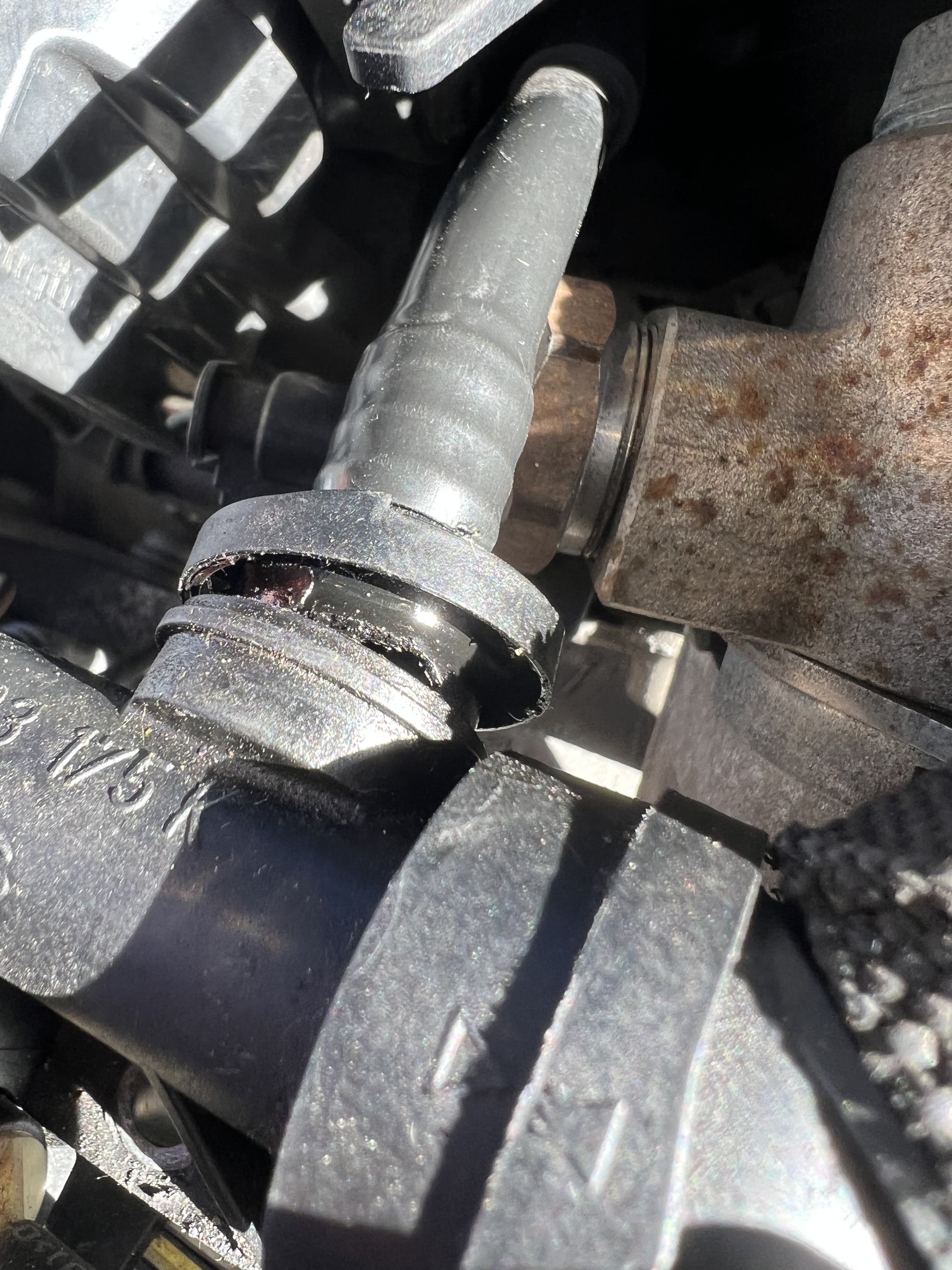

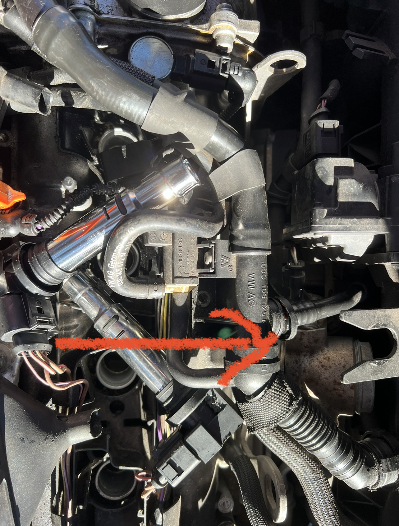

  11. Hi guys just trying to change the wife’s spark plugs in her VRS and noticed a bodged repair on a breather hose that had electrical tape around it. I’m no technician so have no idea what it’s called to find a replacement so here are a few pics. If anyone can help me I would be grateful.
