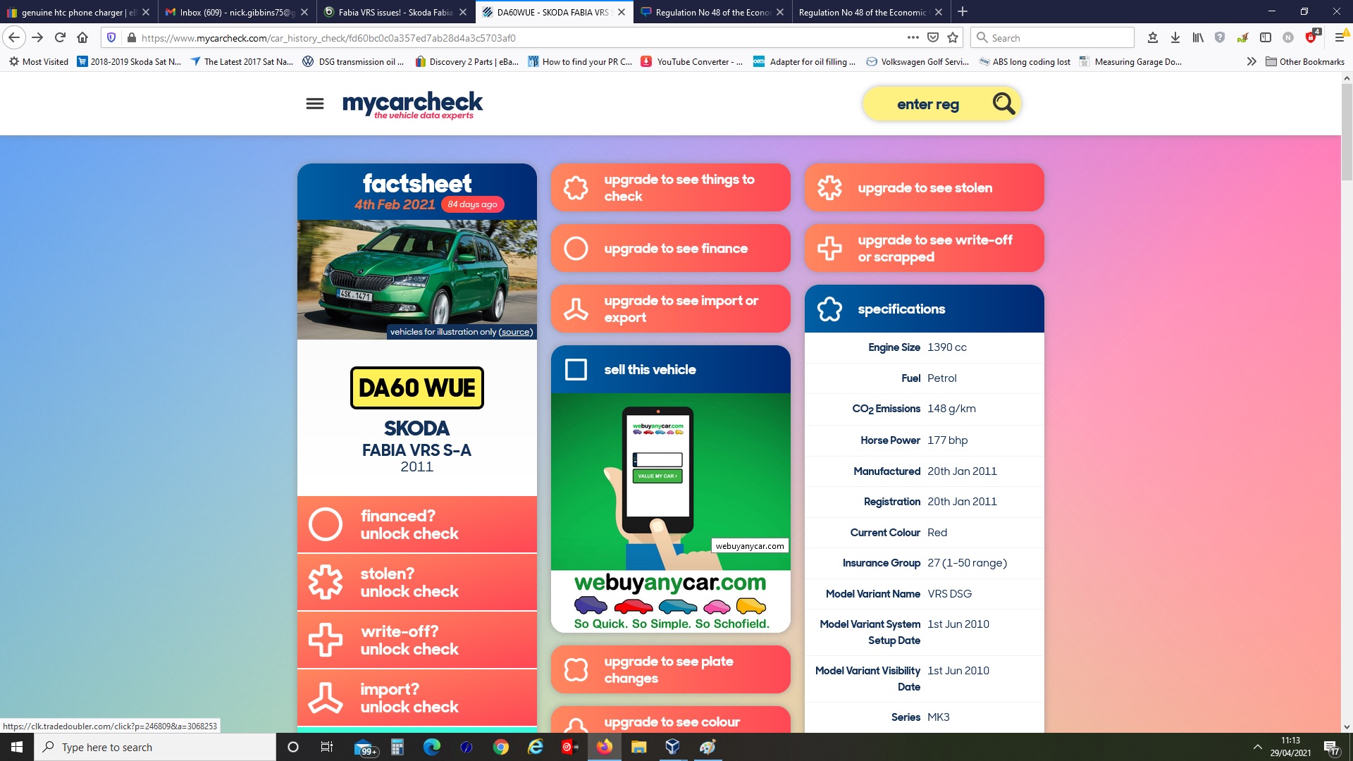

Is that reg correct ???
Edited by UrbanPanzer

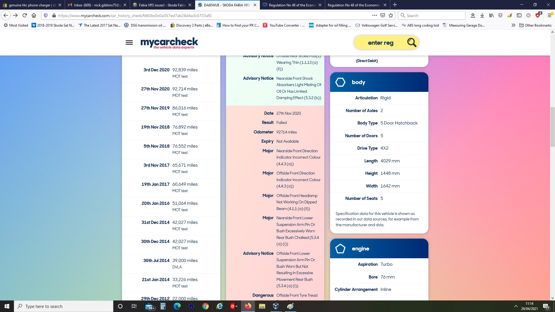

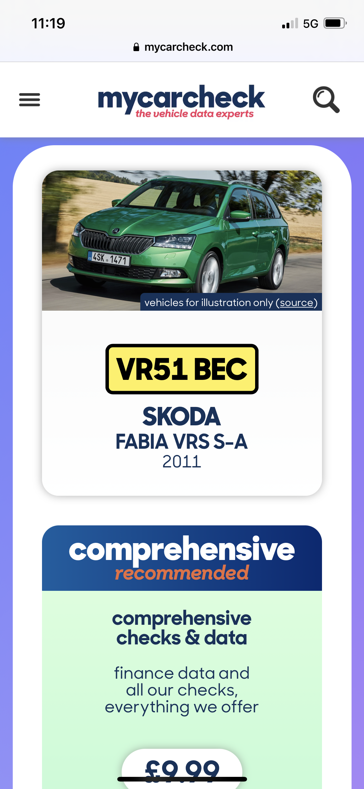

Reg number ok on Ask MID for insured but not showing on DVLA MOT checker.   Was it on a personal plate until recently?
5 minutes ago, UrbanPanzer said:
I can’t see anything in there
Just put her private plate on it VR51 BEC but didn’t think it would have changed so quick
22 minutes ago, UrbanPanzer said:
engines are not supposed to rattle full stop...............so if theres a noise thats noticable, I would be getting to the bottom of it asap and not use the car until its fixed.
Only on start up for a second if that then super quiet until this morning but typical woman it only happens to her lol
interesting regarding the link, but jsut to show it is there (although does not work if you type reg in now).............wierd

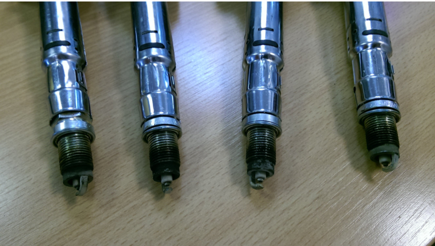

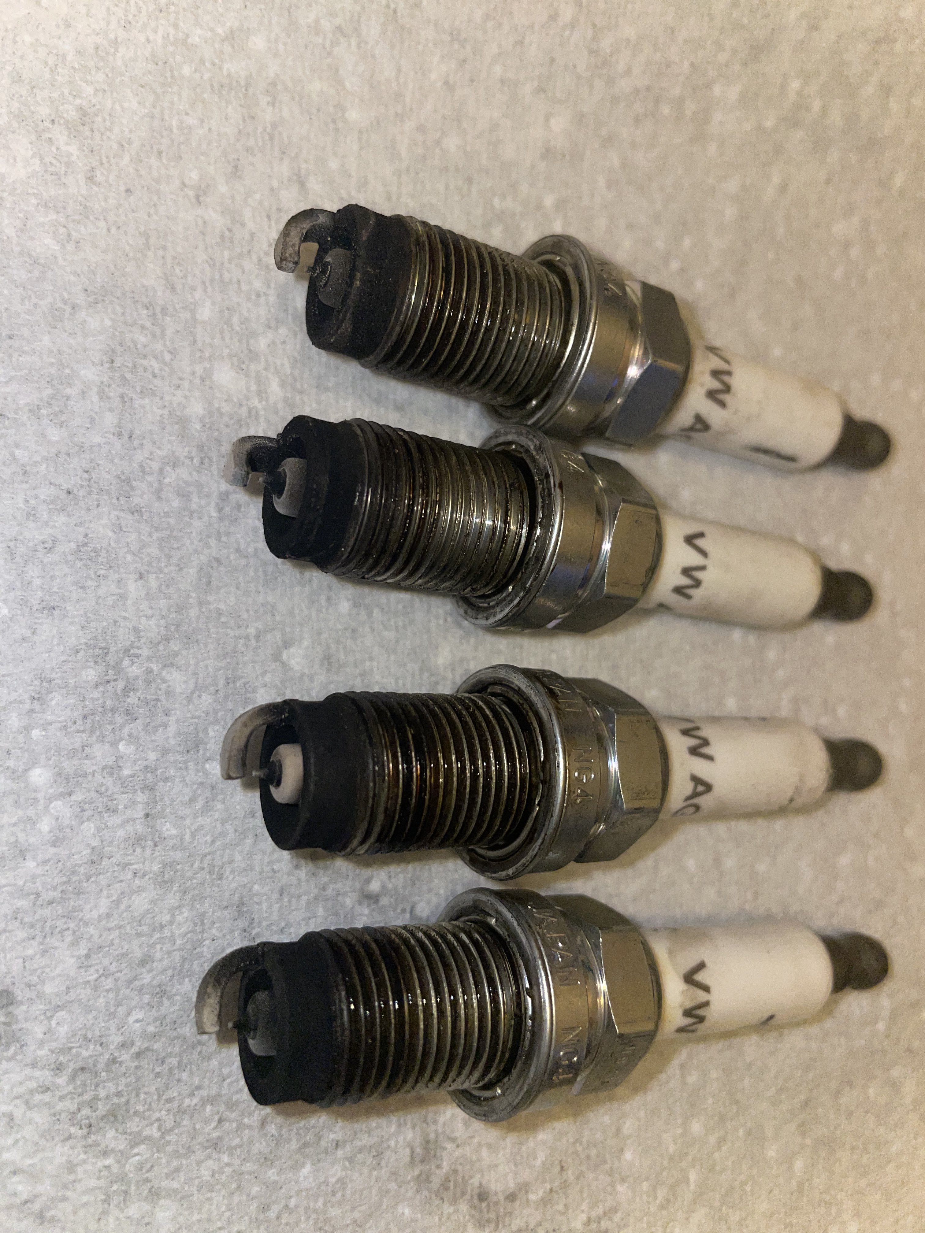

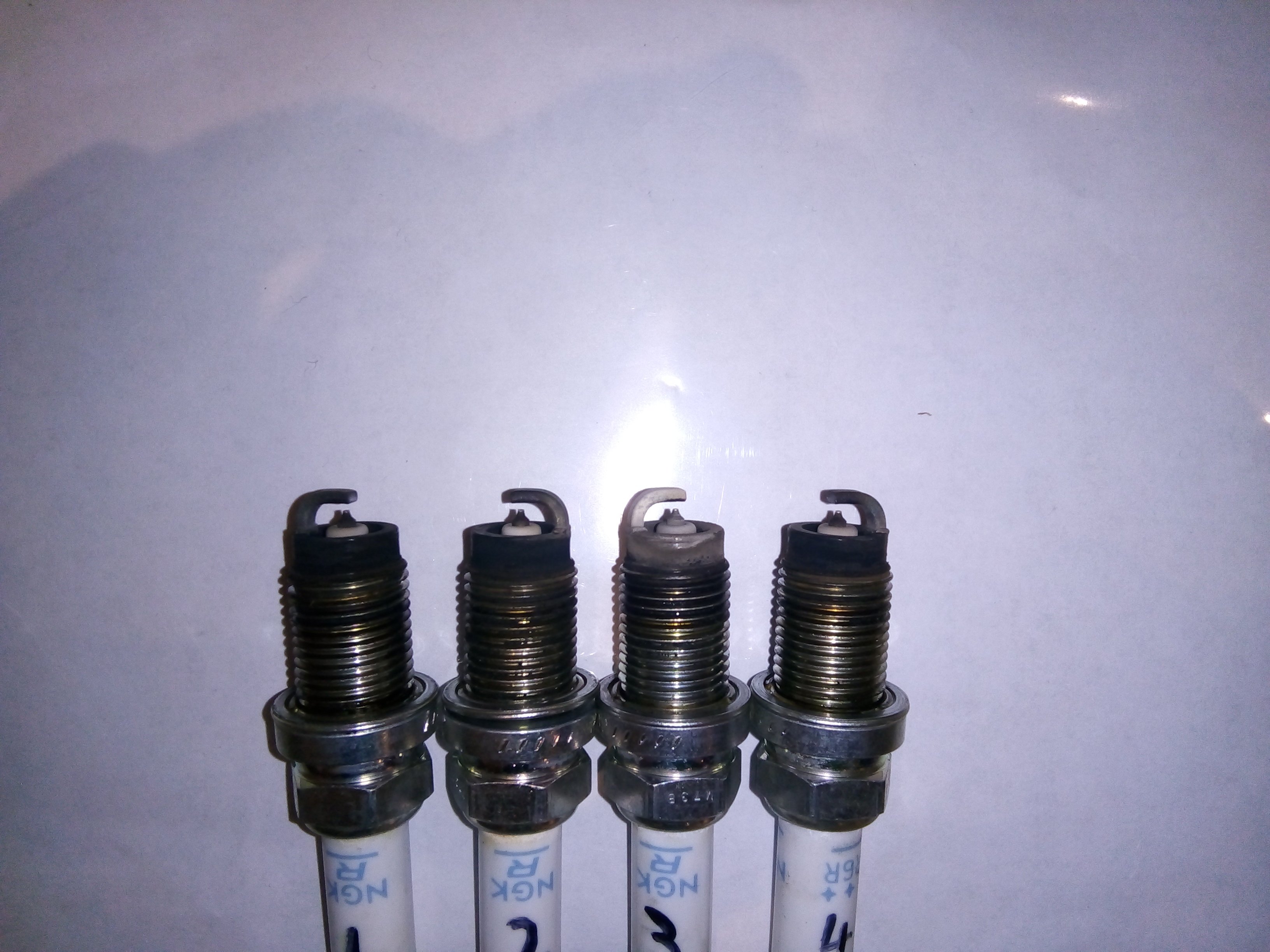

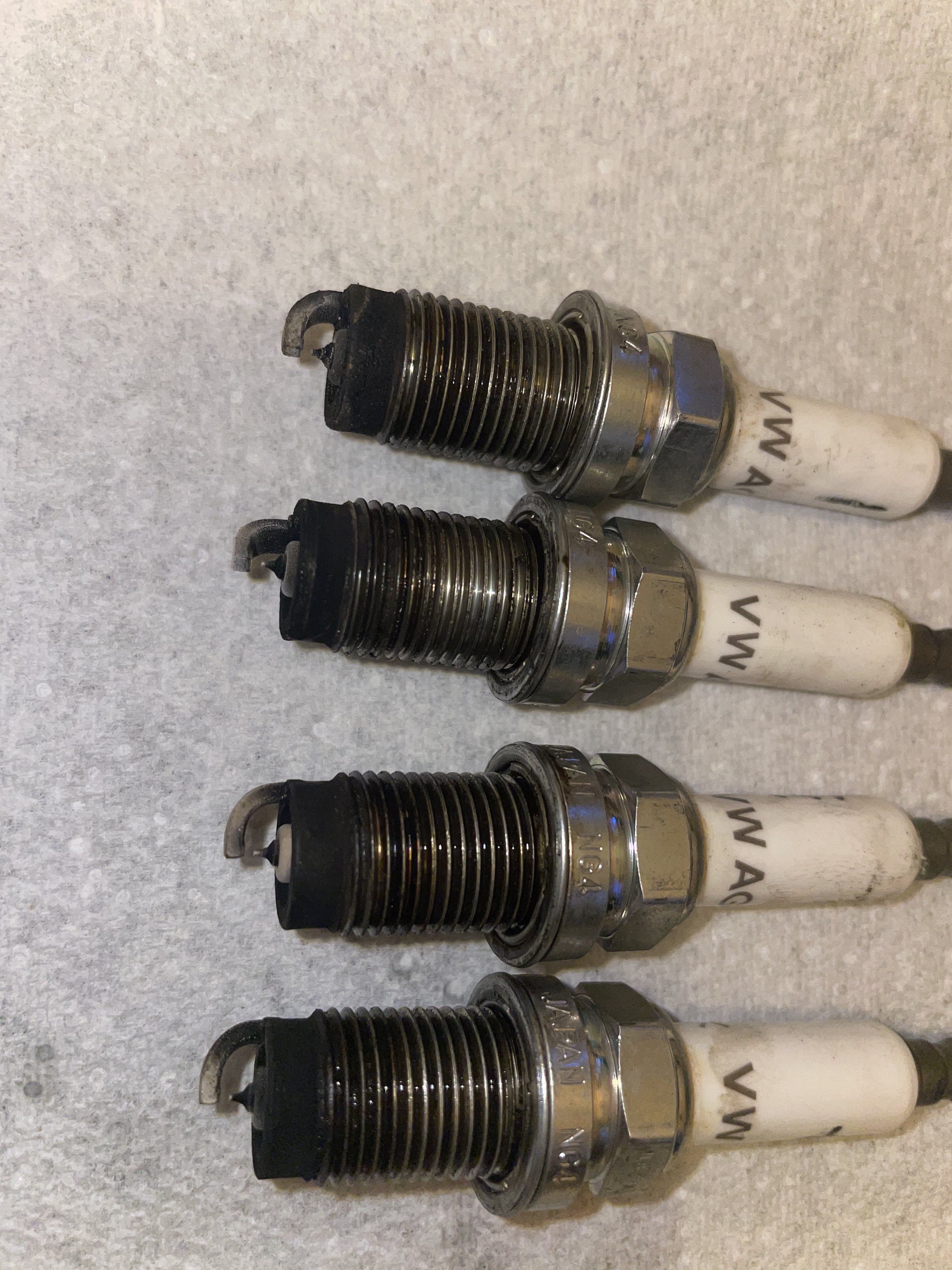

These are the plugs just removed 1-4 left to right VW AG NGK ones to me they just look like old plugs! Also it’s drank a bit more water since yesterday so might be a head gasket going doesn’t seem to be any oil/water mix in the engine or header but the sons Corsa VXR never had any either just a miss fire.
Booked in with my engine friend tomorrow so he can check the timing chain and head gasket but the water pump and supercharger bit got done last year.
Insulator on number three looks suspiciously clean, steam cleaned maybe.
Unlikely that steam cleaning would have cleaned it unless done with the Ignition Coils removed.

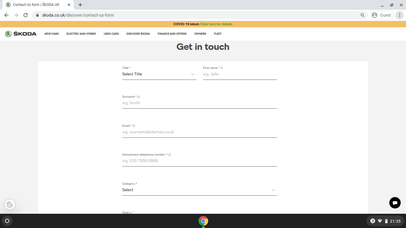

been in just over 10,000 miles son said number 1 was worst and 2 coil packs if that’s what you call them were split so he fixed those took it for a drive no miss fire and seemed smoother also upgraded air filter so it breathes better. In at garage tomorrow for head gasket test and chain looked at but pretty pleased so far fingers crossed there’s a split pipe or airlock but as long as it’s right for the wife that’s most important and it only stands me at £1500 atm well apart from plate and plugs lol thanks for all your replies and does anyone have email address for Skoda CS? Thanks

'Skoda UK contact us'
gets you what you want.

A steamed spark plug means it's burning water from a blown head gasket.
Not by a valet cleaning with a steam cleaner Captain Literal!
Looks like it is running pretty rich and at the right temp & not the usual one plug getting oiled & fouled & then cooked.
The one plug does still get hotter than the others,

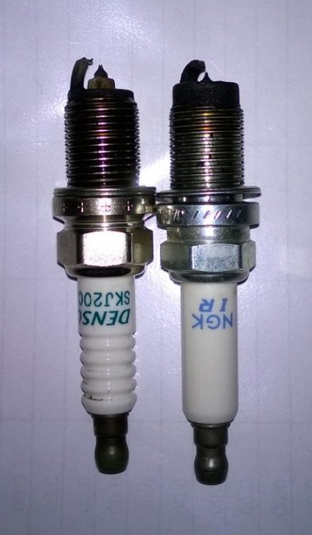

Once the car has had the issues diagnosed, find where the coolant loss is from and have that rectified and it is running right it would be good to get it on 99 ron and once warmed up give it a good long run and get the engine hot and the plugs hot and then get them out and see what they look like.
eg. No3.
