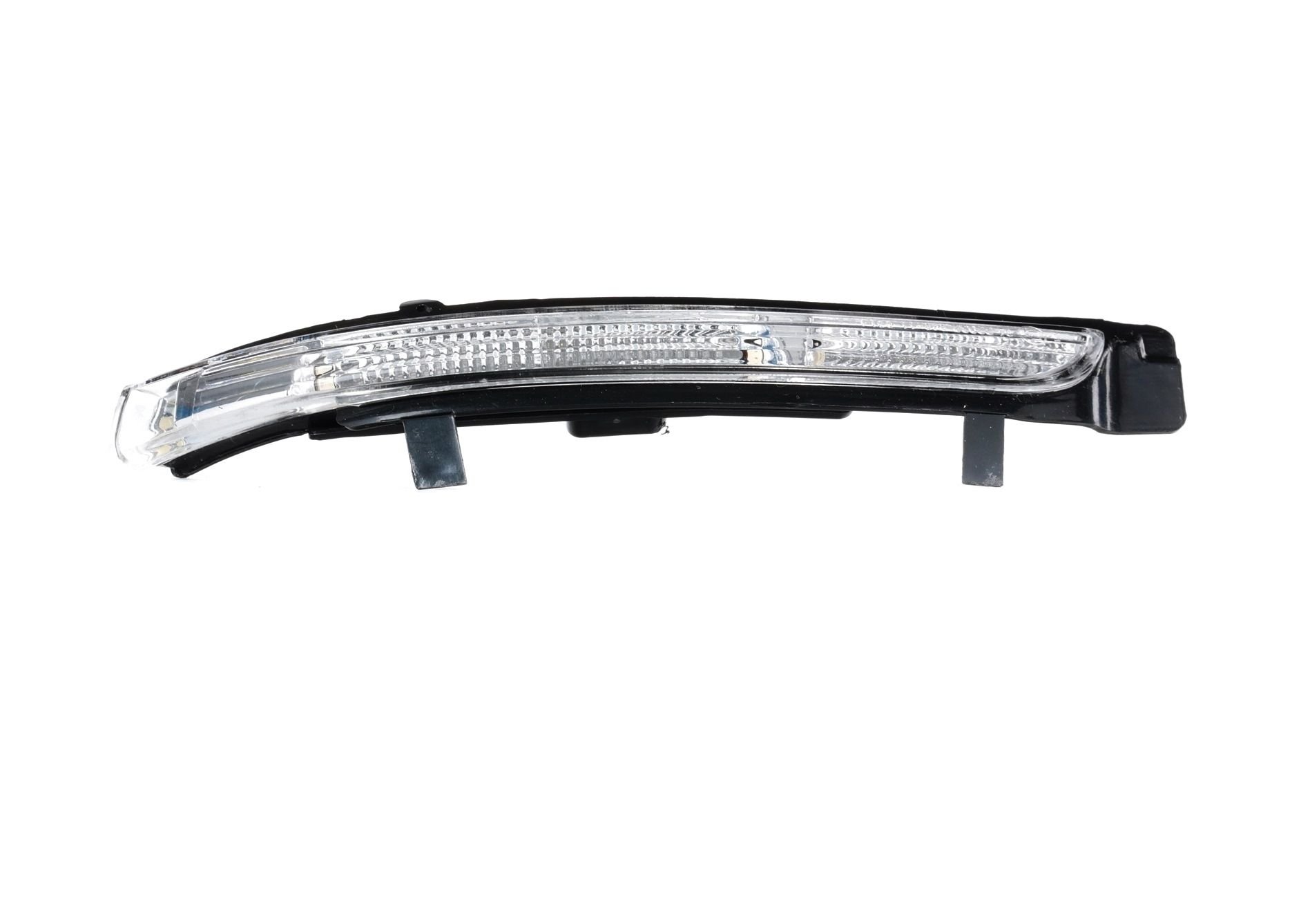

  2. Thanks, Did your faulty indicator lamp shown up with a message/warning in the dashboard...? Someone on youtube said his came with a warning. I have bought one lamp now ( As I said, I'm worried that a cable is bruken in the door...
  3. Hi My driver side wing mirror indicator light does not work at all, not with hazard light either. No error message. Does anyone know how to find out if this is due to led/lamp malfunction, broken wire, bad connection, etc? Would be nice to know before I start disassembling the mirror, and/or door (again), buying replacment light, etc...
