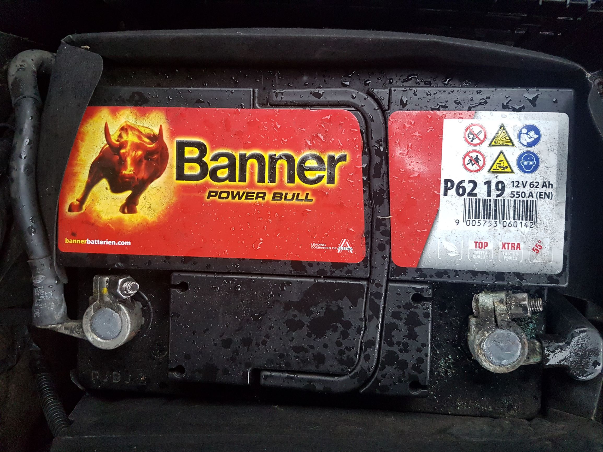

  4. thanks for your reply guys, @Piph all fuses are fine there was 1 blown on dash changed it but no difference @pikpilot ive checked voltage 9.5v and when trying to crank 5v, but we did try to crank last night that may of caused it to drain, however was quite slow i only bought car last night so no idea of battery age, ive attached pic
