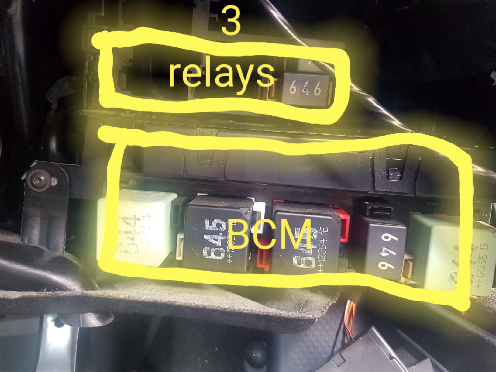

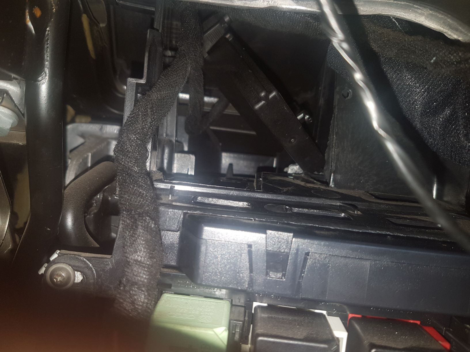

Vrs TDI warning lights on and not starting

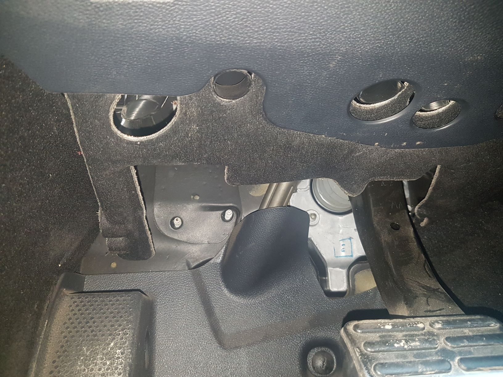

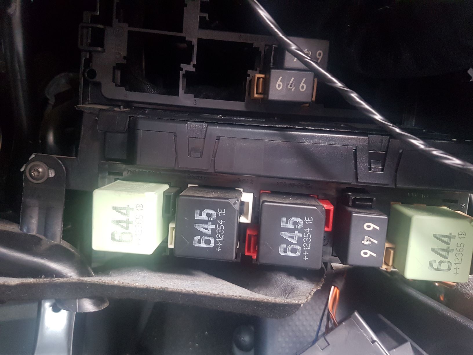

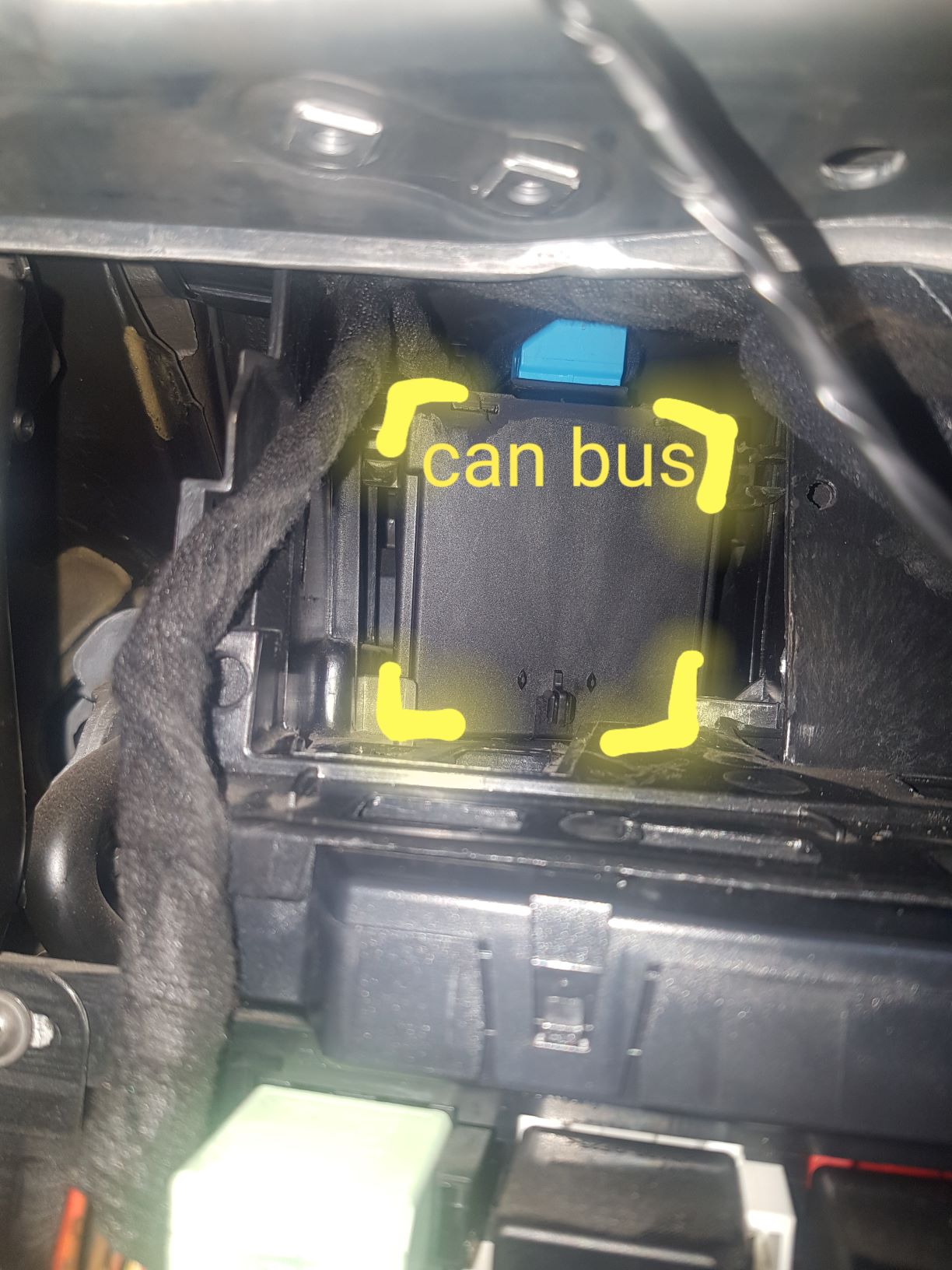

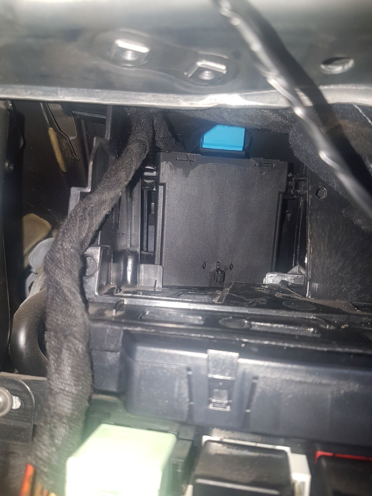

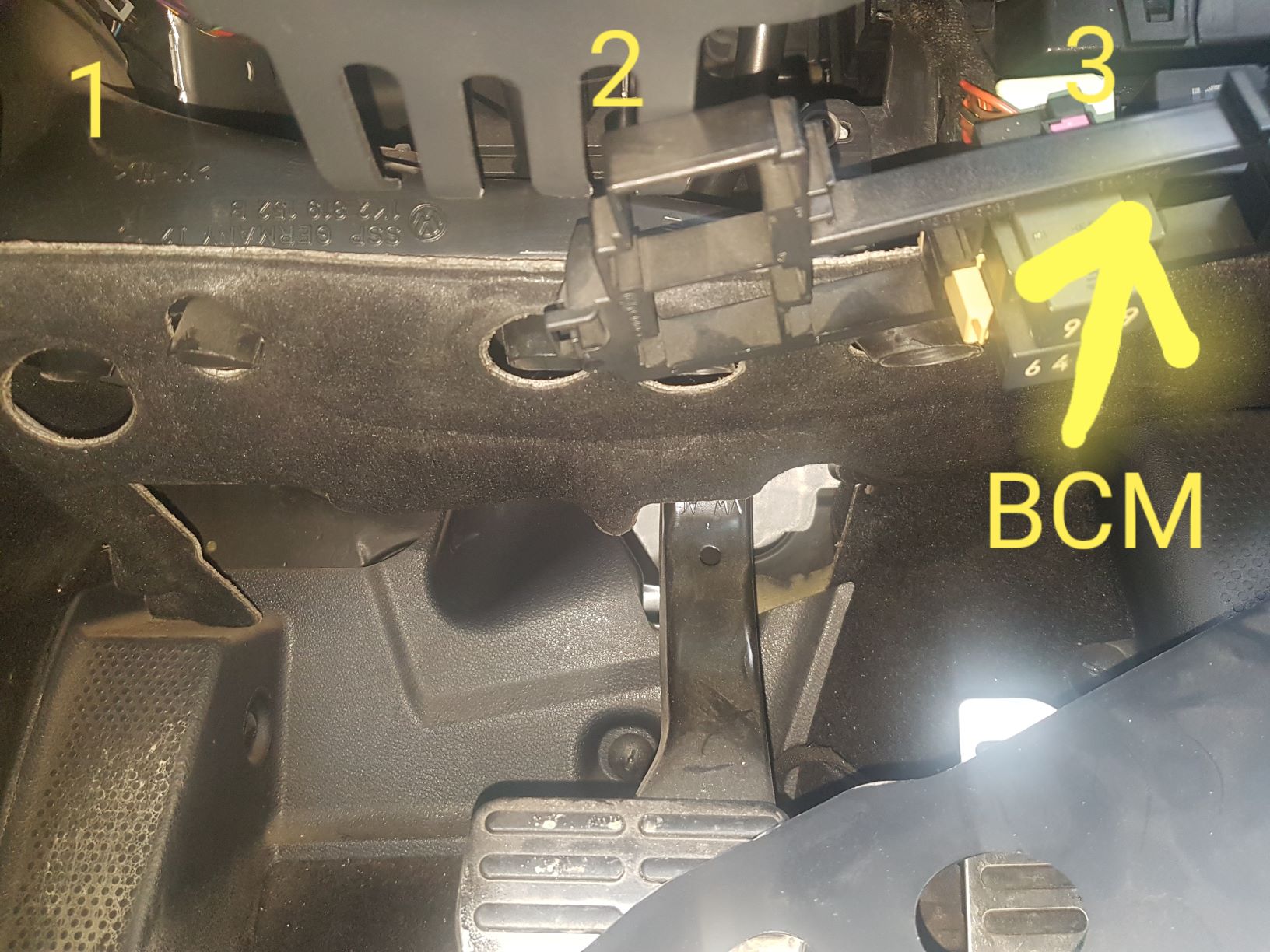

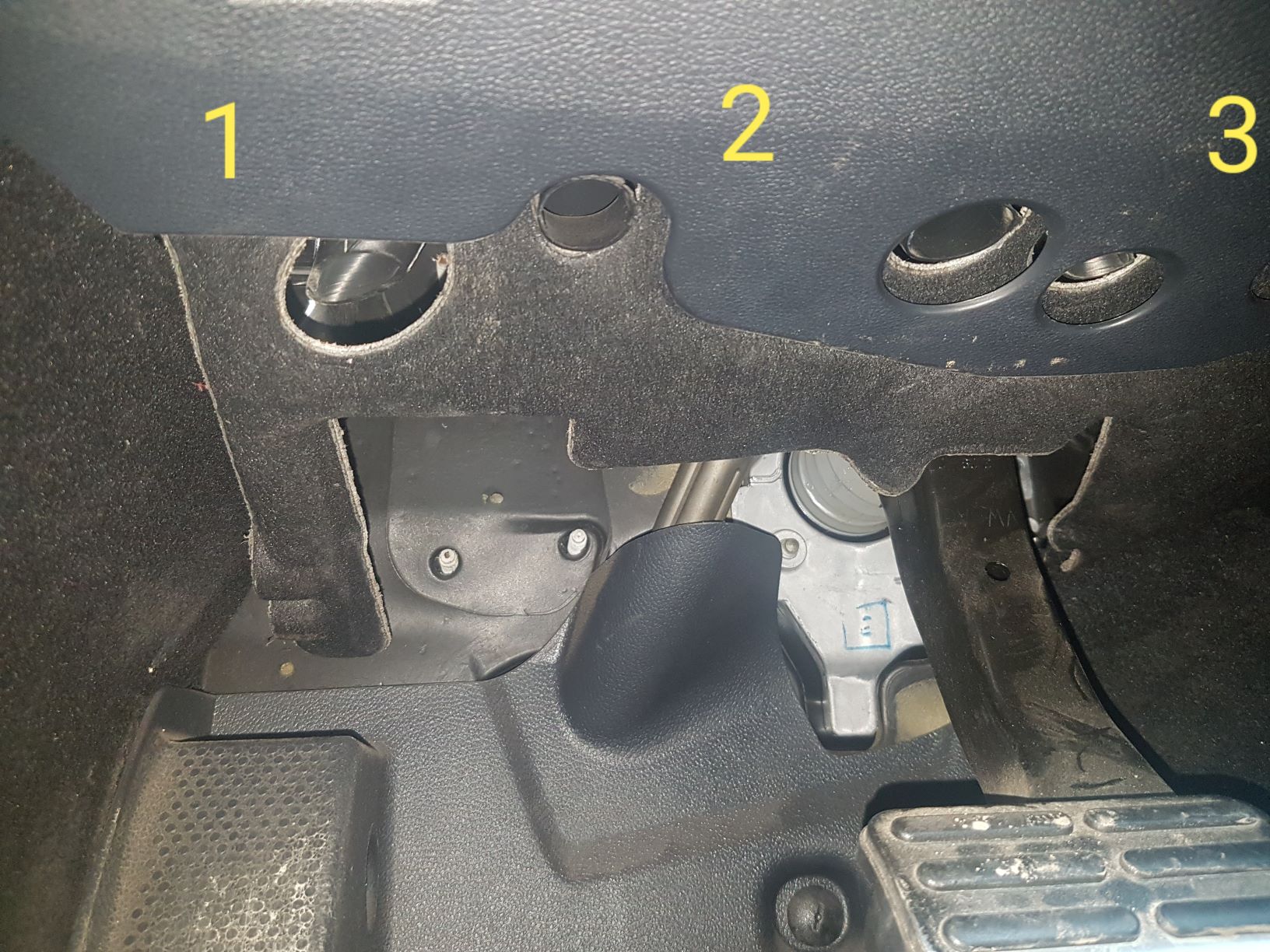

sorry was in rush had to put trim back together quickly, ive took a few photos whether they're any help or not... from the info i could find 1, 2 and 3 could be where "can bus gateway j533" is located, some have a red plug others pink or blue mine was in position 3 behind relays with blue plug, position 1 is far left flat, mine had the bracket fitted for can bus but obviously it wasn't there position 2 is behind steering column some vag cars can bus can be located pass footwell, behind glove box/in scuttle or anywhere random apologies if info is incorrect any questions i'll gladly help cheers
ive had hose pipe on windscreen, scuttle and door, i put tissue on top of module, tissue didn't get wet and i couldnt see no drips so think going to go to a car wash and get jet wash on it or check on a rainy day, however the fuse box on side of dash had water marks and white residue so i think maybe the door seal might be dodgy mine was mounted above pedals behind the relays above the onboard supply control unit at the back standing up, im guessing the water was running down the cable/plug into the gateway, ive not put the trims back together yet as ive been doing testing, ill take some pics tomorrow during day,
just thought i'd update this thread after so much messing around and going through this forum day and night reading random stuff, it turned out to be the can bus gateway it was wet cleaned it up, sealed it connected back up and boom fired instantly im looking for a new one now so this was defo the problem thanks
