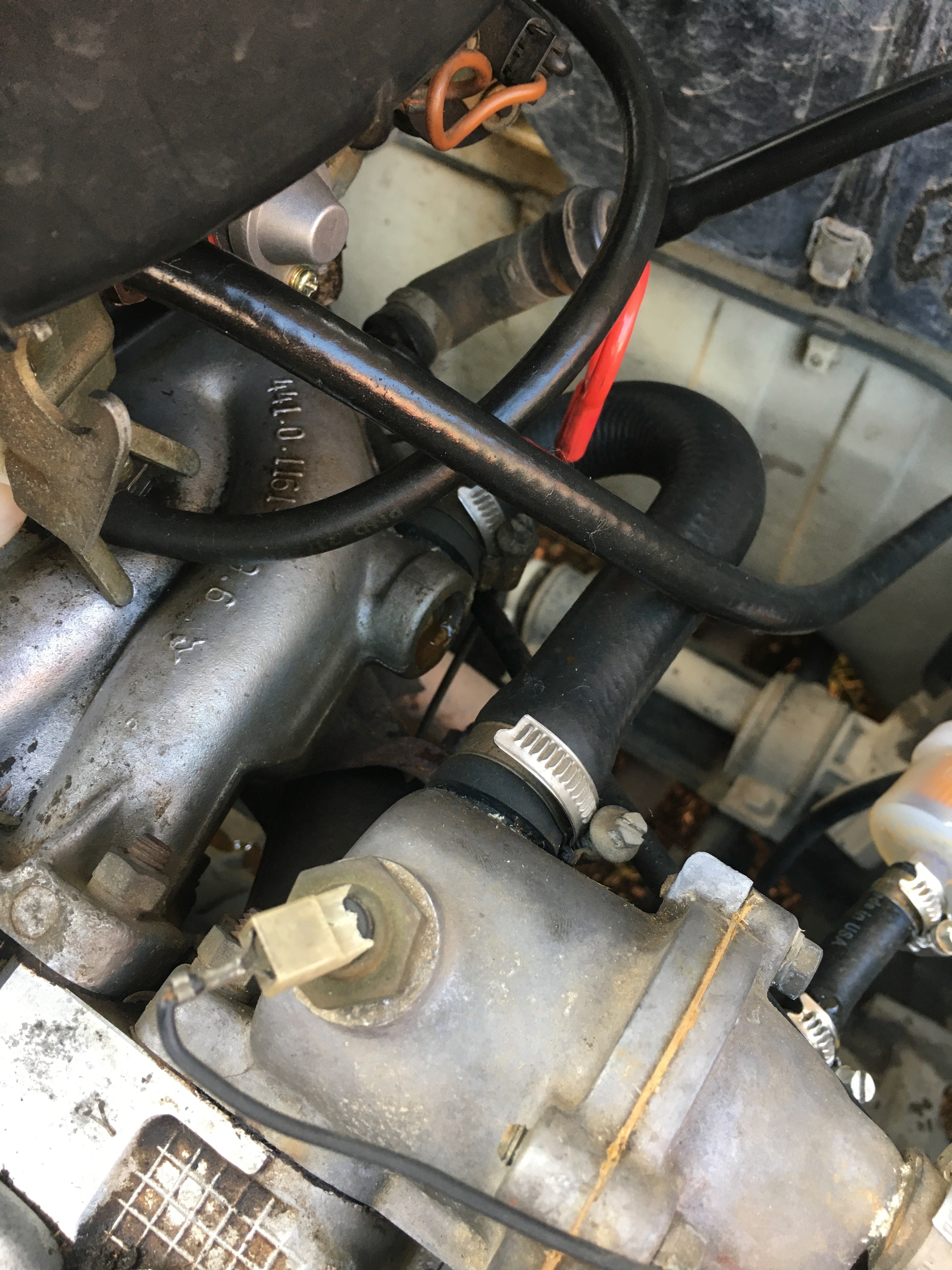

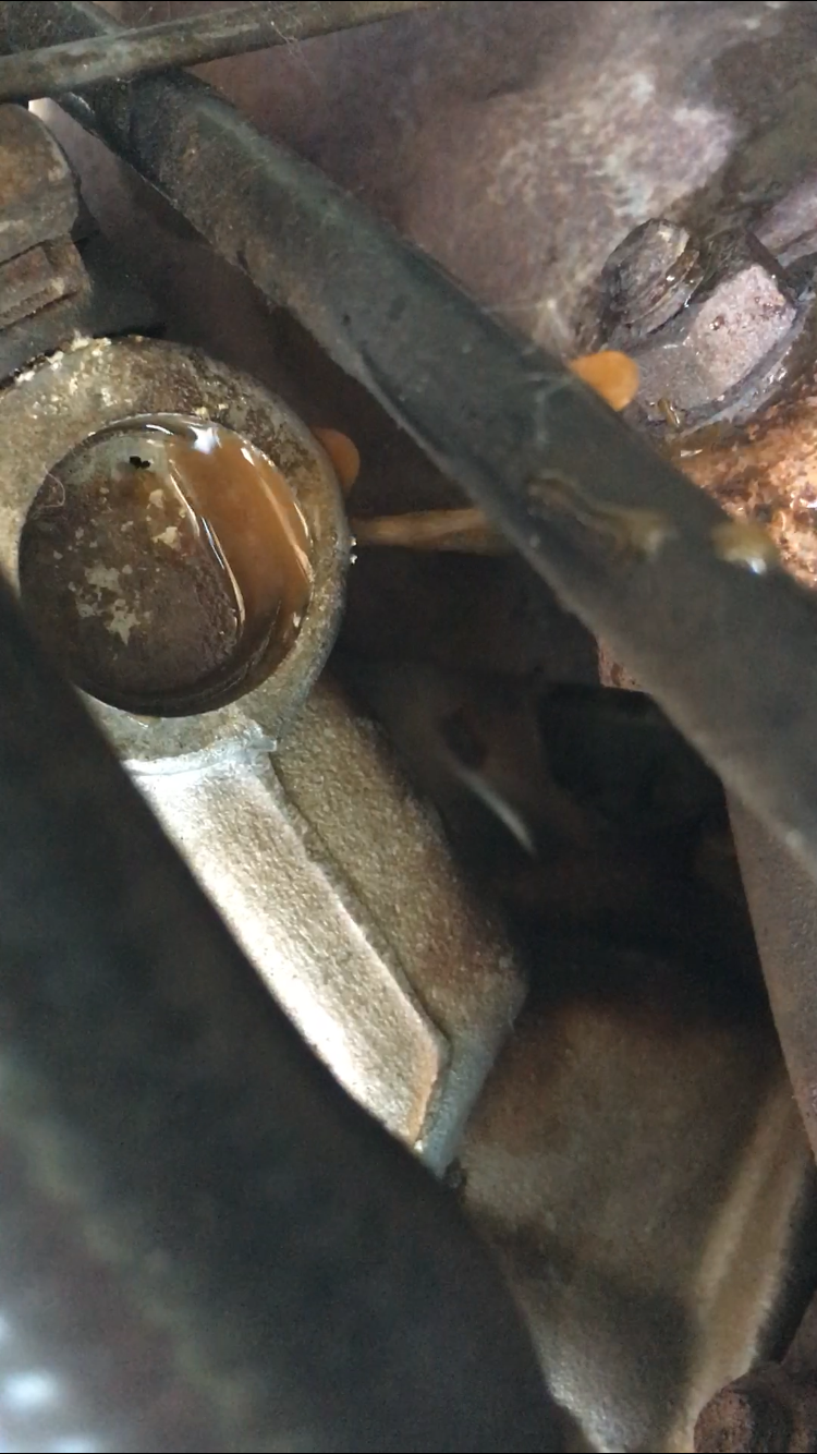

Skoda Forman: Coolant leaks from intake manifold
NichiBlembom replied to NichiBlembom's topic in Skoda Favorit, Skoda Felicia, Skoda Fun and Skoda Formanyea you're right. it's just those worries that keep me up at night
NichiBlembom replied to NichiBlembom's topic in Skoda Favorit, Skoda Felicia, Skoda Fun and Skoda FormanI was tempted as well and I did it. I tried to just epoxy the plug itself so that it could still have the function of the frostplug, but I doubt that it will hold until it gets cold again! I will see As I said. Removing the Inlet Manifold requires removing the Exhaust Manifold to renew the gasket. If the studs on these strip (and I have seen those strip on newer cars already), its Cylinderhead reworking time. Thanks everybody and especially R_Blue for your input! I ordered a new plug already and will try and bang the old one out of there with the manifold attached. Can't wait to find out what kind of problems that will cause Thanks for the positivity! Hope to read more from your Forman project aswell!
Hi again! My Forman is taking the **** again (this time literally). Fixed a couple of things. First the carburettor, vacuum leaks, then the brakes, fuel lines, fuel pump, oil pan, then carb again because of insane amounts of dirt in the fuel tank. Now when I thought that I am finally good to take it for a longer trip it started peeing lots of coolant from the intake manifold. On the pictures you can see from where it comes. Unfortunately its not a hose, but the metal part of the manifold (I guess it is a frostplug?) is heavily corroded, has hole and leaks brown rusty and smelly coolant. The coolant looked alright to me a couple of weeks ago, I had it parked because I didn't have time, now it looks like this, which I find rather strange. . Anybody here who has had this same problem? Do you think I could somehow fix it with some sort of gasket glue, or silicon? Changing the manifold is not an option for me at this point, since the studs look pretty rusty and probably will strip when I try to replace the gasket, which seals intake and exhaust manifold. Right now I would like roll it in a ditch and get something air cooled rather than rework the head. Hope to read something positive from you guys Greetings, an enthusiast thats not being treated well by his Forman
