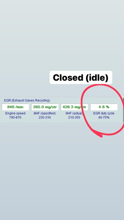

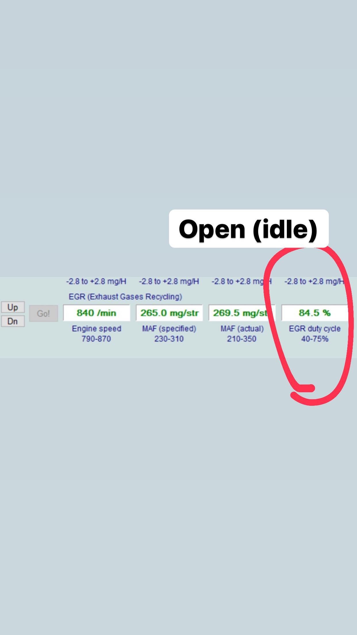

  1. Hi Folks Today just check my 1.9 BLT with VCDS and got a few readings from EGR , I was suspicious cause after a ride when I leave the car a on idle the EGR is closing after 1-1.5 minutes , so just check it and it says attached the readings is it good or not really ? if not what causes. also when it is closed. MAF reading is a bit out of the normal range ? Thank you
