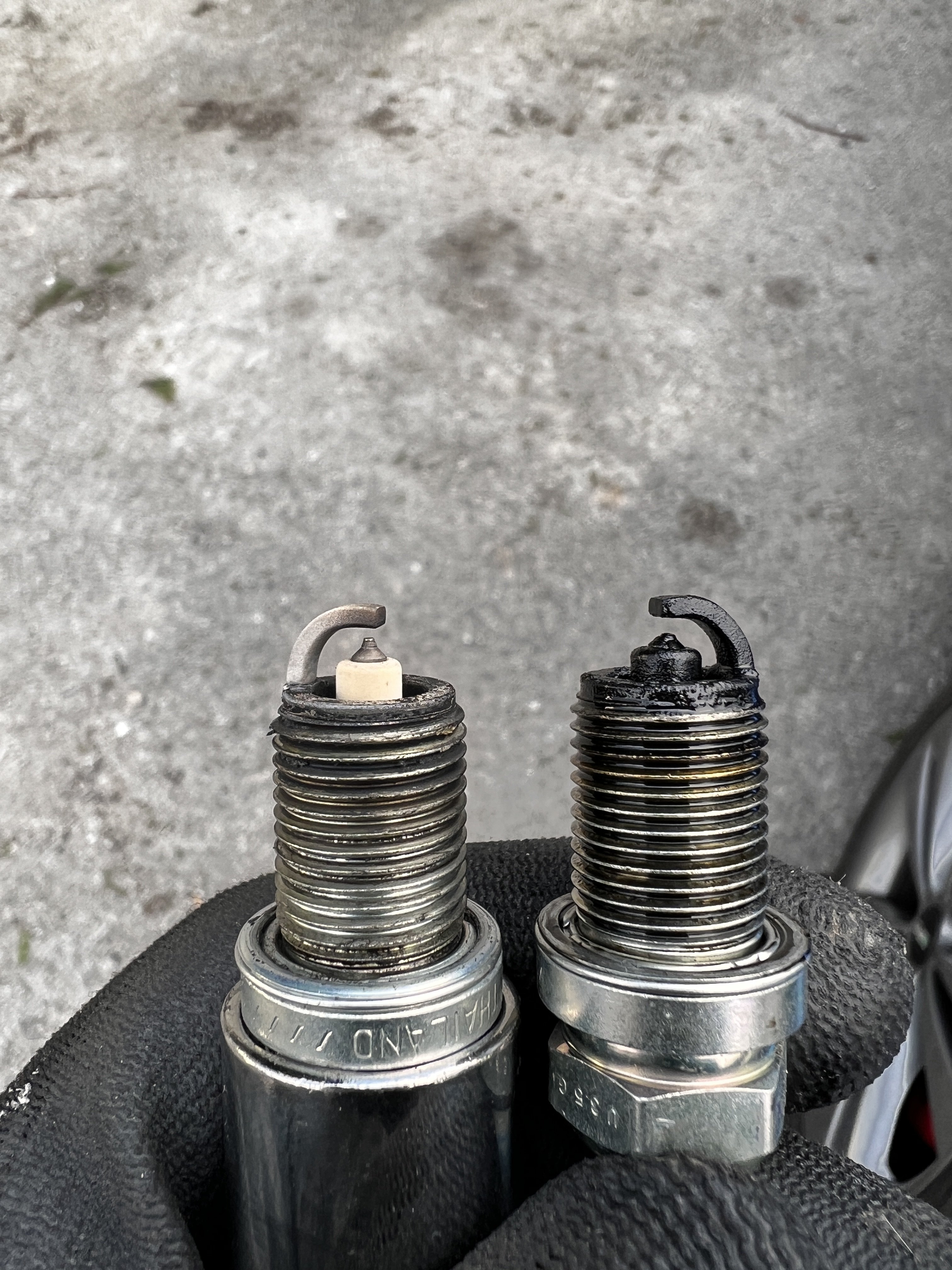

I’ve had this issue for a while now the car has been back and forth to the garage, who I’m now sacking off started with a valve/intake clean to resolve a carbon build issue the car ran for a week, really well, then threw an injector! 4 new injectors, a set of plugs later this then started the back and forth! seems the inlet manifold gasket wasnt changed and it looks like there was an air leak causing overfilling (I’m guessing) which caused the plug to foul, then burn the plug when removed, smelt of petrol! pressures across all 4 cylinders were spot on and in balance if i put a new plug in, it will run fine but when I’m coasting, or at a slow, steady speed, it will happen again! I’m on injector set 2 swirl flap mech was changed this last time, new injectors, manifold gasket, and plugs! im going to try and sort this myself this time as I’m not letting the original garage anywhere near, and I’ve not got the cash to start again with a new garage! was going to strip the inlet manifold and work from there any pointers / suggestions most welcome!! pics / bad plug and normal for comparison!- 2010 VRS petrol misfire/hesitation under light acceleration

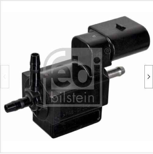

Hi mate Oh no!! lol Turns out I needed a full intake clean, that sorted it.. then an injector went.. so intake off again... then a swirl flap issue.. which is ongoing!!!! Main problem was intake carboned up... been running on E5 too... so if youre on E10.. worth a look - and dont bother with those companies who will come out and do a carbon clean.. utter rubbish... Good luck- Swirl flap solenoid pic?
The manifold was replaced before I got the car 2 1/2 years ago It was a VW genuine one from the receipt I have I have had it off and cleaned recently, then off again following a injector failing 2 weeks later! I would have noticed this wasnt connected to anything before this work was done! so not sure whats gone on! Thanks Guys My garage were looking into this for me as the assumprion was they had 'lost' a pipe!! Appreciate the help- Swirl flap solenoid pic?
Interestingly, I've found this on ebay - listed as a for a Skoda Superb - this is exactly what I have.. so perhaps... its the wroing part for my car!!- Swirl flap solenoid pic?
Thanks, I'll have a look and post some numbers later 🙌- Swirl flap solenoid pic?
Thanks the vac pipe coming off the engine, is fixed to the back of the solenoid there are 3 ports it seems the one missing is the one that’s fixed on the rear not the front bit then there is a ‘spare’ with nothing obvious missing! 🤷🏻♂️ - Burning plug in cylinder 2
