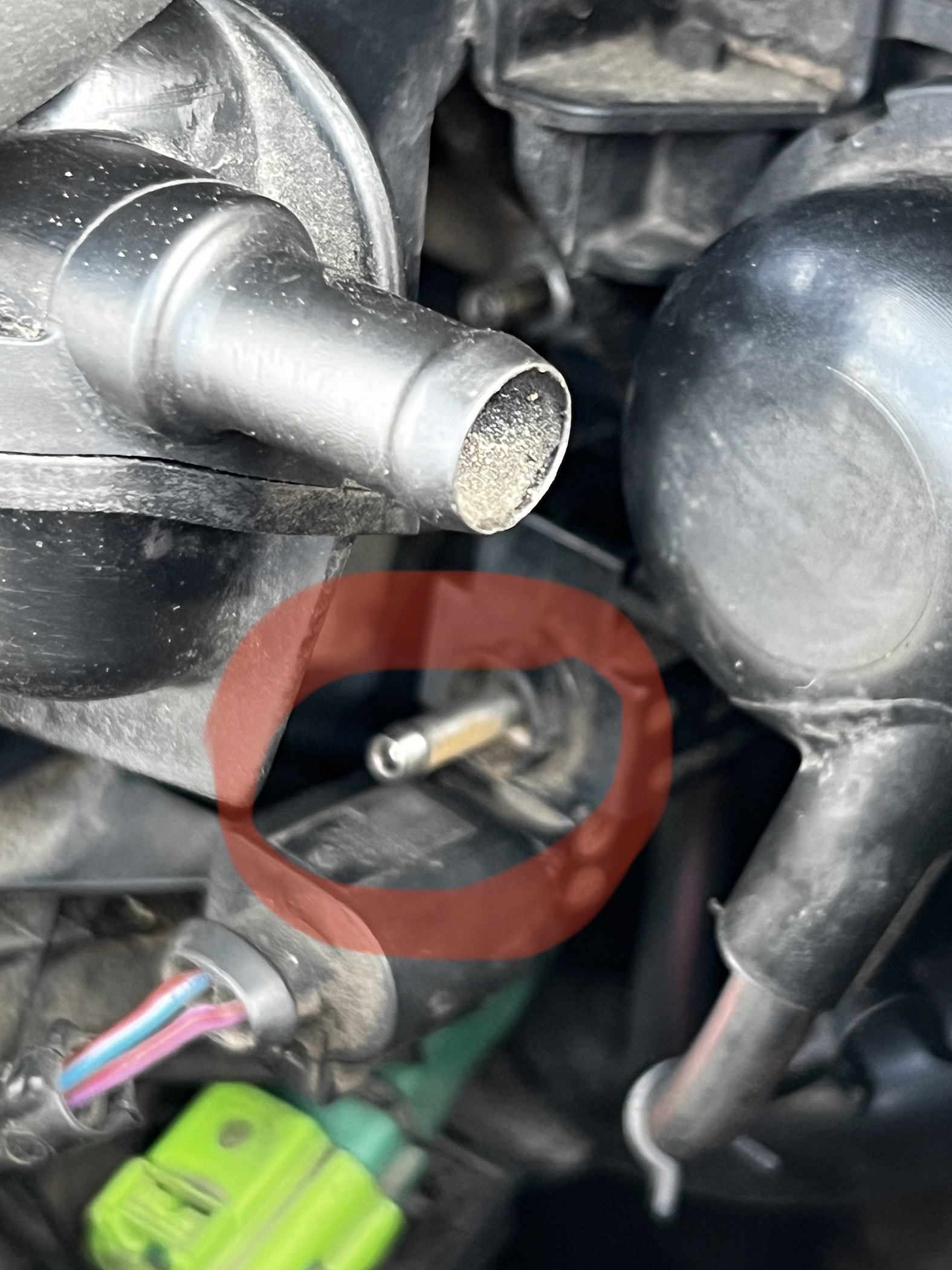

  14. Thanks the vac pipe coming off the engine, is fixed to the back of the solenoid there are 3 ports it seems the one missing is the one that’s fixed on the rear not the front bit then there is a ‘spare’ with nothing obvious missing! 🤷🏻‍♂️
  15. Sorry, no the small bit from the swirl flap solenoid…
  16. I’m missing a pipe after some work! It’s getting sorted… can someone drop a pic over showing what connects where please? I’ve got an ‘in’ pipe at the back, then and ‘out’ pipe coming off the back also… leaving this one at the front!
