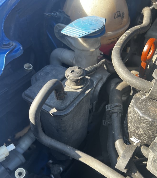

I've just had mine diagnosed as the Evap purge valve
I disconnected it and the hesitation went, new one going on tomorrow!

I was delayed in looking into this further by a house move and warmer weather making the problem go away! Did the purge valve replacement fix your issue? If so, I will grab one, it looks relatively easy to fit from that photo, was that the case?
