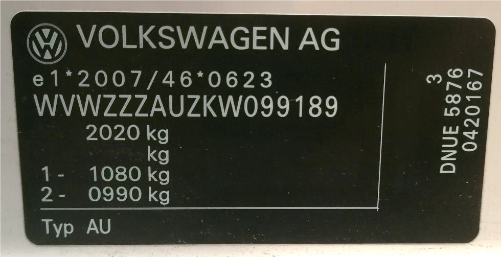

Axle load vin plate location
Thanks Langers, somehow i missed it as it is literally behind the rear door as you have shown. usually they are in front of the pillar.
Hey all, I am wanting to know where the similar plate is on a Mk3 superb ? Usually on or around door pillar but i cant see one does anyone know where it will be? Or even how i can find out my load rating for my front axle so i know what eibach springs to buy.
