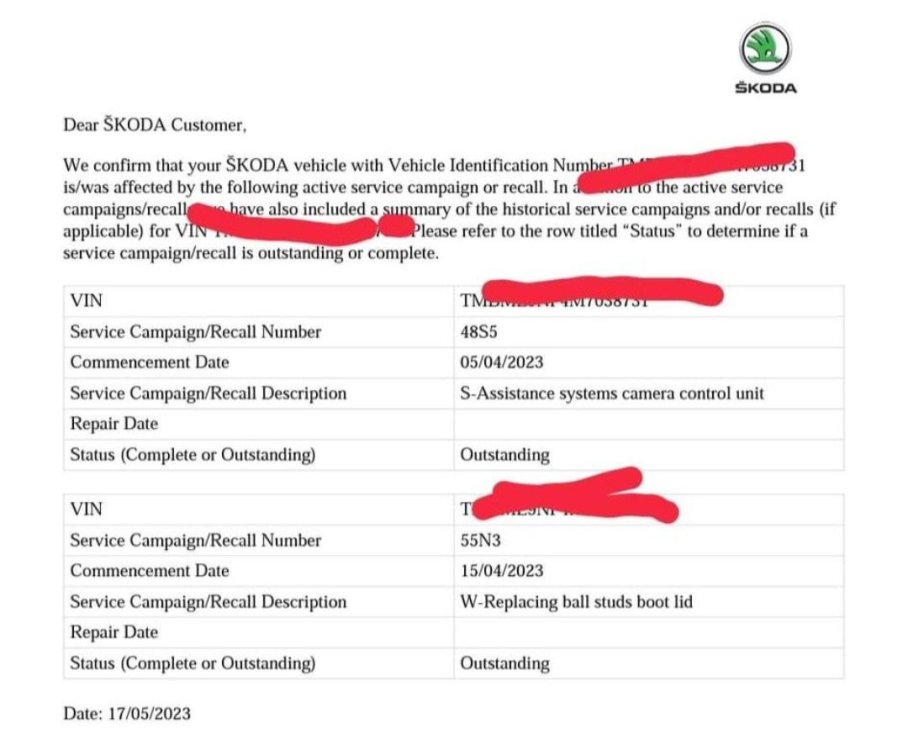

There is known service campaign recall on the facelift Superb wagons for weak/faulty boot strut hinges.
Recall No. 55N3
1 hour ago, JR RS said:
+1
Recall No. 55N3
https://recall.skoda-auto.com/004/en-com
Thanks JR RS just checked for recall on the above link and sadly i am not in that recall
