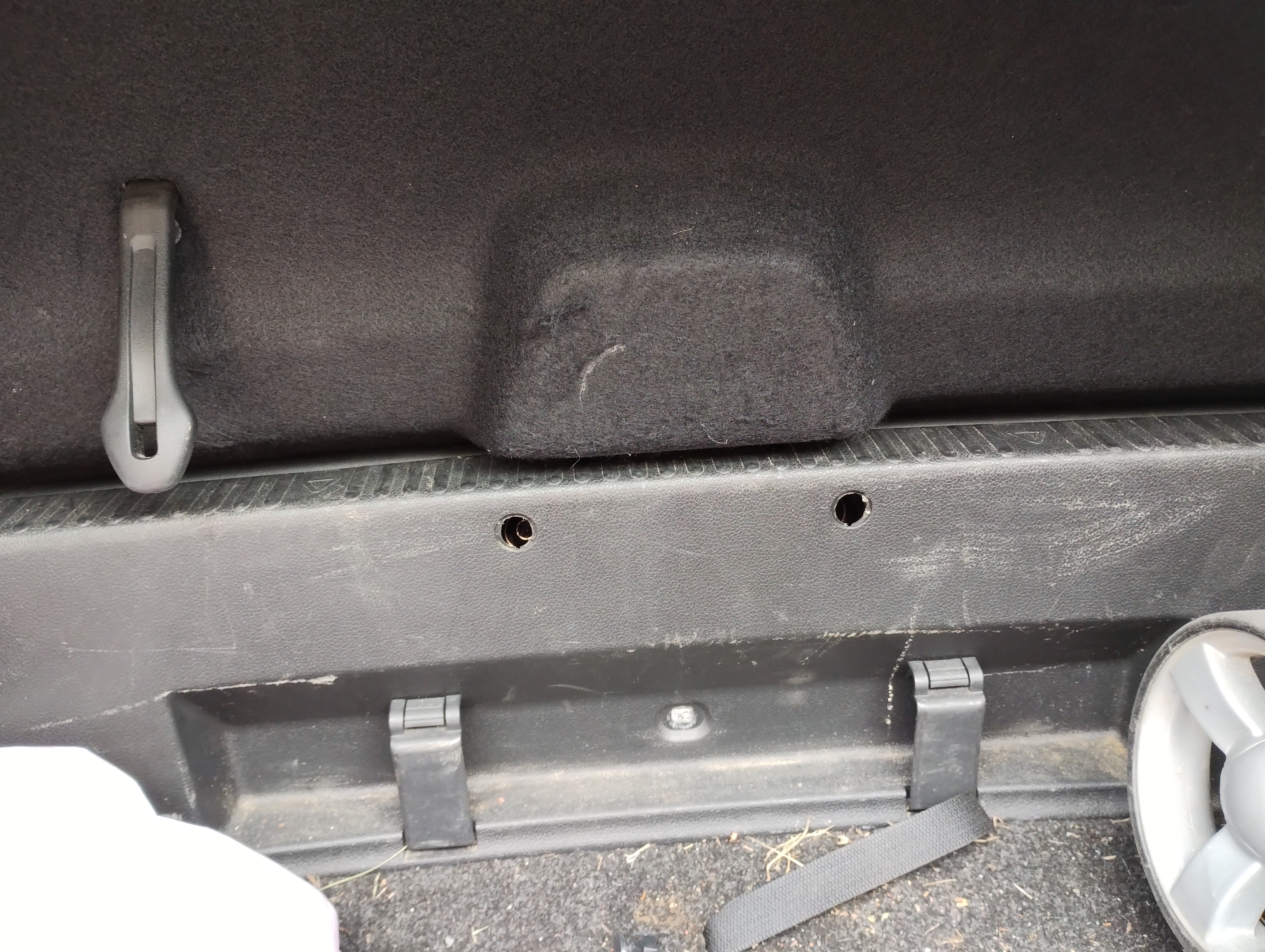

  8. Hi, My car boot lock seized and using the emergency opening mechanism from inside the boot (the little hole for a screwdriver) doesn't help. is there a way to remove the lock mechanism from inside so that I can open the boot and replace the lock? I have a Superb hatchback, no electric tailgate.
  9. I cut the fabric open to see the emergency release mechanism and I was doing everything correctly, it's just that the lock seized up and won't open. Would anyone here know how to remove tlocking mechanism or have a workshop manual? These are the pics I took. I tried to remove the big plastic trim with two visible wholes (there are screws there) but it is kept in place by the very locking mechanism
  10. thanks a lot, I tried the above (pic on the left) and I can feel and hear that the screwdriver is picking something on a spring but unfortunately it didn't help. I'll need to cut the fabric with a sharpie to see what is going on there.
  11. Is there a way to open the boot manually, e.g. from inside the boot? Mine stopped opening although I can hear the mechanism click when I press the relevant button in the car, on the lid or the car key.
  12. Hi my boot doesn't open anymore. I can hear the mechanism clicking when I use the console button /key fob / button at the boot but nothing happens. Is there a manual way to open the boot from the inside? It's the manual boot, no camera. Pic form inside attached
