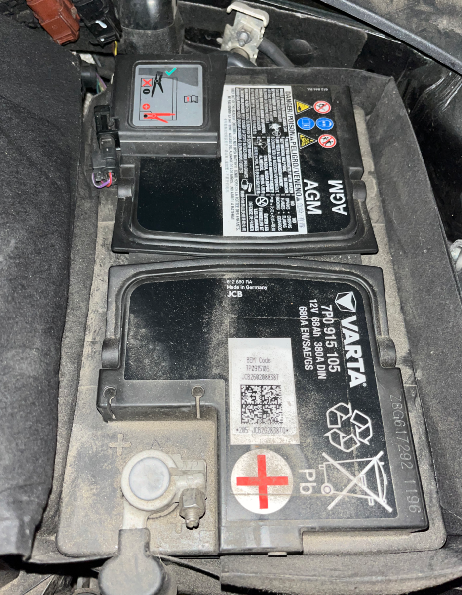

Hi, My car has displayed multiple low battery voltage warnings over this winter yet it always starts on the first try. I just had it serviced a month ago - the battery was tested and found to be fine. This is similar to previous years, also warnings on cold days yet no issues and the battery always passed the service check. The car is 7 years old now and according to my knowledge is on its original battery, but then it was 2 years old when I got it. Is it time to replace the battery? Can I check the voltage of the battery using ODB11 Scanner which I have? Note - I always turn the start stop function off and I live in Ireland where the climate isn't the harshest
