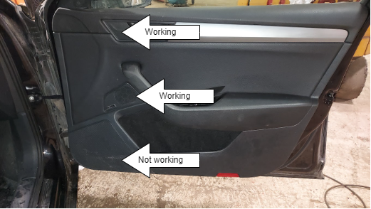

  2. Have anybody knowledge about the amplifier? Where its located, is it changeable without programing?
  3. Update: I have discovered that the lower speakers are moving and playing sound, just very very low. And I think its like that in all doors. I tried to factory reset the sound sending with no luck. Could this be the amplifier? Can he be changed without coding?
