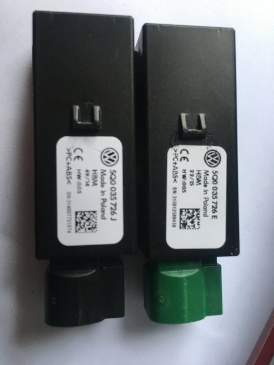

My issue is that the USB connector has stopped working so does not recognise memory sticks or iPhone and no longer charges phones.  Have tried various cables and iPhones - all behave the same way.
I have done a system reset with no change
Iam hoping that a system software reflash or upgrade might fix this.    Is there an upgrade that I can apply?  Do you think that might work?
Any other Ideas?
cheers,  Trevor
It’s more likely the USB has stopped working. 5Q0035726E is the part number you need.
Thanks SashaGrace.  So the USB interface has its own replaceable module?
Any suggestions for the best place to get one? Prefer new to used I think.
Or instructions how to get at it?
Cheers
Trevor
First thing is a scan ideally so you can look out for a fault in the external media connection. If such a fault is present I would replace the USB with another. Can get them new on AliExpress or used on eBay. You need to take the radio screen and climate panel out and then the USB clips into the lower dash trim.
SashaGrace I see that there are lots of these available on the web, on ebay from China with "made in poland" sticker and second hand from lithuania...  China looks the cheapest to me.
Had a look at the car and can see that you are right about getting access to it.  Fun.....!
I did do an Auto scan with the latest VCDS yesterday and there were no media errors.  Thanks for the suggestion to do a chanel map of controller 47 and 5F before I start, just in case
Cheers and thanks again for your help.
Trevor

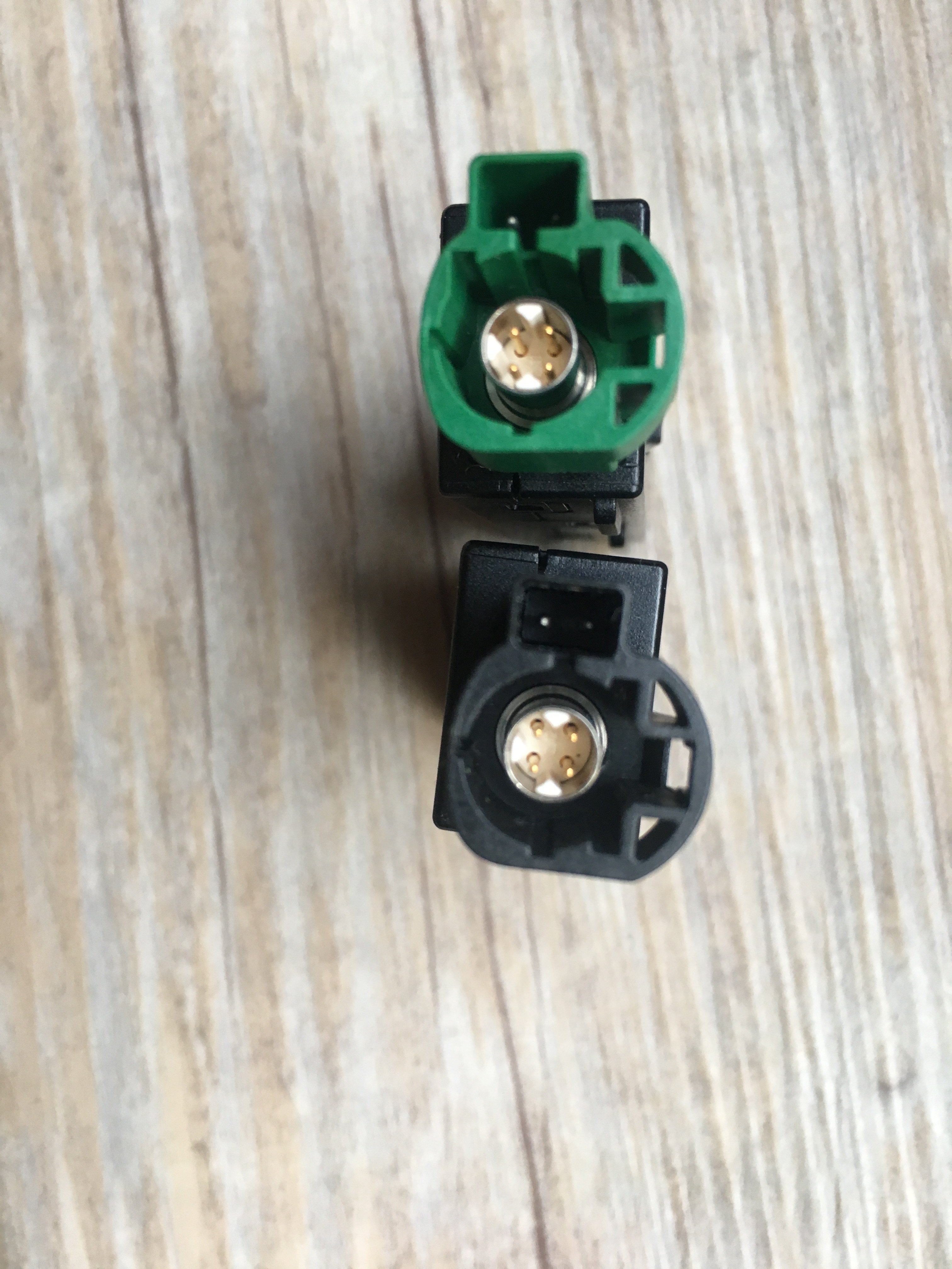

Problem is that the part I purchased was listed for a Golf with the suffix J instead of E and has a different plug..... 😒   My Bad for not paying attention to the detail.!
Guess I will have to look further for an E variant..
Trevor
SashaGrace, They are available on AliBaba for about US$35  but I will get one from the local dealer for about A$105.  pick it up next week.  I will let you know how it goes.
Trevor
Try it; might work. I know the E suffix ones work.
It has a different shaped socket so cannot be used..☹️

SashaGrace, I have finally got the correct part from Skoda Australia - $A106 - and have fitted it today.  Voila!  it is all working correctly.
Thanks for your help with this.
