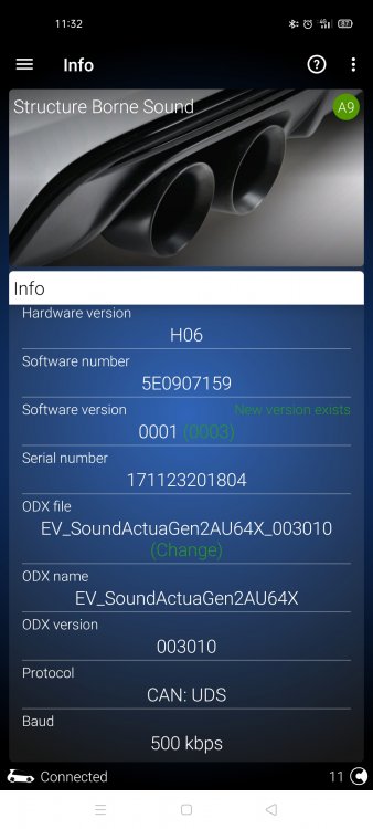

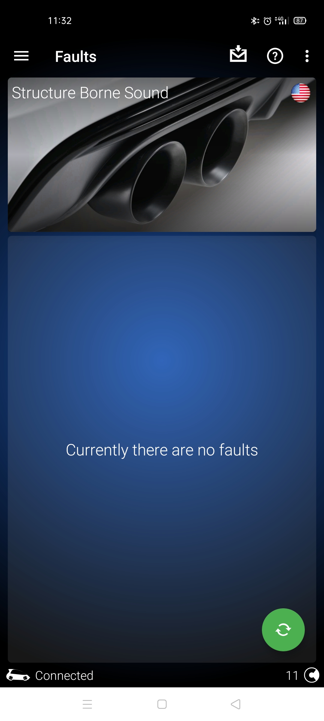

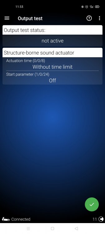

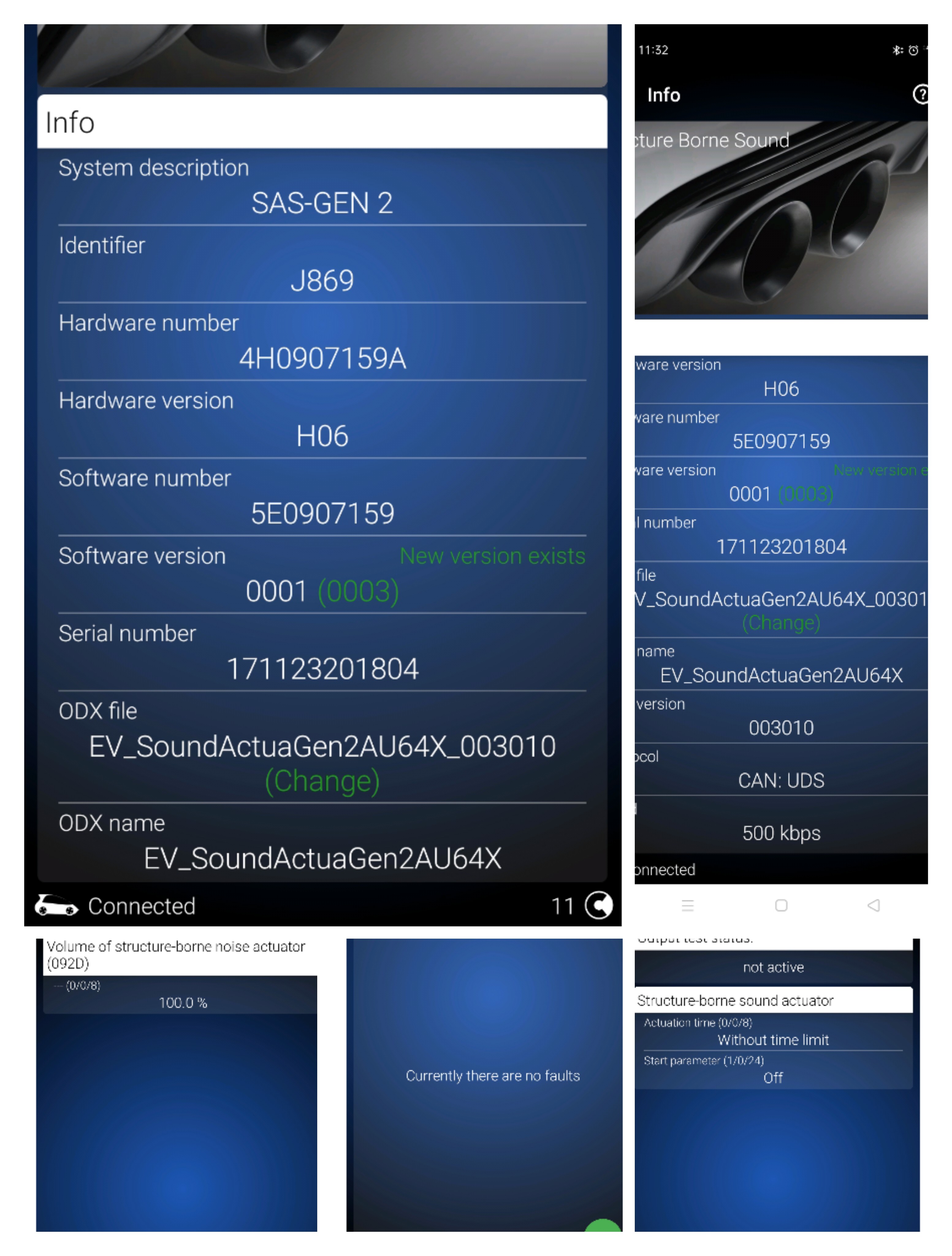

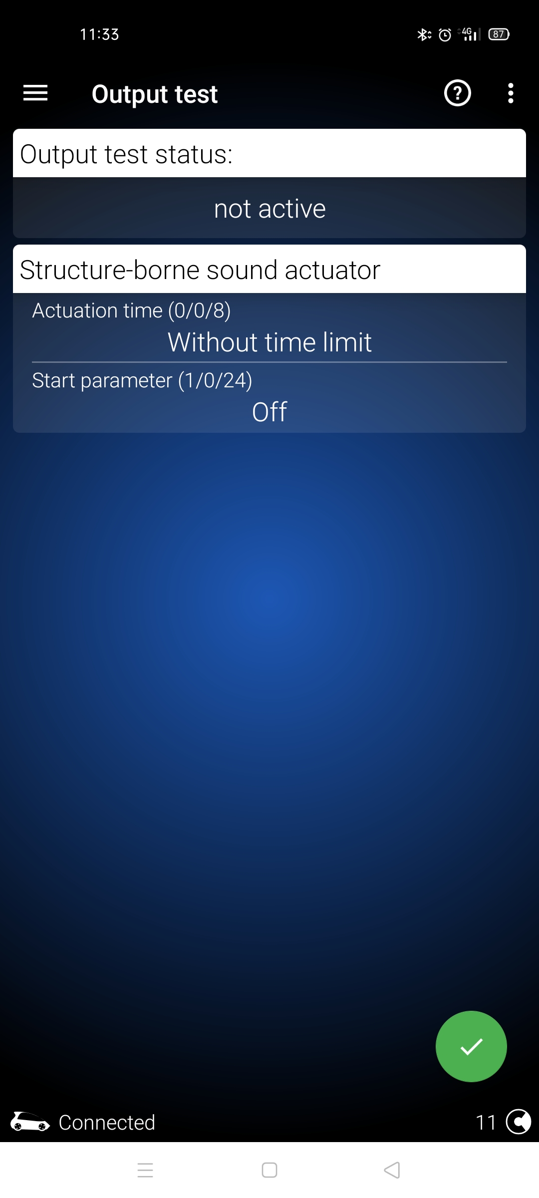

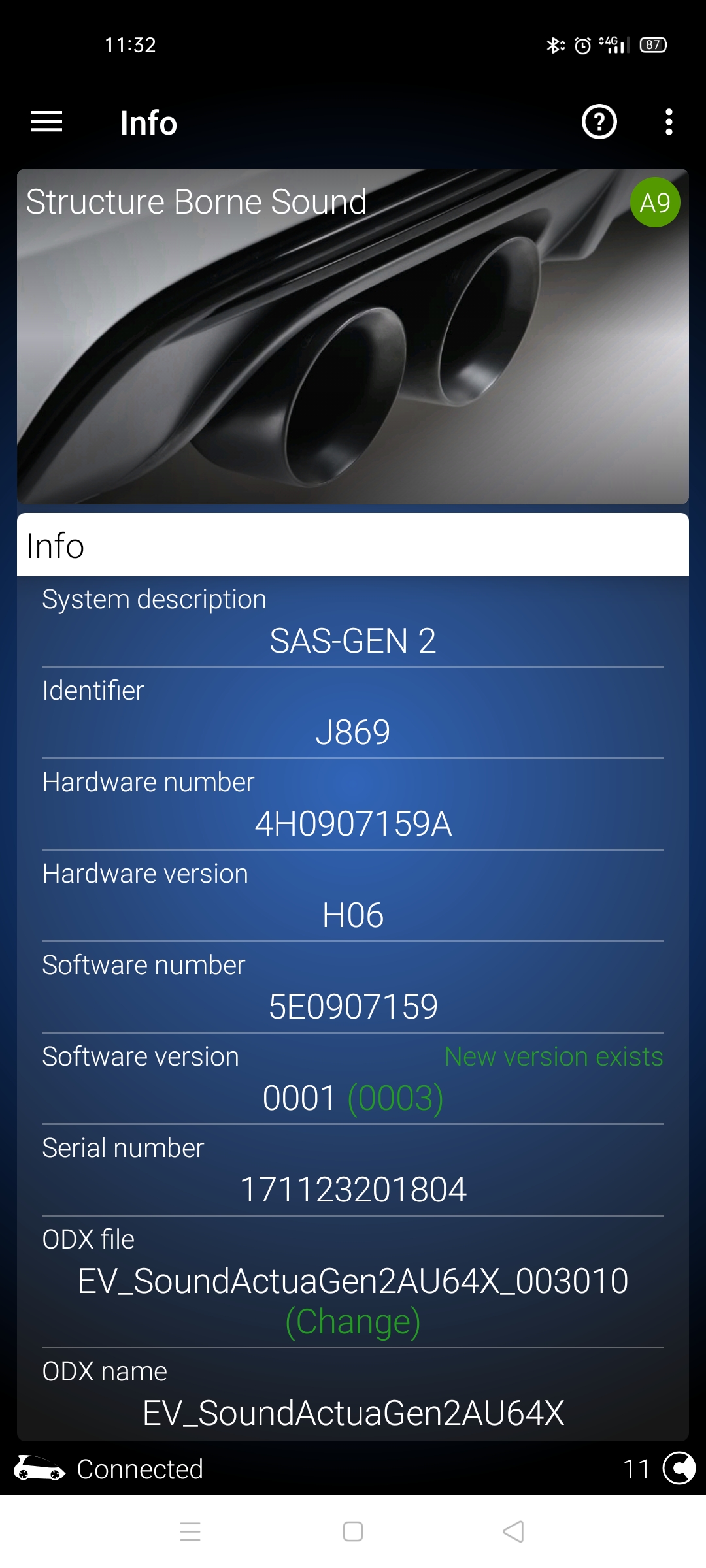

  5. Hi all, My last post I said my vrs sound actuator wasn't working so followed some advice and bought an odbeleven, checked the system and got the screens below, I also removed the cover near the wipers and found the unit is plugged in OK, The problem is no matter what I do I don't get any engine sounds? Any advice on what could be my next step as it says its working fine on the odbeleven, I did read somewhere about the voltage can be changed to 12v to stop it working but have no idea if that is it or where to find the setting, Any help appreciated
  6. Cheers mate, I would have just assumed it would have found it as a fault/ ie not plugged in????

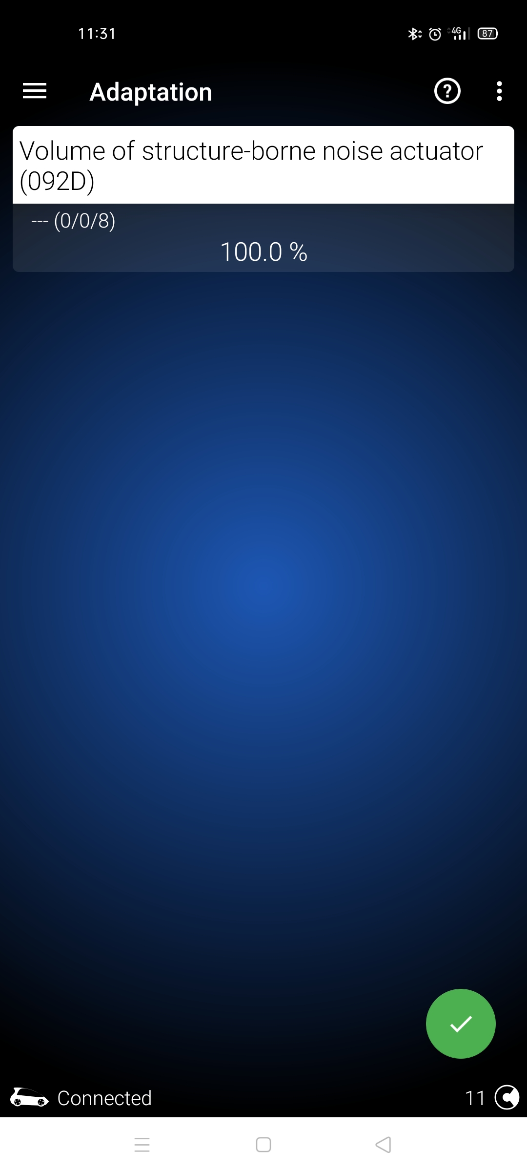

  7. Can anyone advise, so I got an odbeleven, found the setting, and it says its already at 100%, shows no faults, does this mean someone unplugged it even though it shows these screens? As it's still not working Thanks in advance
