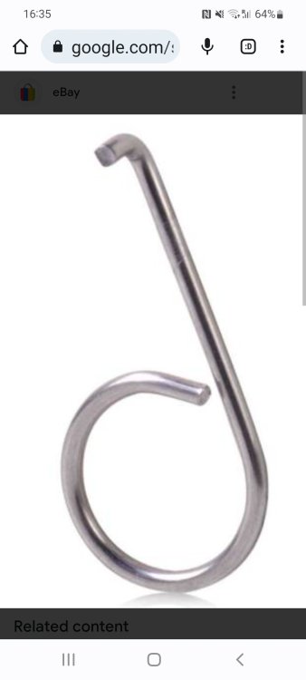

  9. Turns out this is it Could only see the right angle bit sitting in the polystyrene! 2022 VRS

  11. Can anyone send a pic of their removal tool and location for the plastic wheel nut covers VRS 2.0 TSI Octavia Estate Can't find mine . New car.
