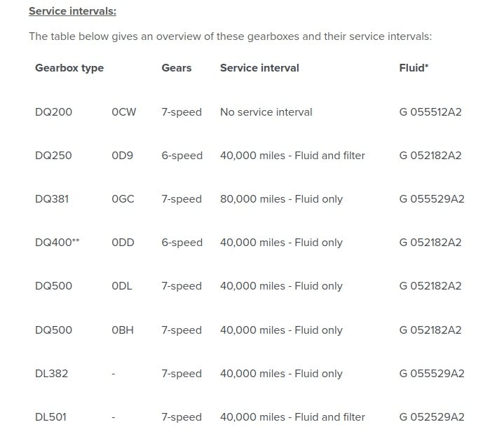

DQ381 7 speed DSG has a 80,000 mile service interval.
I would not leave them that long.

So I have the DQ200 Dry box on my VRS, no service intervals.
@Tellster
You don have a DQ200 DSG with no service intervals.
Because no 2.0 TSI or TDI has these, and even a 1.4 TSI PHEV does not.
No. It'll be a DQ380 or DQ381. More likely the former

I owned a 20023  TDI (110KW) with 7 speed DSG. The code for the transmission is  "0IJ"  "Installation differentiation for transmission DQ381"
