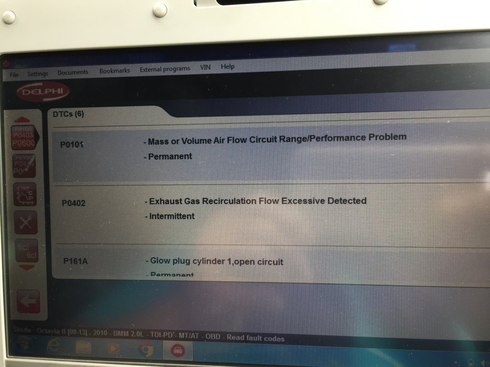

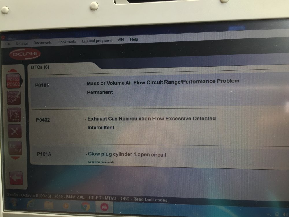

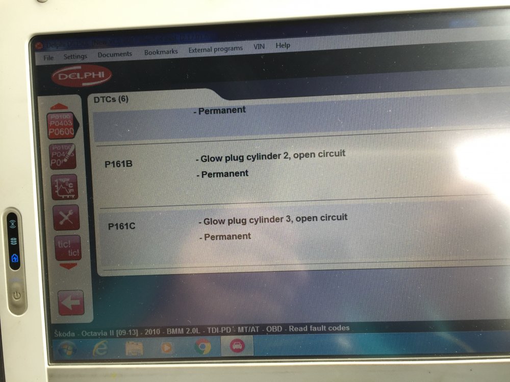

When I read codes on Vcds it store air flow mass signal implausible intermittent,Glow plug 1,2,3,4 open circuit, egr excessive flow. If I clear these out and drive again same faults come back in. I cleared fault codes and disconnected maf sensor, its way better with more power and less stuttering.Finally I took a torsion value for the timing it was -2.5 on tickover. The car to my knowledge has had new egr valve fitted at Skoda less than 200 miles ago, new non genuine airflow sensor , injectors he said they used the best one from both engines. So I would like to diagnose it correctly rather than keep throwing parts at it any suggestions for checking in right order ?

ill try to upload images of the Vcds screen shots if I can work out how to do it
