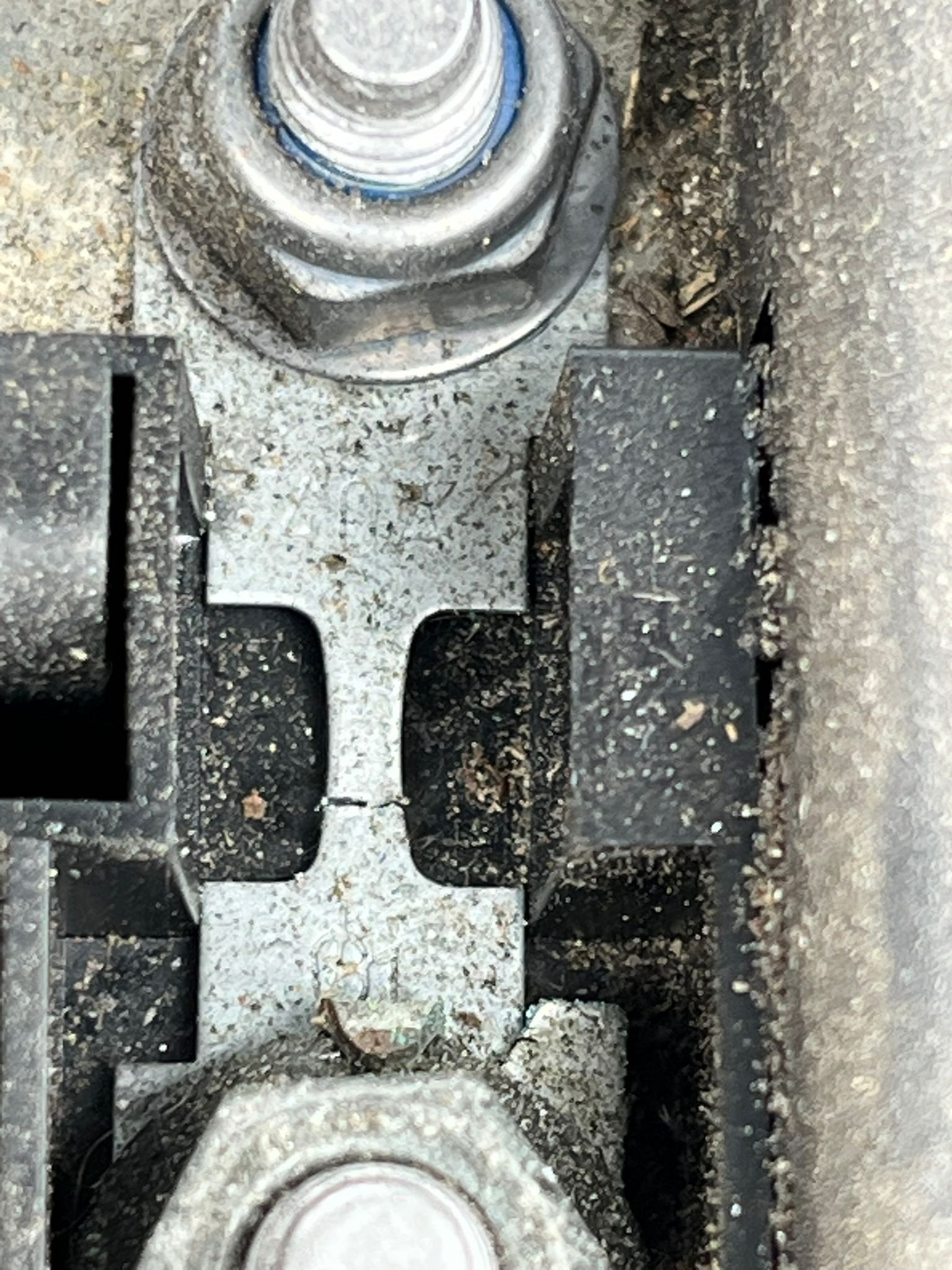

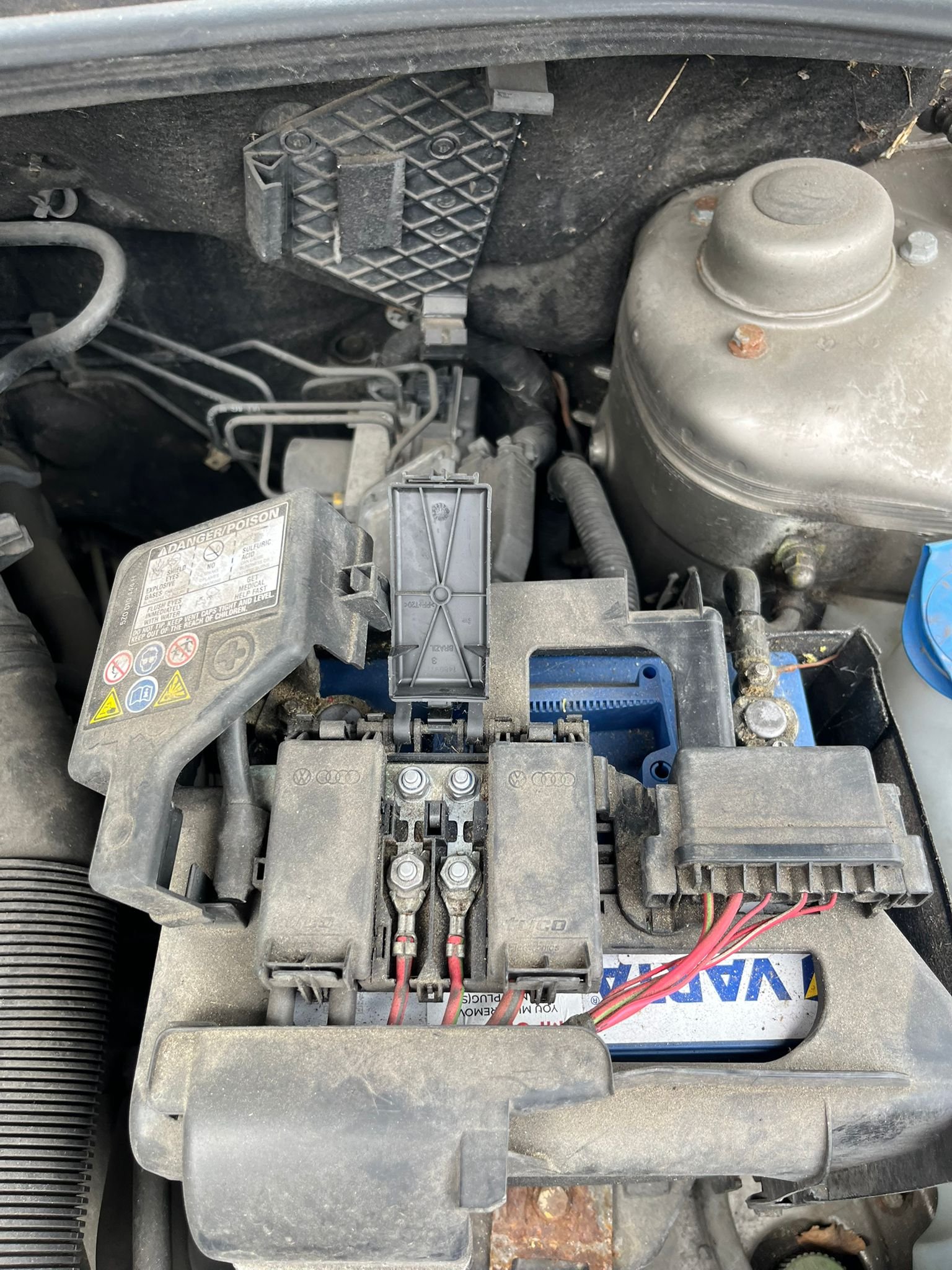

  1. Just typed the error codes into google. Found this video and hey presto it was the fuse after all. https://youtu.be/59sFUSS3VLw?si=k5ADuD4rfsid8ylJ Thanks Pete for suggesting that from the beginning - turns out I was looking at the wrong bank of fuses. Doh!

  6. So I was very impressed to see the exact fuse slightly proud (~3mm) of the others when I looked on top of the battery. I pushed it back in but the error still remains. So my question now is if I pull out this fuse and the others to inspect or check will it create other errors in the process?

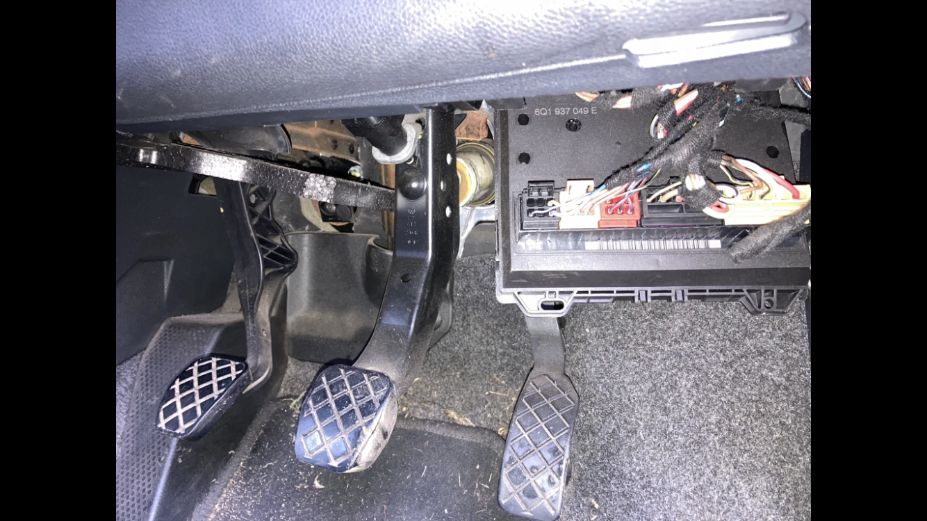

  10. I thought I would use my bank holiday to have another go at fixing my control module issue. The module seems to be in the correct position but it wont clip in. See video here.. https://youtu.be/IE5NAaIqxoE?feature=shared Has anyone got a Roomster or a mk2 Fabia and can share a photo or video to show how this module is oriented and the positioning of the cabling?
  11. Seems like I didn’t clip it in properly as the mechanic recently noticed it was still loose. https://imgur.com/a/DU5xYxT from this video (see link), is the control module the correct orientation? If so I will try again to clip it in to place.

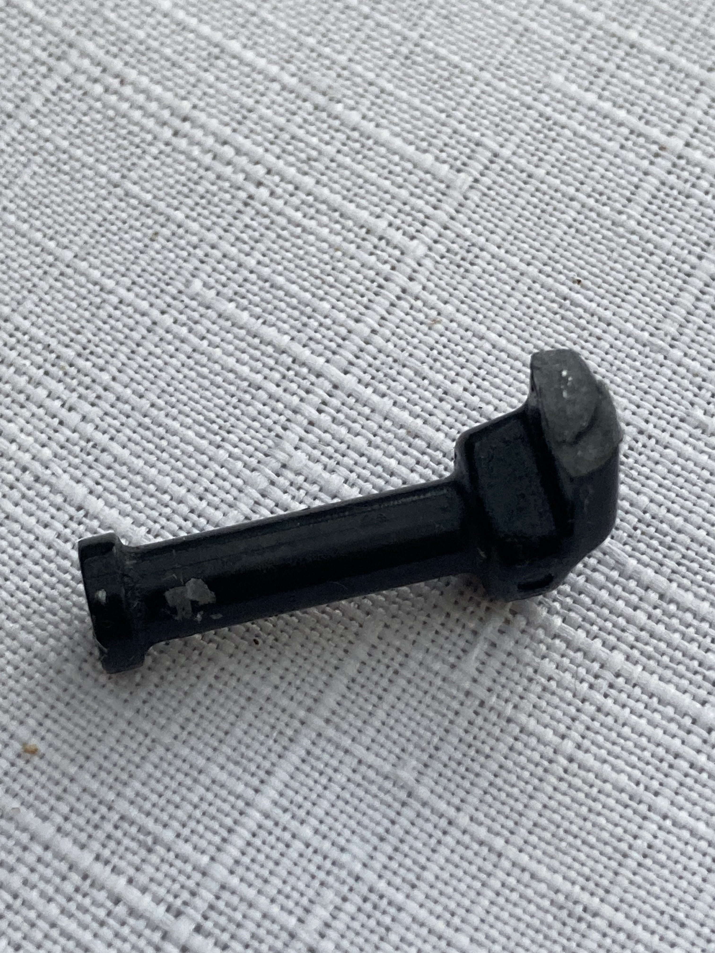

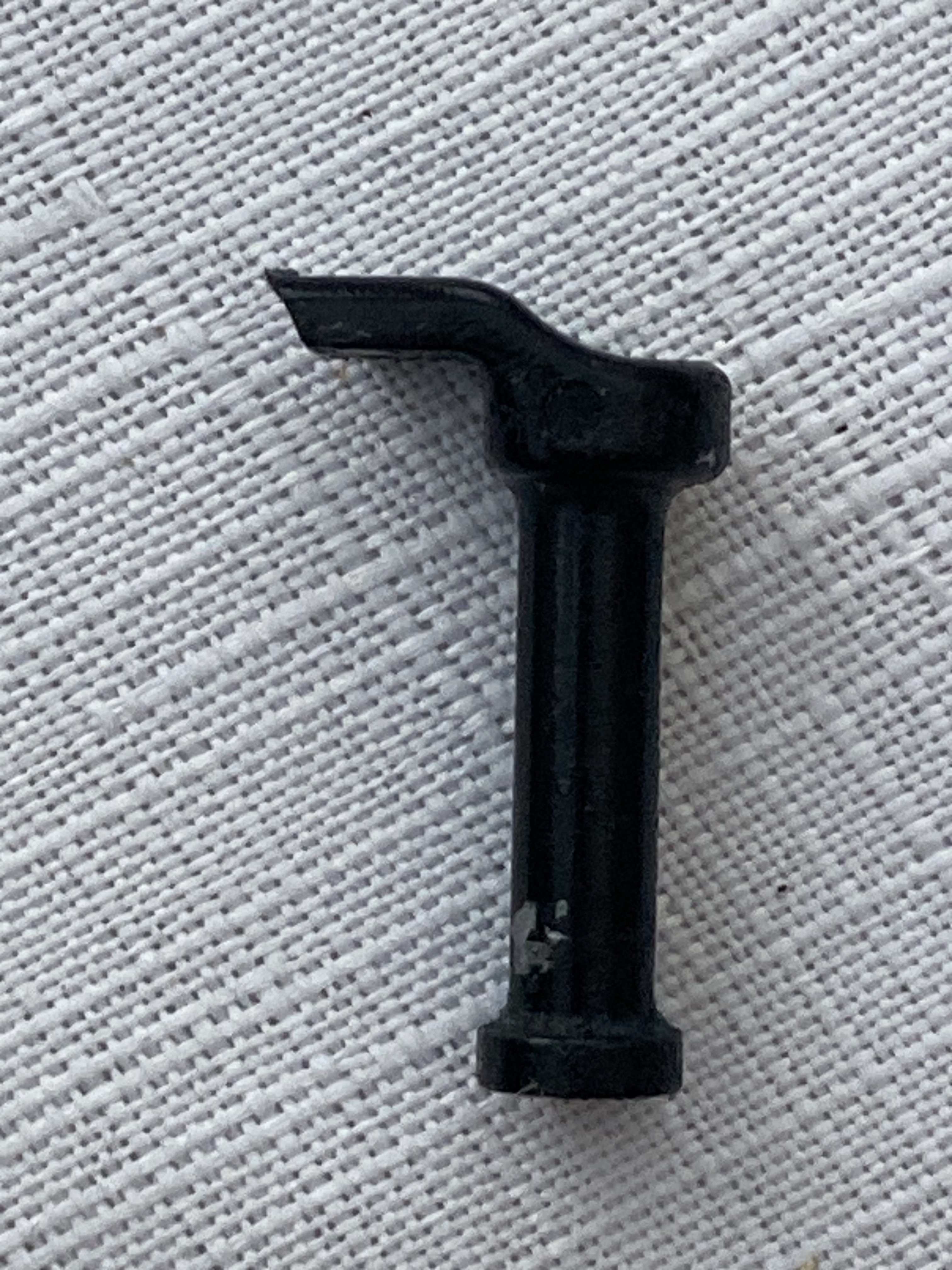

  12. Our beloved Roomster just failed its MOT because the seat belt doesn't retract properly. I can see that the part is on ebay for £38 and I am tempted to have a go at fitting it myself at the weekend. Does anyone know how difficult it is to replace that part? I am assuming I will have to disassemble the inner panels in the boot but have never taken them off before.
  13. I wish I had read this post more carefully. Sliding the seat forwards is the key as it revealed the catches which I opened very easily with a screw driver.
  14. I have the same exact problem. I found a piece of broken metal in the boot and the seat won’t release. See photo I have been wrestling with a screwdriver and spanner to release the latch or undo the nut. Neither approach is working unfortunately
  15. A while back, a garage did some electrical diagnostic work and when I went to collect the car it hadn't been put back together properly. The garage had amazing google reviews but the work was very poor. Lesson learned. Door trim was half off and the control module was not properly fitted. See photo attached. I've had a look on youtube for something that covers fitting this, but have had no luck. Also I'm not sure which screws I are missing.
