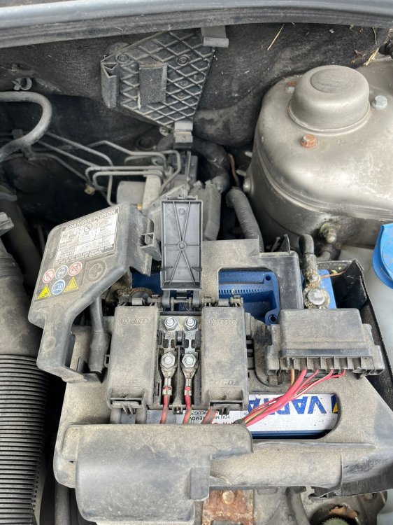

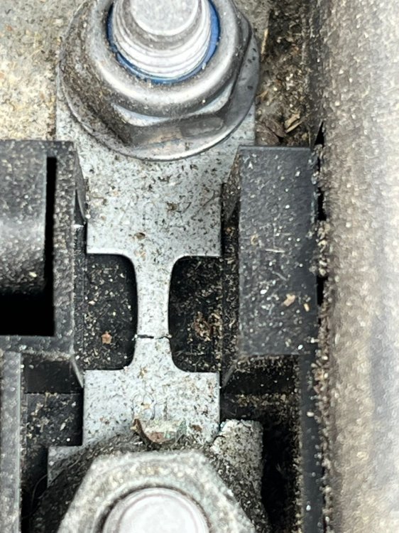

Check some fuses (on battery-top fuseholder) before you go a step further.
Strip fuse No.4 would be my favourite for having a crack in the middle of it, that might barely be visible until unbolted.
Blade fuses 7 and 10 should also be checked

So I was very impressed to see the exact fuse slightly proud (~3mm) of the others when I looked on top of the battery. I pushed it back in but the error still remains.
So my question now is if I pull out this fuse and the others to inspect or check will it create other errors in the process?
