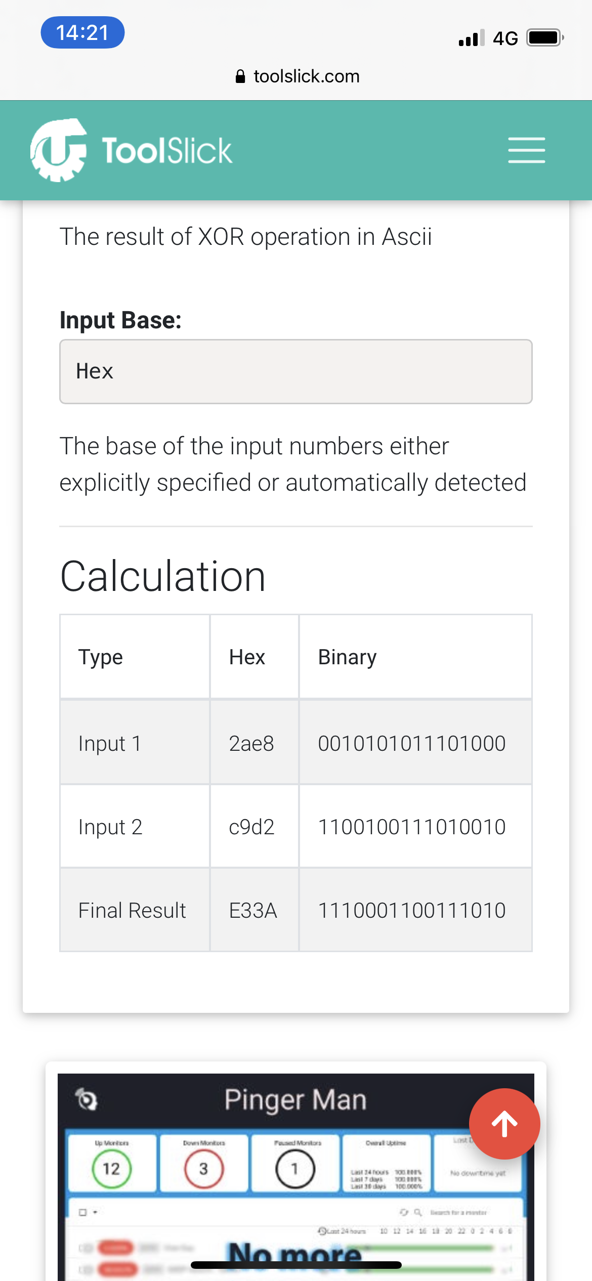

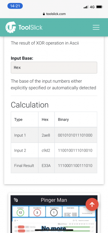

Has anyone done this and found that when you swipe the green bar to code the ‘Writing’ circular loading screen hangs on OBD11? I’ve tried it twice now, first for around 5/10 mins engine off. Then had to disconnect, started the engine second time and now currently sat waiting with it. Pretty sure it should be a quick few second coding like always? here is my updated code, am I doing something wrong?
