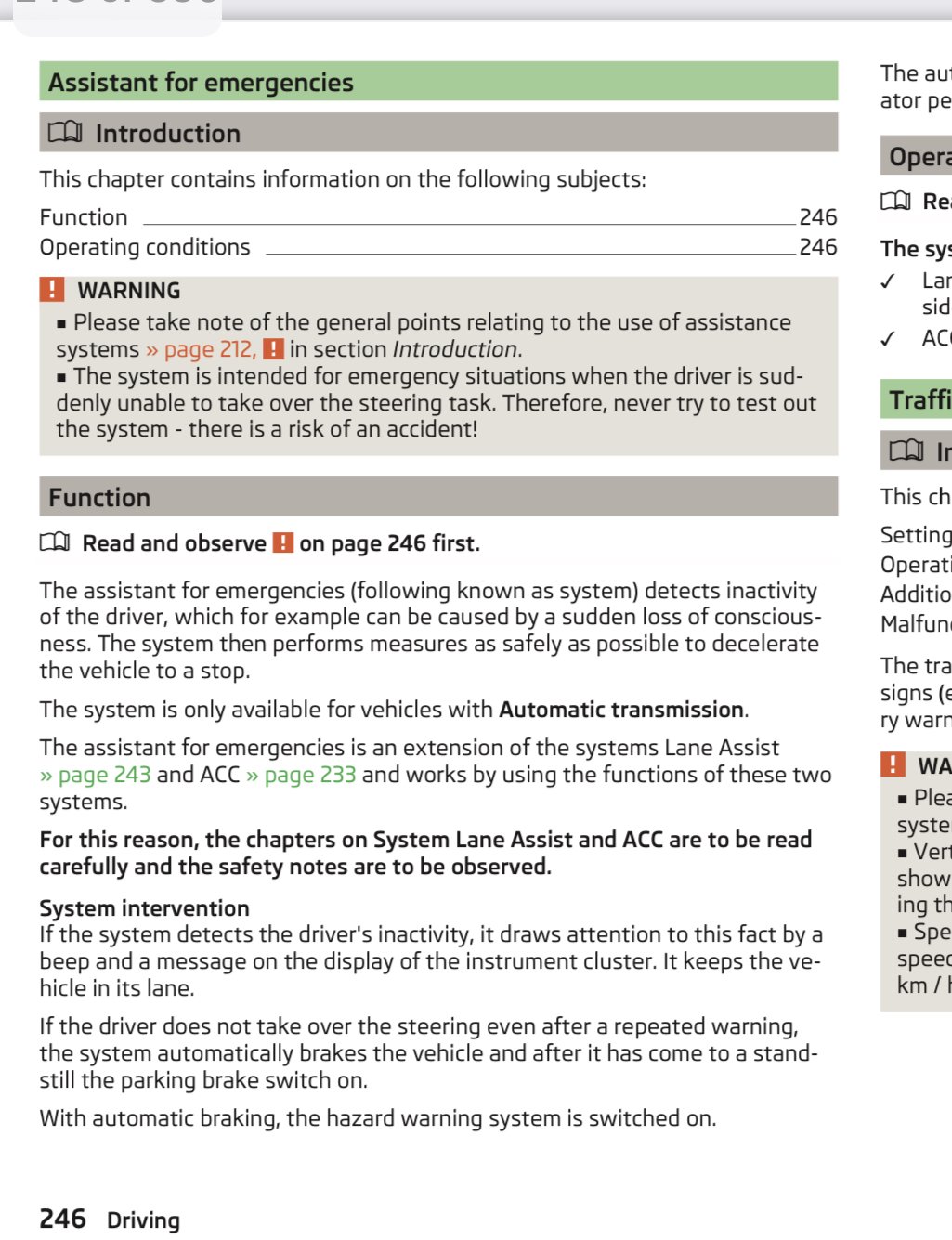

  10. Is you car an automatic? ā€œAssistant for emergenciesā€ (as it’s called in the manual) is only available on Automatic cars:

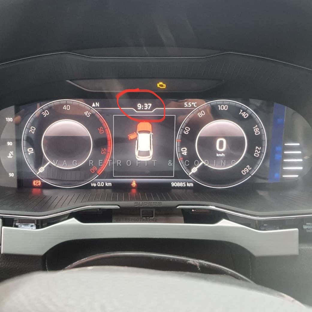

  13. I don’t have VC myself, so I can’t comment from personal experience, but I saw a post on Facebook today from a page that does remote coding for VAG cars. They had facilitated a VC retrofit on a 2017 Superb. Some of the photos shows a clock in the top centre. However, others has the traffic sign recognition display here, so maybe it’s an either/or thing.
