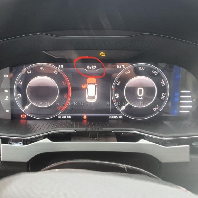

  13. I don’t have VC myself, so I can’t comment from personal experience, but I saw a post on Facebook today from a page that does remote coding for VAG cars. They had facilitated a VC retrofit on a 2017 Superb. Some of the photos shows a clock in the top centre. However, others has the traffic sign recognition display here, so maybe it’s an either/or thing.

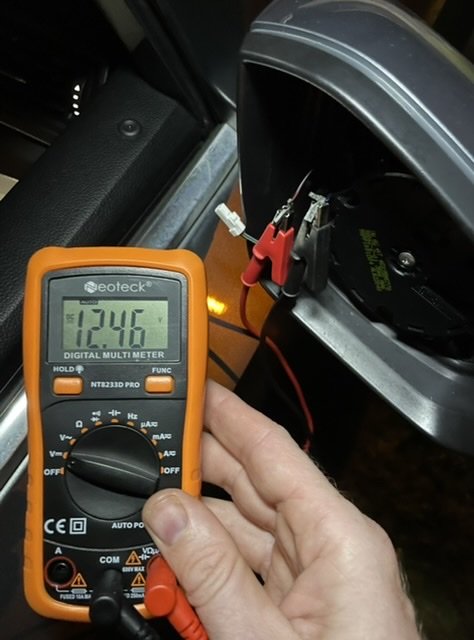

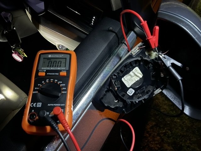

  19. Makes sense @J.R., thanks. measured it there, and it’s 0v regardless of whether heating it turned off or on. So there’s the problem. As suggested above, it could be related to the seat module that doesn’t work. I still haven’t got around to getting that fixed. I think I’ll look into getting that done and see how I get on.
  20. I was a bit slow getting back to this, but finally did some more investigation tonight. Took out the mirror glass and hooked it up to a 12v supply inside the house. Mirror started heating instantly. So I know the element is good. Then I went out to the car with the multimeter and clipped it onto the heating wires. Turned on the ignition, and got a reading of 12.46 volts. This was with the mirror switch in the 0 position. Switching it to the heat position didn’t change the voltage. I then put the mirror back and turned on the ignition. The mirror didn’t heat up. Can anyone explain to me: 1. Why I’m getting 12v with the heating turned off? and 2. Why the mirror isn’t heating if it’s getting 12v? Clearly I’m not understanding something fundamental here.

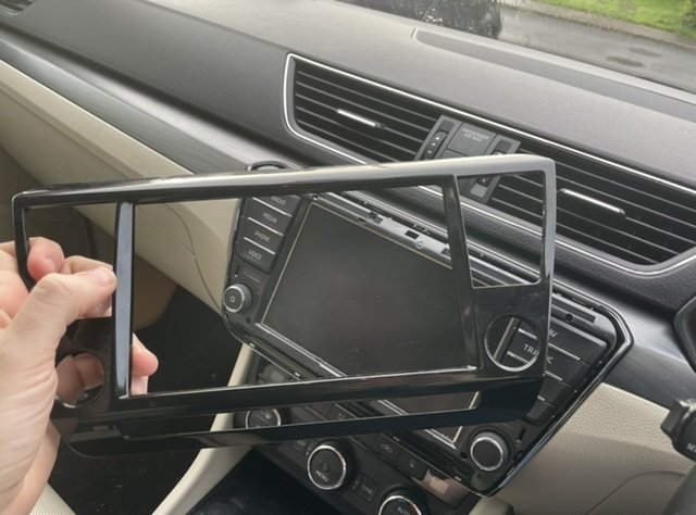

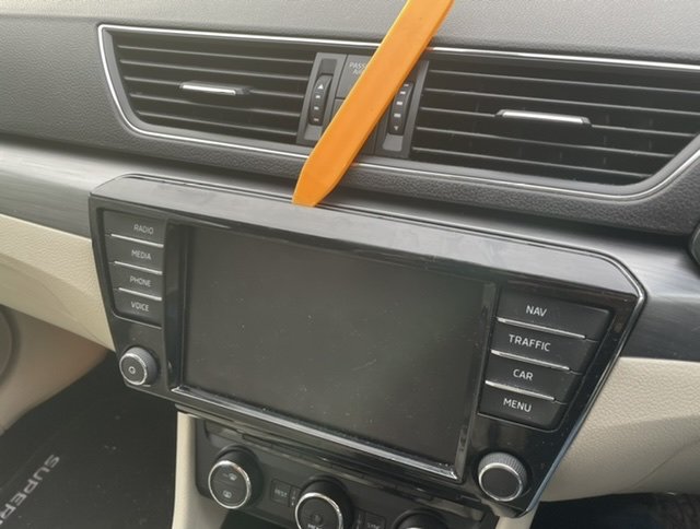

  23. Get a prying tool in the gap at the top, and pull out. It’ll snap off
