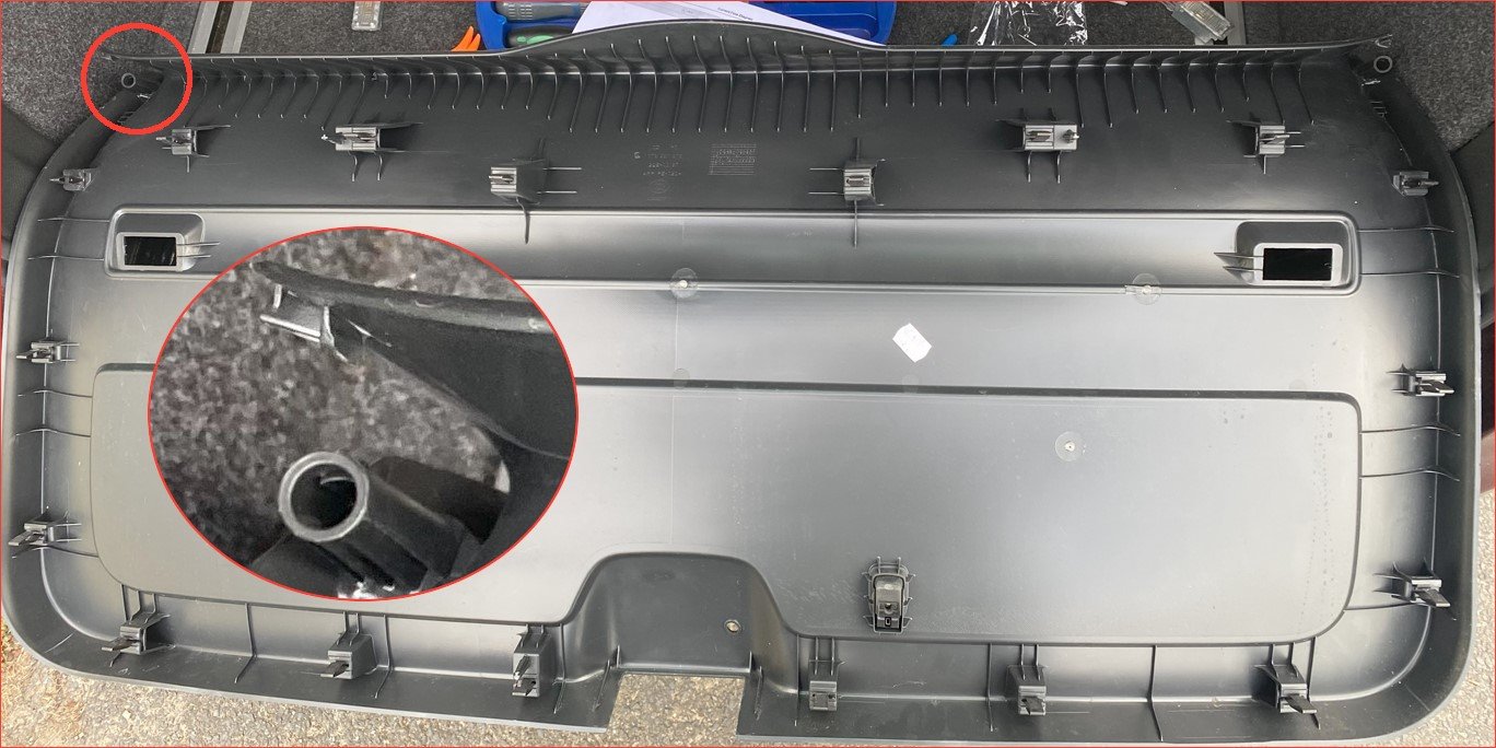

  3. By the time I read the steps in Diggiboy's post the exploded diagram under davidj241's profile (from 2012) had disappeared so I thought I would add an image of the tailgate trim and add further steps to assist removal. I needed to replace the tailgate lock (damp had corroded and caused one of the microswitch contacts to snap resulting in no boot lights; torch not lighting up; no open boot indicator on MaxiDot; and alarm triggering when opening just the boot). Also had an intermittent rear wiper motor that needed replacing. Boot light issue https://www.briskoda.net/forums/topic/454434-boot-light-estate/ Rear wiper replacing https://www.briskoda.net/forums/topic/361350-rear-wiper-motor-removal-how-to/ Removing tailgate trim on Skoda Superb Mk2 LK Estate The tailgate is fixed by one screw in the centre of the rubber pull strap. That's it - after that it's all held by clips and you will need strong plastic trim tools to leverage the trim off. As I was unable to prise the trim off from the area around the wiper I too started at the lock end. And brute force finally got the trim off the wiper end. It was then that I noticed that the wiper end of the trim had lips on the corners of the folded back part that tucked into the plastic guides on the tailgate - left and right by the boot strops. This part of the trim should really have been prised off first as they lock the top in position with a post that goes into the tube on the plastic guides (see phots below) Thanks for the tip about aligning the clips to the butt end of their relevant mounting slots and the definite necessity of having an assistant with the use of a torch to check all clip locations were aligned to the slots - the trim went back on without a hassle.

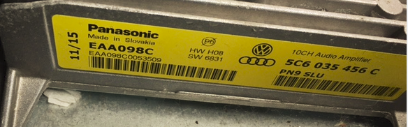

  5. Thanks Del8oy Regarding locking the doors - my new fully charged new battery was flat when I returned a couple of weeks after replacing the original Varta battery. And it had been locked all the time. So whatever in the amplifier circuit is causing the drain did not go to sleep when the doors were locked. Just to be sure I charged the battery again and measured it over a four day period while it was parked up and the voltage steadily dropped by the end of each day. When it reached 12.0v I decided to diagnose (as well as having the battery checked by a garage with a Bosch BAT131 tester). Finally I had the car diagnosed by the Skoda dealer and they confirmed it was the amplifier circuit causing the issue. I did consider disconnecting the TV tuner but because the current drain stopped when the F18 fuse was removed and the TV worked on the Columbus headend with the fuse out I presumed it was not the TV tuner circuit causing the issue, In your case did pulling the F18 fuse stop the current drain?

  7. So it is - many thanks. Noted that it is a Panasonic and not a Harmon system which I thought it was . Thanks also for the clue about the sleep timer. In fact the current drain doesn't stop after even three hours. So rather than the amp (a rather expensive component at @ $200 on the open market) maybe something else controls the sleep interval and is duff? Capacitor? I can't imagine it is the Columbus head end because that runs fine without the fuse in place. So I wonder if there is a way to simulate the sleep period as a check rather than knocking the whole circuit out with pulling the fuse?? Cheers!
