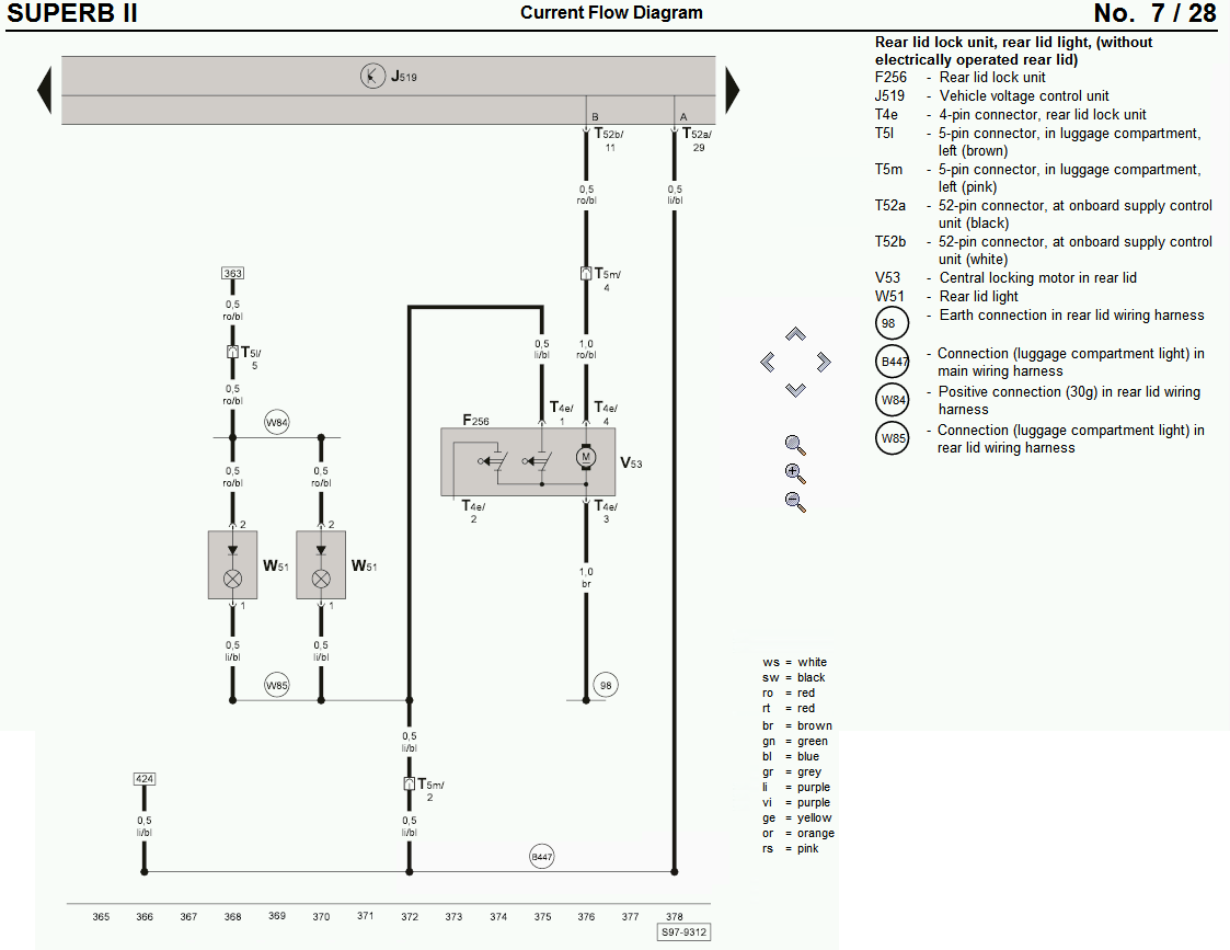

Here you go:

any similarities?

If you have a continuity tester, you can check the operation of the switch before committing money to a replacement latch. Unplug the connector and check for continuity between different pins: use the diagram wokwon posted earlier in the thread to guide you.
If the switch checks out ok, I'd move on to checking the wiring from the tailgate to the body: if that's cracked it would certainly get in the way of things working as they should.

Have the same issue with my boot lights - no downlights nor torch and Maxidot dash display not registering boot up. Car locks within minutes and alarm activates. Have followed continuity steps here using Wokwon current flow diagram and get earth rail at PIN 1 of Rear lid light (W51) but no positive at PIN 2. Indicates to me that boot lock micro switch is working otherwise there would be no earth continuity so something going on further up the chain wherever connector T5v terminates. Can anyone post the page of the wiring diagram that Track 363 points to? Would like to find out which control unit T5 plugs into and its location. Hopefully that page has a diagram showing torch light connections which are also missing off the above schematic. And would anyone know if there is a sense wire that triggers the boot open Maxidot or is that triggered off the same circuit once it's active ?
