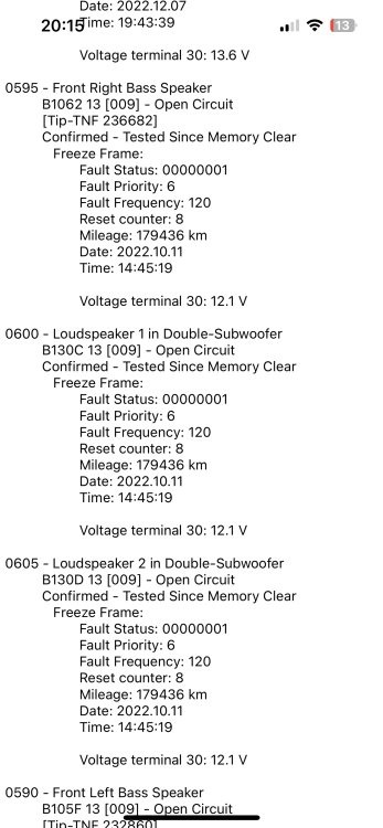

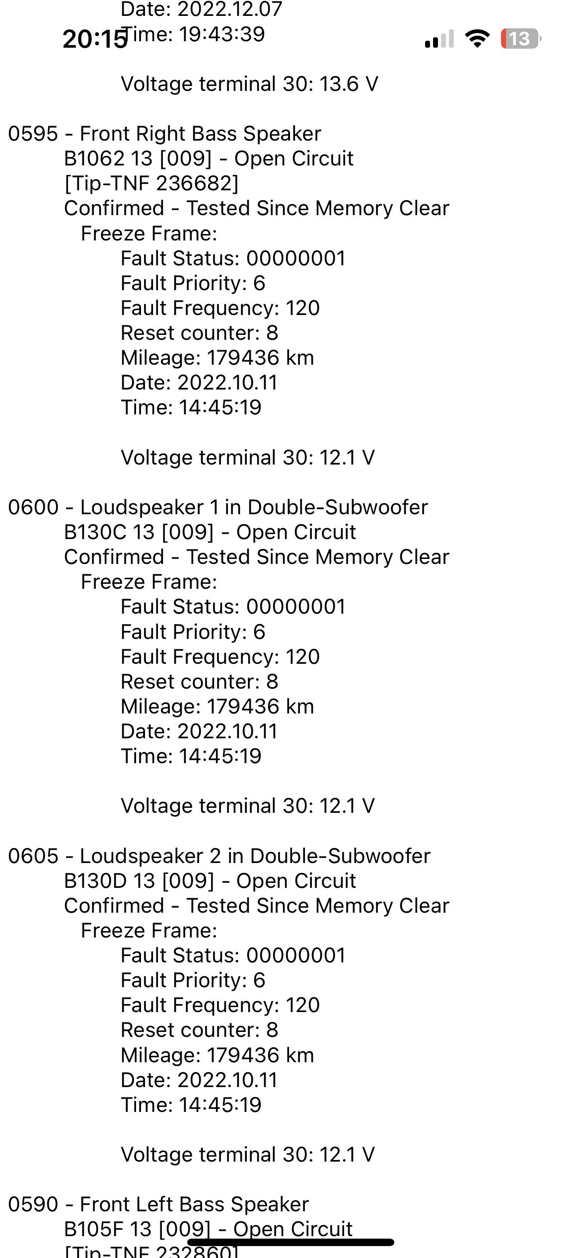

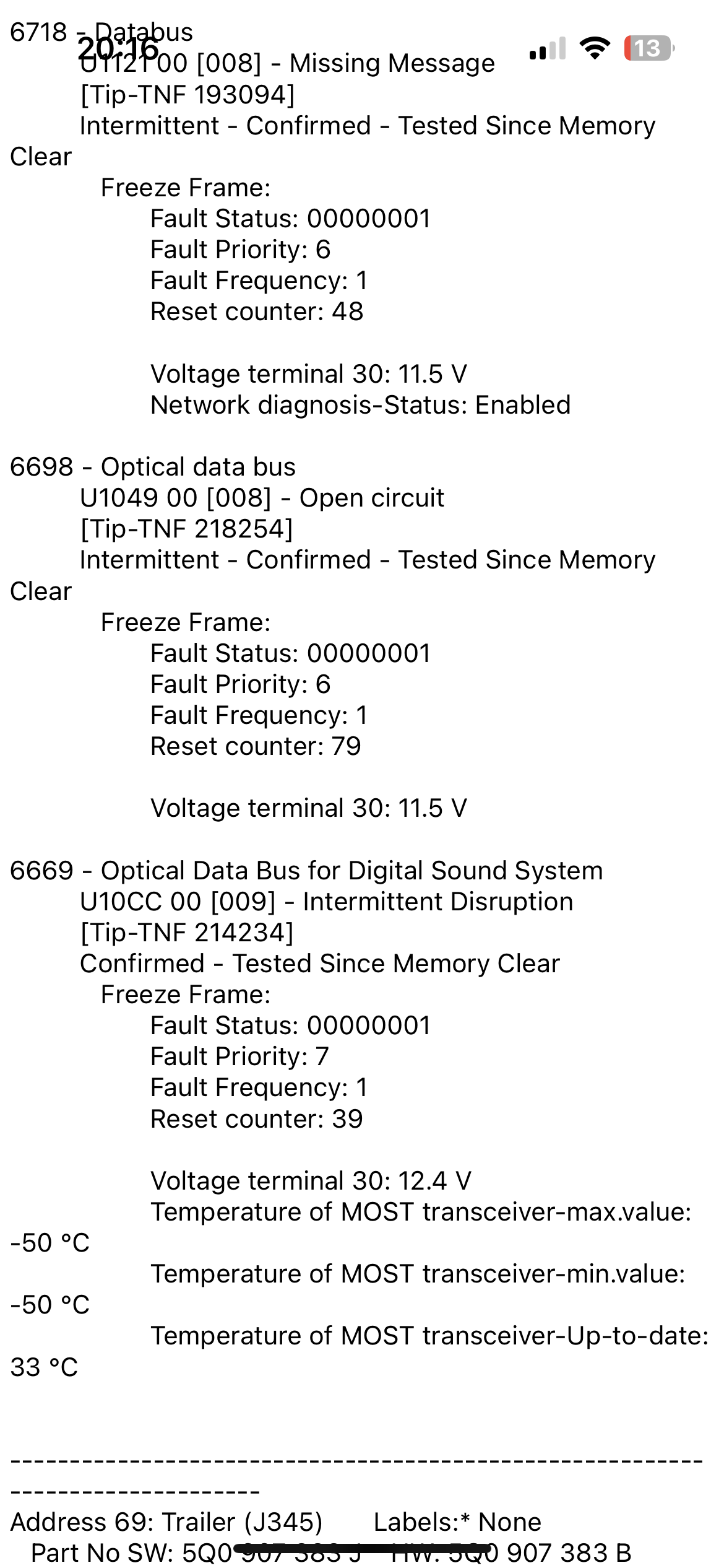

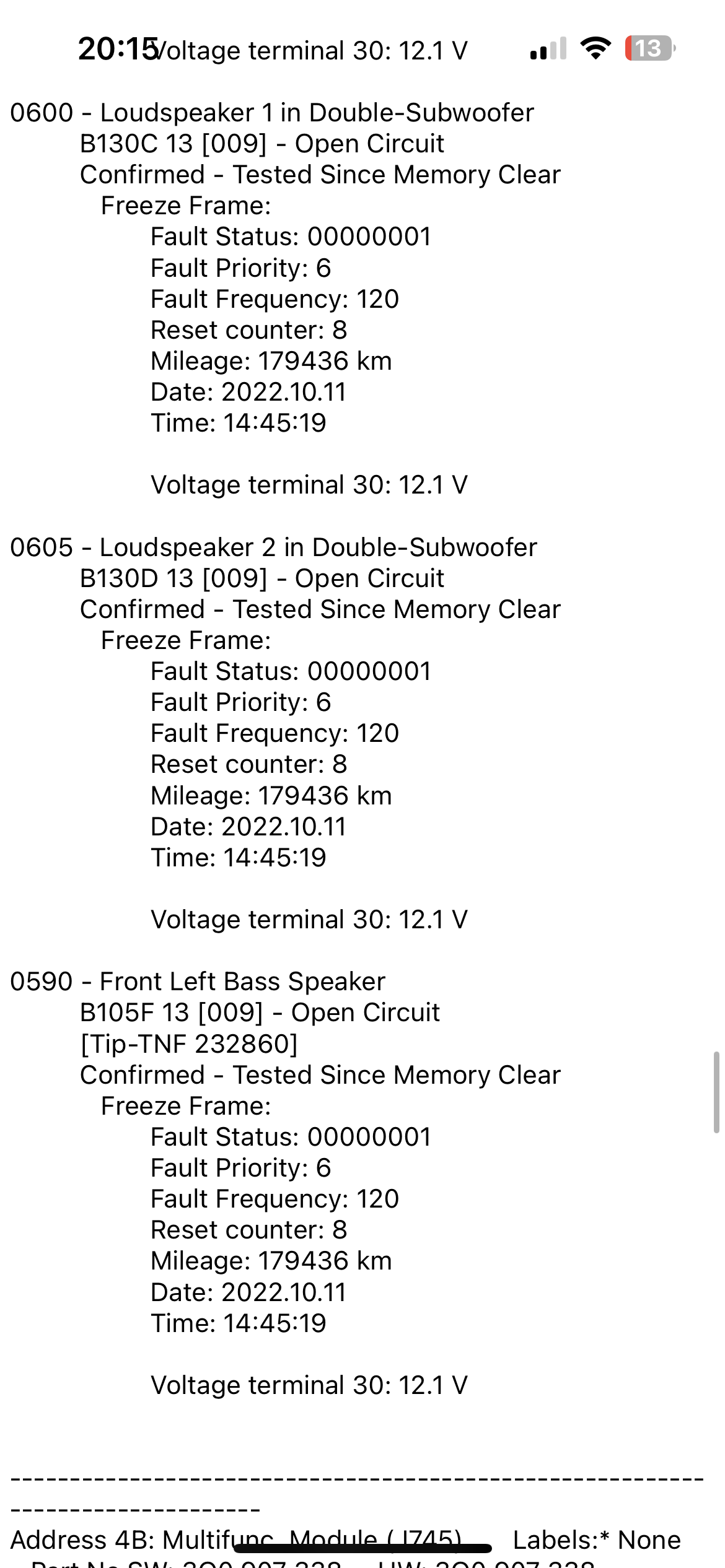

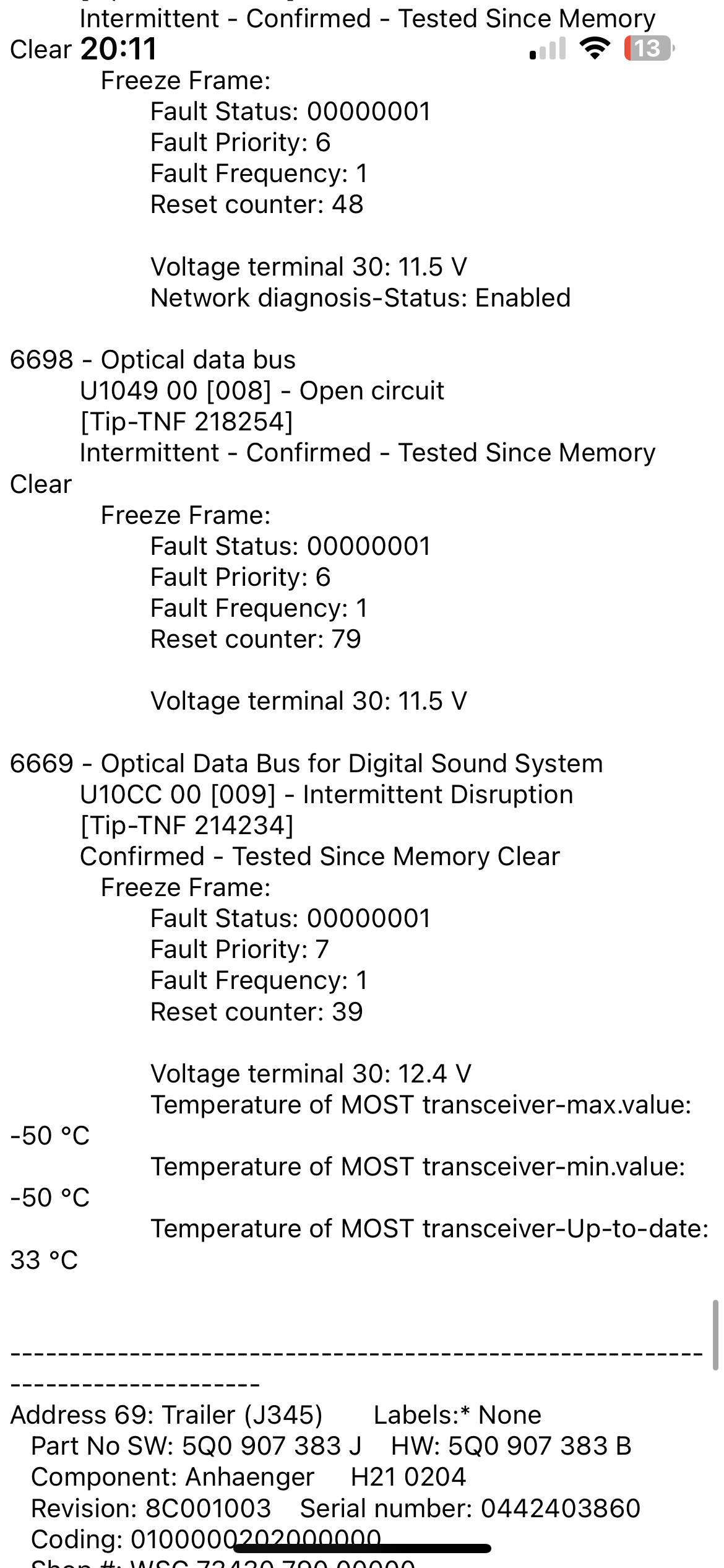

Hi all, This is ongoing for the last year and I gave up. The sound system canton has stopped working. The centre dash speaker works, front tweeters (no mids), rear tweeters (no mids) and no subwoofer either. Now I'm wondering to fork our for a new amp? It's not cheap. £550. The MOS cable from amp to the multimedia in glovebox has been changed. No luck. Wiring all fine. I can only think of an amp issue. When you change Canton Optimisation quickly from "All" to "Driver or front" the bass kicks in for a millisecond and that's it. I'm pointing to a new amp. Any advice will he greatly appreciated. Tia Regards
Canton Sound System help
Hi all, hope you’re well. As I’ve probably previously posted regarding my canton system not working, one day the sub went off, then the door speakers and now only the rear door speakers work and front tweeters. Scanned it on ODIS/VCDS and the external amp was switched off but when we try to click to turn it off it turns off but the music works on “none” option. Below I’ll post the codes I’m getting. TIA.
