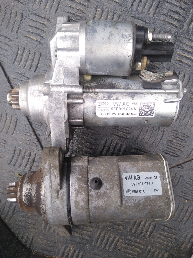

  1. As promised now that the frosts have started to bite, I'm pleased to confirm with a necropost that my issues with cold/damp starting were indeed fixed by fitting a new starter motor. Dan.

  5. It's taken me a long time to get around to sorting this, but I managed to swap out my starter motor this Sunday while the weather was dry and so far so good. I've probably lost the opportunity to test things under sub zero conditions, but since fitting there has been a noticeable difference between the two units. The new starter spins a lot faster and the engine fires up without any hesitation - something it hasn't done in recent years, even in warm weather. I will report back when the frosts start to bite again. Dan.

  7. Yes, previously had that connection off, although there's no guarantee I did a good enough job cleaning it up as I was in a bit of a rush. I'll report back if the new unit makes a difference.
  8. It would be hard for me to say, but it's certainly not been swapped in the 5 years I've had it. I think this second hand unit is possibly worth a go.
  9. @Breezy_Pete It's a cold start phenomenon - the starter has never been that willing, but during the last couple of years during winter cold snaps I've experienced slow to medium speed cranking where it will start turning but then sounds like it suddenly "jams up". I've ruled out the battery and due to otherwise acceptable performance when the weather is above 5 degrees, I don't think it's the ignition switch or the solenoid wire. I know it could be an earthing fault, but I've checked all cables and cleaned up connections where possible, although haven't got as far as testing things with a multi meter. My gut says it's potentially the solenoid sticking, so I was going to take a chance on a second hand unit with a guarantee or possibly a re-manufactured one. @varooom it's useful to know this part was superseded by later versions.

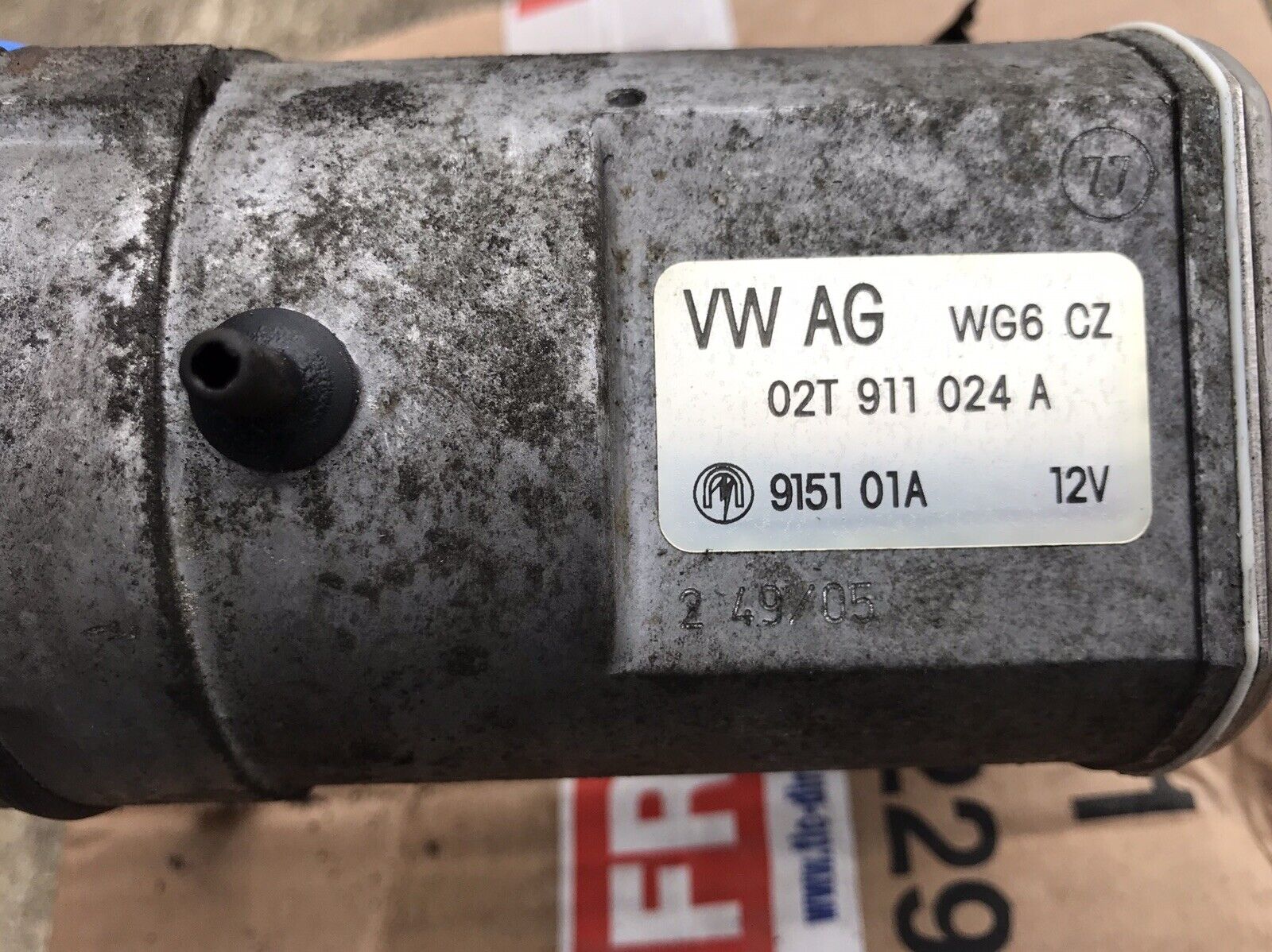

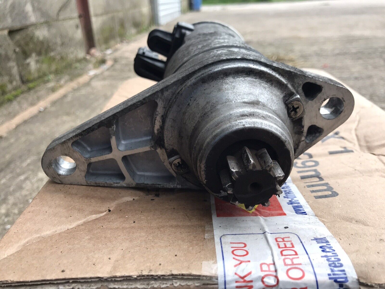

  10. A couple more images from the starter as fitted to my engine. @Breezy_Pete I've checked your suggested part number, but notice that on some variants the solenoid plug seems to be a square type rather than the "D" shape fitted to my unit. I've also seen this on a couple of other starters from the Fabia range which share part numbers, so I'm still not entirely sure but think that other than the plug type and being rated at either 0.9kw or 1.1kw, it hopefully won't make too much difference. I haven't seen any re-manufactured units that have the solenoid integral to the starter body, so assume I'm safe to go with the more traditional design. Dan.
  11. Hi, I'm planning to change my starter motor, but was surprised to find the part currently fitted to my Fabia has no obvious solenoid? I think the part currently fitted is 02T911024A, or so some photos from the internet lead me to believe. I'm guessing the solenoid is internal to the starter motor housing on these models? Would I be safe to fit one of the models with the external solenoid - it's how it's shown in the 7Zap parts catalogue? Any advice gratefully received. Dan.
